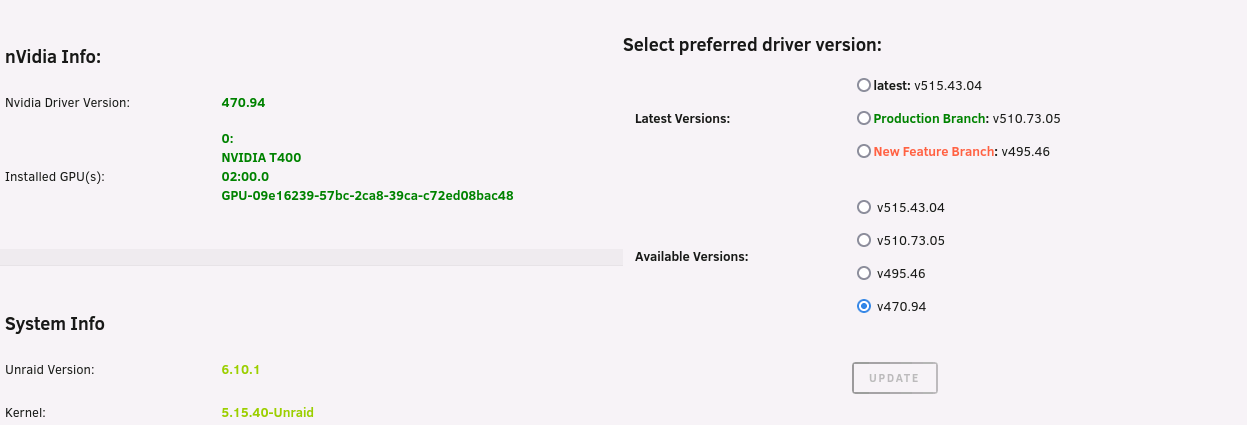

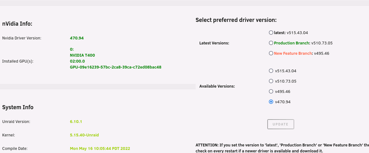

1 hour ago, tjb_altf4 said:
Upgraded to 6.10.1 and had a problem with gpu again, went into plugin settings and it has reverted to latest driver again.
Seems it is not honoring driver preference settings between upgrades?
I will look into this ASAP and test this.
Already rebooted again with the setting changed, this is what it looks like now, and this is what I had set in plugin prior to OS update
I've tested it now, a little different and also the Plugin Update Helper was fixed too before I've done that:
  1. Downgraded to 6.9.2
  2. Changed the driver version to 470.96 in the config file
  3. Triggered the update to 6.10.1
    In this case the Plugin Update Helper downloaded 470.94 for 6.10.1
  4. After the reboot to 6.10.1
    The right version is installed
The plugin (and also the Plugin Update Helper) should always honor the preferred driver version, I will do some more tests next week and report back.
The driver only falls back to latest if it can't find the selected driver version, maybe the network was a little to late initialized on your machine, but that's only a really vague guess.
Anyways, this shouldn't happen anymore because the plugin update is fixed now, but as said above you maybe have to reboot once more so that the new version is installed.
Sorry for the inconvenience...

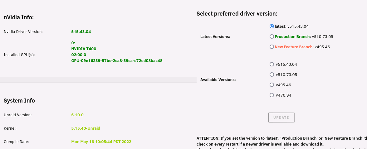

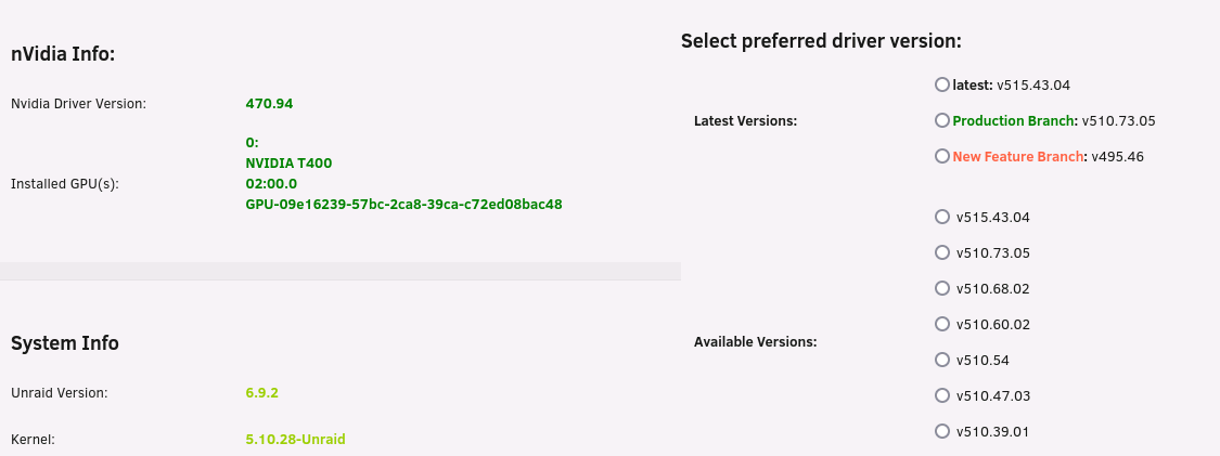

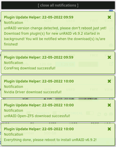

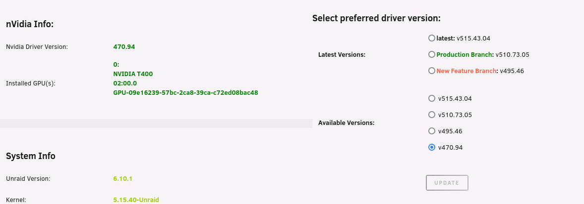

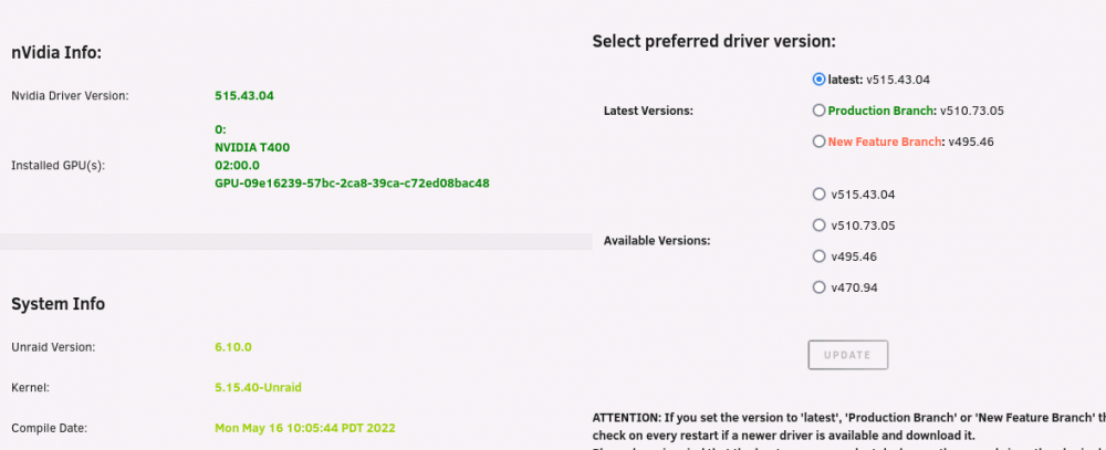

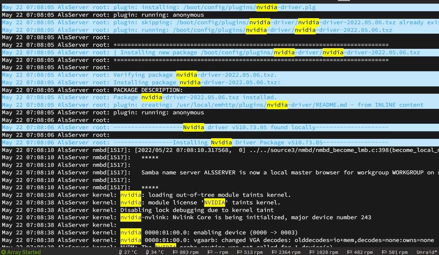

Did a bit more testing:
Downgrading from 6.10.1 -> 6.9.2 (picture from before the upgrade):
Upgarde from 6.9.2 -> 6.10.0 (picture from before the upgrade):
The Plugin Update Helper fails on 6.10.0 because the Kernel version string is formatted wrong in this version but this is a good test because the plugin packages are not pre-downloaded like in your case and will be downloaded on boot.
Upgarde from 6.10.0 -> 6.10.1 (picture from before the upgrade):
You are completely correct that it falls back to latest.
But finally set the version again to 470.94 and upgraded to 6.10.1 (picture after the upgrade):
The reason why it resets the version back to latest is because the Plugin Update Helper fails but this shouldn't happen anymore in the upcoming version from Unraid because I've reported that the Kernel version string was formatted wrong to Tom and it should now be fixed.
Thank you for the report! I will take a look to make the Kernel version detection even more robust.

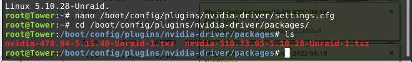

FYI not fixed in 6.10.2 (coming from 6.10.1), helper failed and I needed to set driver again, requiring an additional reboot post upgrade
(not a big issue for me, just wanted you to know in case it was meant to be fixed)
Edited by tjb_altf4
What message did the Kernel Helper gave you?
I didn't look too closely, but it looked like it failed in a similar way to previous times where it failed (red notification) them OK (green notification)
I think what happened is that you still had the old version installed, the Plugin Update Helper updates only when you reboot or you are installing a new plugin which needs modules for specific Kernel versions.
I've tested upgrading and downgrading between various versions from Unraid.
EDIT: If you are curious to test, you can downgrade to 6.10.1 and after a reboot again upgrade to 6.10.2 and it should work just fine.
