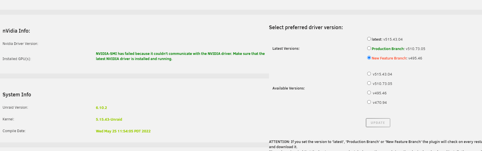

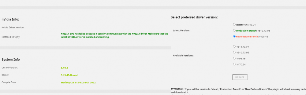

Using GTX960M on my Unraid-Laptop. Plugin cannot find my GPU-UID. Is my graphic card incompatible?
Can you post your Diagnostics please?

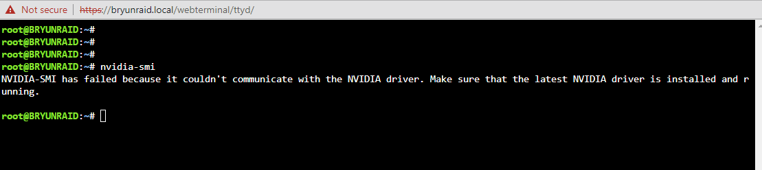

I have a nvidia
VGA compatible controller: NVIDIA Corporation GP108 [GeForce GT 1030] (rev a1)
I have tried it  the different drivers lastest v515.43.03  v470.94 and v495.46.   But I am getting the same results.
I have also confirmed looking at the nvidia website that this card is supported by these different drivers.
With a uninstall and reinstall of th nvidia plugin.  I am seeing this during the install.
May 30 14:45:31 UNRAID root: plugin: running: anonymous
May 30 14:45:31 UNRAID root: plugin: creating: /boot/config/plugins/nvidia-driver/nvidia-driver-2022.05.06.txz - downloading from URL https://github.com/ich777/unraid-nvidia-driver/raw/master/packages/nvidia-driver-2022.05.06.txz
May 30 14:45:42 UNRAID root: plugin: checking: /boot/config/plugins/nvidia-driver/nvidia-driver-2022.05.06.txz - MD5
May 30 14:45:42 UNRAID root: plugin: running: /boot/config/plugins/nvidia-driver/nvidia-driver-2022.05.06.txz
May 30 14:45:42 UNRAID root: plugin: creating: /usr/local/emhttp/plugins/nvidia-driver/README.md - from INLINE content
May 30 14:45:42 UNRAID root: plugin: running: anonymous
May 30 14:48:23 UNRAID kernel: nvidia: loading out-of-tree module taints kernel.
May 30 14:48:23 UNRAID kernel: nvidia: module license 'NVIDIA' taints kernel.
May 30 14:48:23 UNRAID kernel: Disabling lock debugging due to kernel taint
May 30 14:48:23 UNRAID kernel: nvidia-nvlink: Nvlink Core is being initialized, major device number 245
May 30 14:48:23 UNRAID kernel: NVRM: This PCI I/O region assigned to your NVIDIA device is invalid:
May 30 14:48:23 UNRAID kernel: NVRM: BAR0 is 0M @ 0x0 (PCI:0000:03:00.0)
May 30 14:48:23 UNRAID kernel: nvidia: probe of 0000:03:00.0 failed with error -1
May 30 14:48:23 UNRAID kernel: NVRM: The NVIDIA probe routine failed for 1 device(s).
May 30 14:48:23 UNRAID kernel: NVRM: None of the NVIDIA devices were initialized.
May 30 14:48:23 UNRAID kernel: nvidia-nvlink: Unregistered the Nvlink Core, major device number 245
Looking at the Bios.  I have confirmed that the Above feature is enabled.   And I have also confirmed that CSM is disabled.
I am just trying to understand what is going on.   I do believe it is the PCI i/O region issue that is the source of the problem.  But I am not finding anything to make sense of it.    So I am wondering if someone has seen this before with my nvidia issues?
bryunraid-diagnostics-20220530-1542.zip
besides the issues now with the plugin, here @ich777 can rather help out, you know your GT1030 cant do any transcoding as it doesnt have any NVENC options ? its a nice desktop card for office or multimedia playback ...
Please Enable CSM and try to boot not with UEFI.
Turn on Resizable BAR support and also try to enable Above 4G Decoding in your BIOS.
Your Diagnostics would be also helpful.

On 5/30/2022 at 11:45 PM, whynot88 said:
I have a nvidia
In the terminal what do you get when you execute "modprobe nvidia"?
Somehow I completely missed your Diagnostics... :P
Is the issue resolved now or better speaking have you tried to enable CSM, boot with Legacy mode and enable Resizable BAR & Above 4G Support in your BIOS?
Also make sure that you are on the latest BIOS version.
