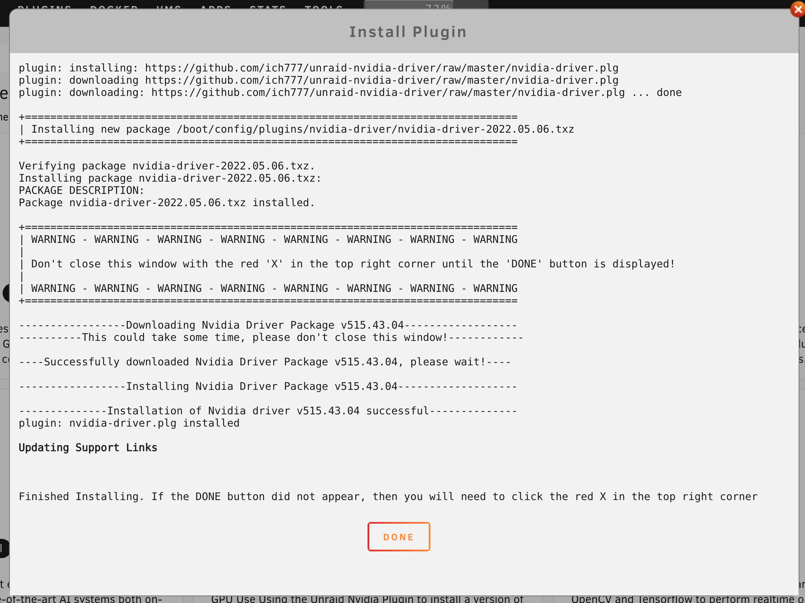

I've been using this plugin with no issues for months.  After a reboot today it did not find my GPU.  I tried re-downloading the plugin and get this error:
-----ERROR - ERROR - ERROR - ERROR - ERROR - ERROR - ERROR - ERROR - ERROR------
----Can't get Production Branch version and found no installed local driver-----
-----Please wait for an hour and try it again, if it then also fails please-----
------go to the Support Thread on the unRAID forums and make a post there!------
plugin: run failed: /bin/bash retval: 1
Thoughts?

Wait, hold the phone, it's back up!  Tried installing one last time and voila!  Thank you for your assistance!
Edited by lilbumblebear
