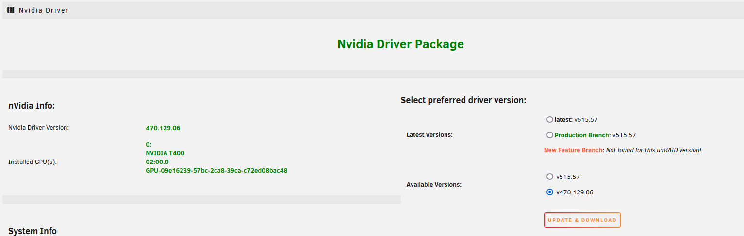

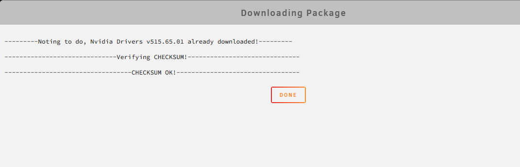

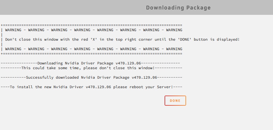

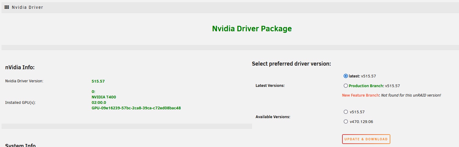

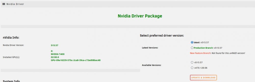

EDIT: I've now tested it on my server and everything is working as expected:
Here with the installed driver version 515.57:

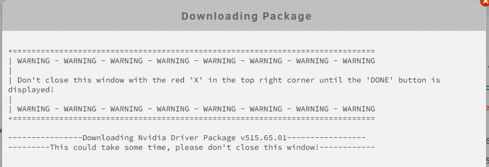

The Downloading Package box opens after selecting a static version and clicking Update & Download (I've waited for the download to finish and clicked on DONE):
After the reboot the plugin now shows the correct driver version:
Thank you for the response. To install an older version I selected v510.73.05 which is in my available version list similar to your screenshots. Once it completed I closed the window and had the notification I needed to reboot. Upon reboot the GPU did not show up in the settings for the plugin. I rebooted again and this time the latest driver was installed. This entire thing happened a second time. Additionally, I had been running v510.73.05 for awhile so I'm not even sure how the latest got installed.
I am now running the version I want after uninstalling the plugin, rebooting, installing the plugin, installing the driver I want, then rebooting again.

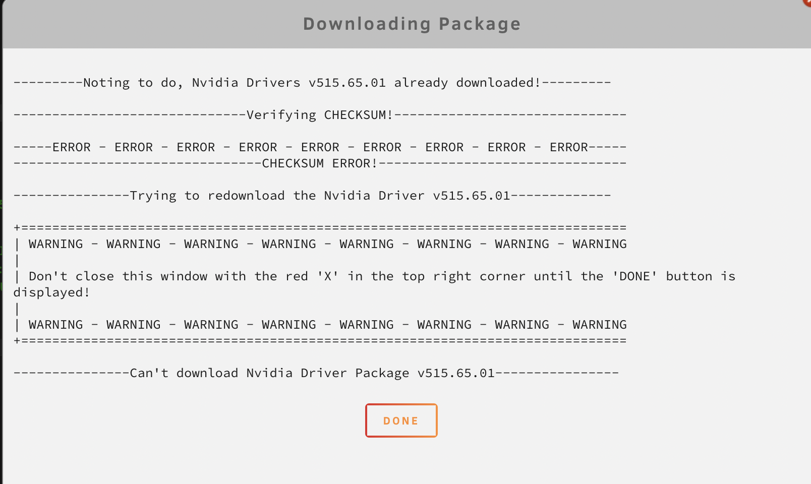

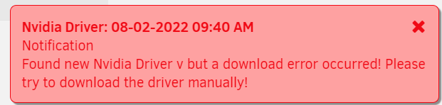

Ruh Row
Anyone know whats up?
Diagnostics?
On what plugin version are you? Please make sure your plugin is up to date.

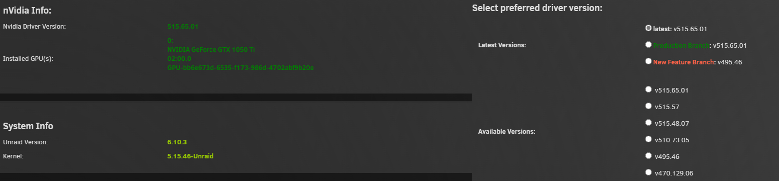

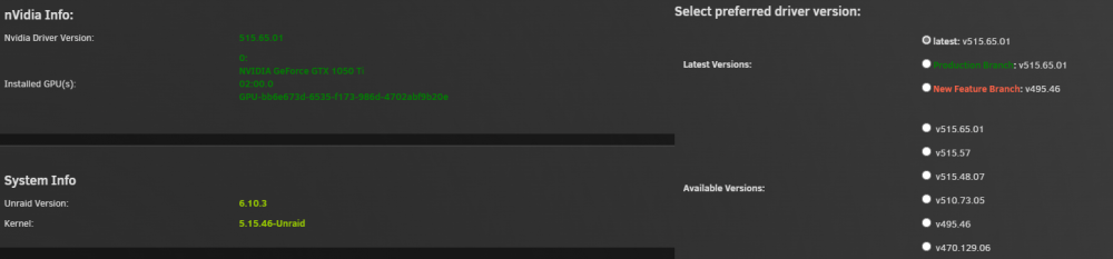

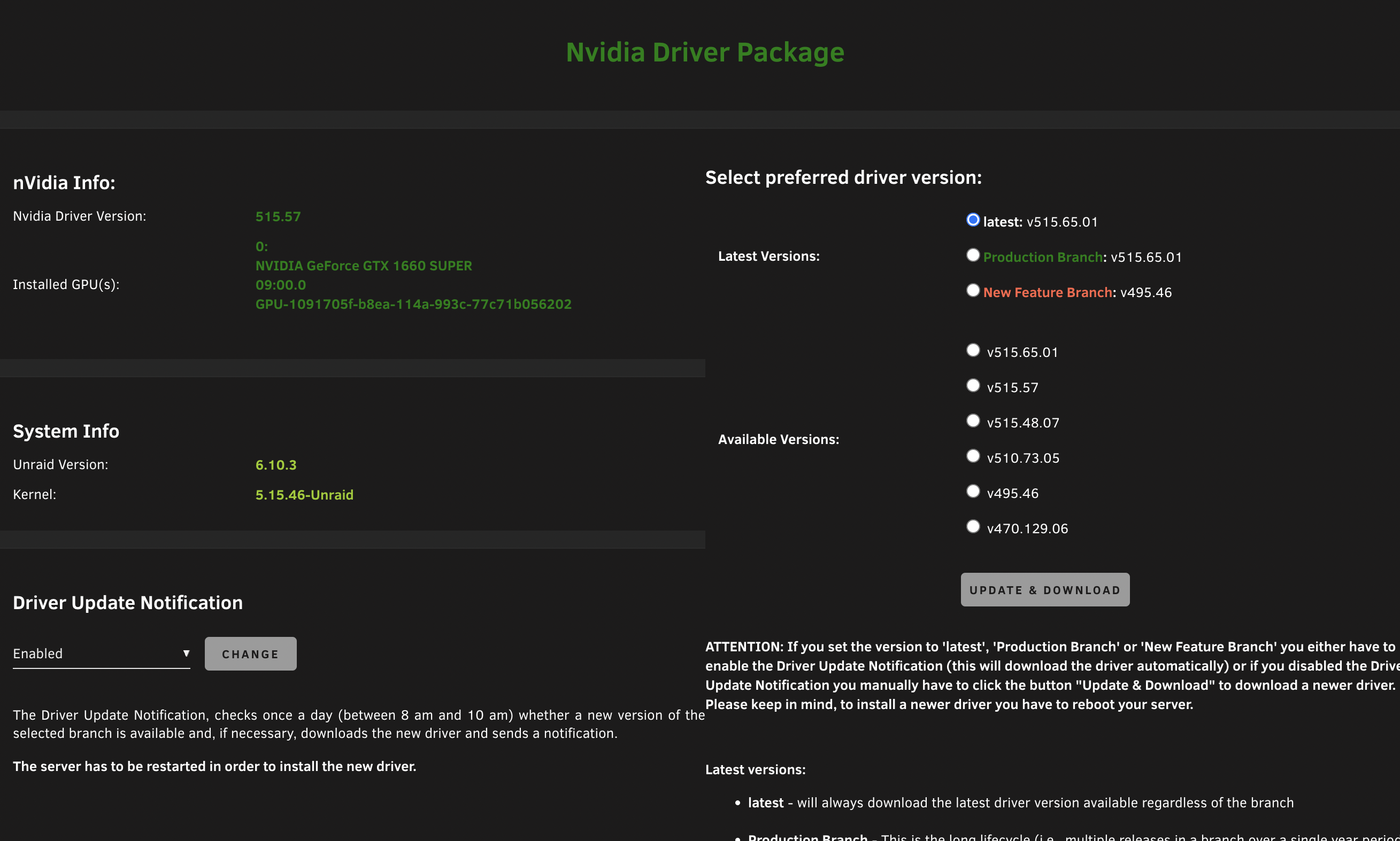

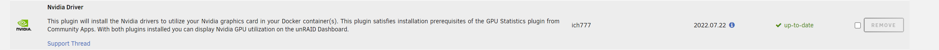

2 minutes ago, danimal86 said:

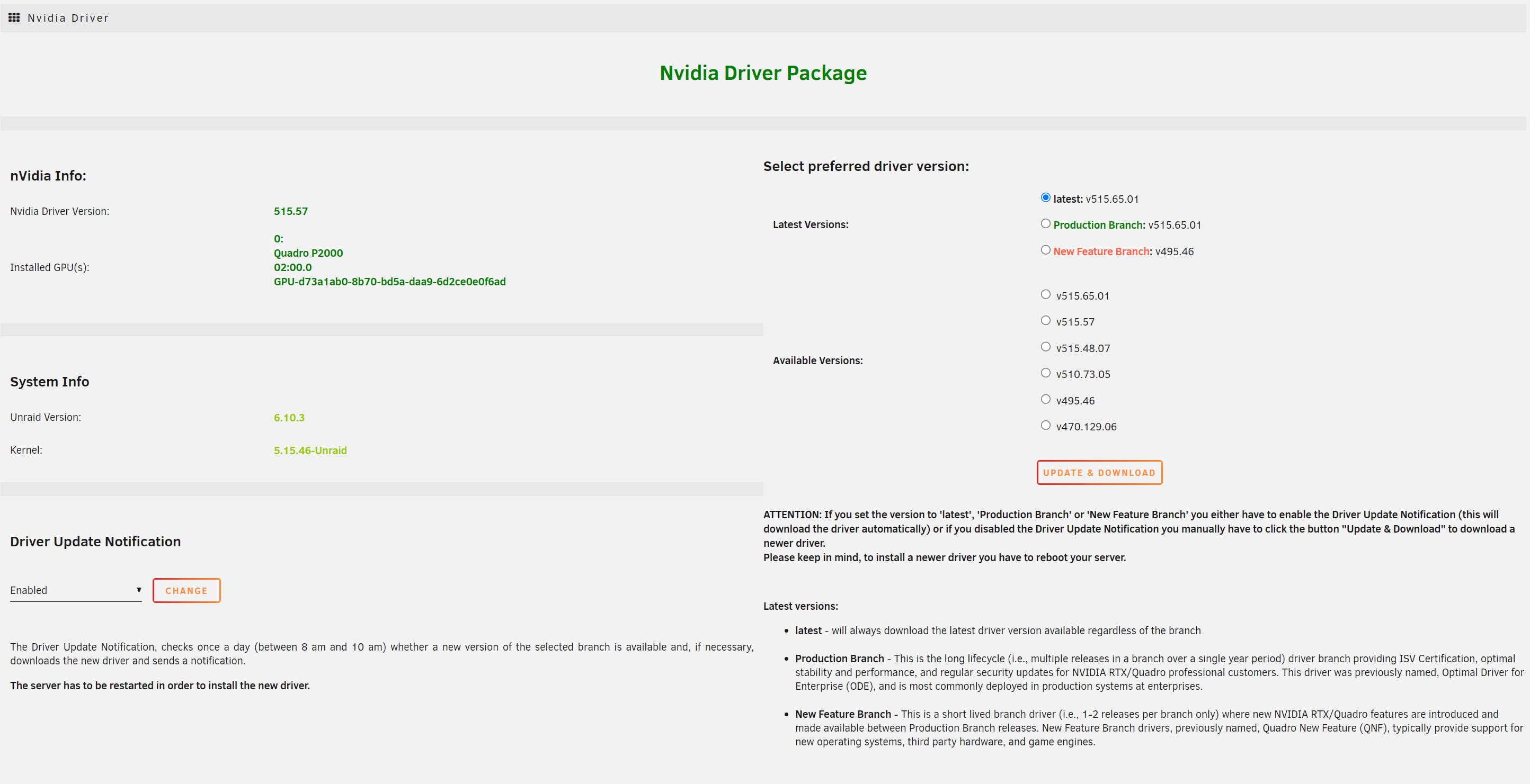

I'm on 2022.07.22 plugin version, it doesn't show any plugin updates.
Please post a screenshot from your plugin page.
Which driver did you choose?

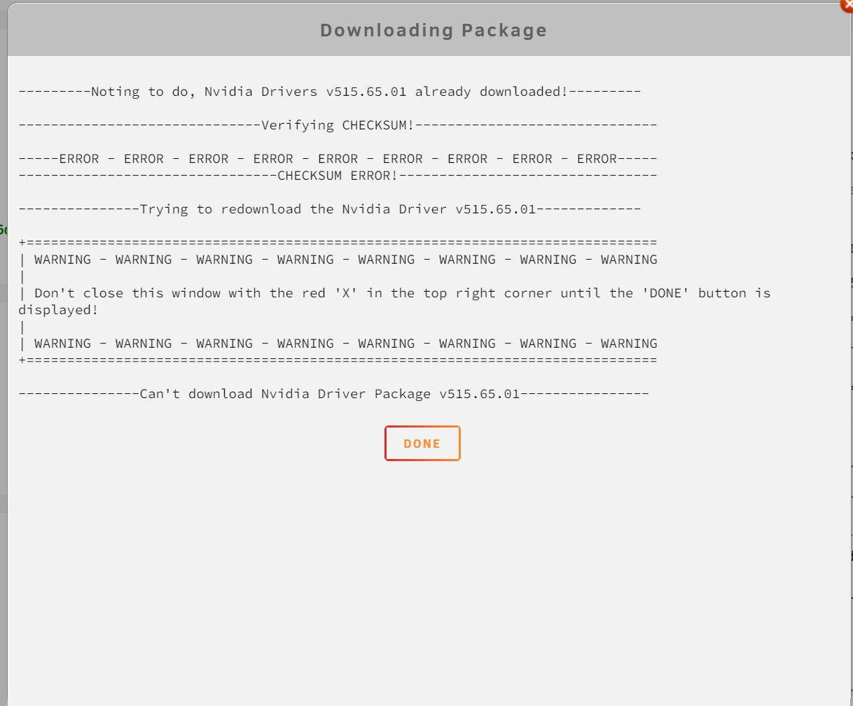

Sorry, I'm not sure why the forum isn't saving my text, but I get the same errors Danimal gets.
Edited by Bearco
Text didn't save.
I will take a quick look at this, give me a bit please.
Have to downgrade to 6.10.3
@danimal86 & @Bearco have found an bug please execute this from a Unraid terminal and click the Update & Download butten after executing the command:
rm -rf /boot/config/plugins/nvidia-driver/packages/$(uname -r | cut -d '-' -f1)
I will fix this ASAP so that this won't happen the next time you try this.
Will do.

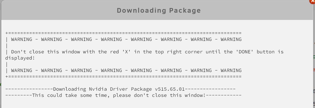

Ran the command and updating/downloading now.....patiently waiting 🙂
Thank you! it downloaded and restarting now.
Just coming back to say that it seems to be fixed!
Thanks for the ridiculously quick resolution to the problem!
