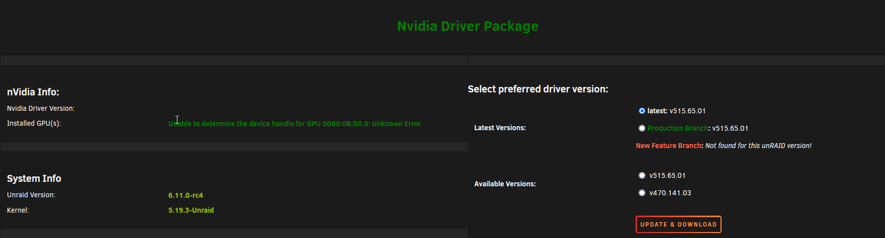

@ich777 I installed a 1660 into my unraid server to utilize with your docker image. I'm having an issue where the GPU registers in the system (with the nvidia plugin), but when I try to utilize the GPU for transcoding, plex just throws a black screen and never actually transcodes. Hardware transcoding does work with Jellyfin which is what makes me think it's an issue with the docker image. Any help you could provide would be greatly appreciated. I have disabled HDR tone mapping as a troubleshooting step as I saw others were having trouble with it in the plex forum. It did not fix the issue.
PacMan_UpdateContainer_Redacted.pdf
pacman-diagnostics-20220905-0758.zip
Edited by tusculumgolfer
Add diagnostic file

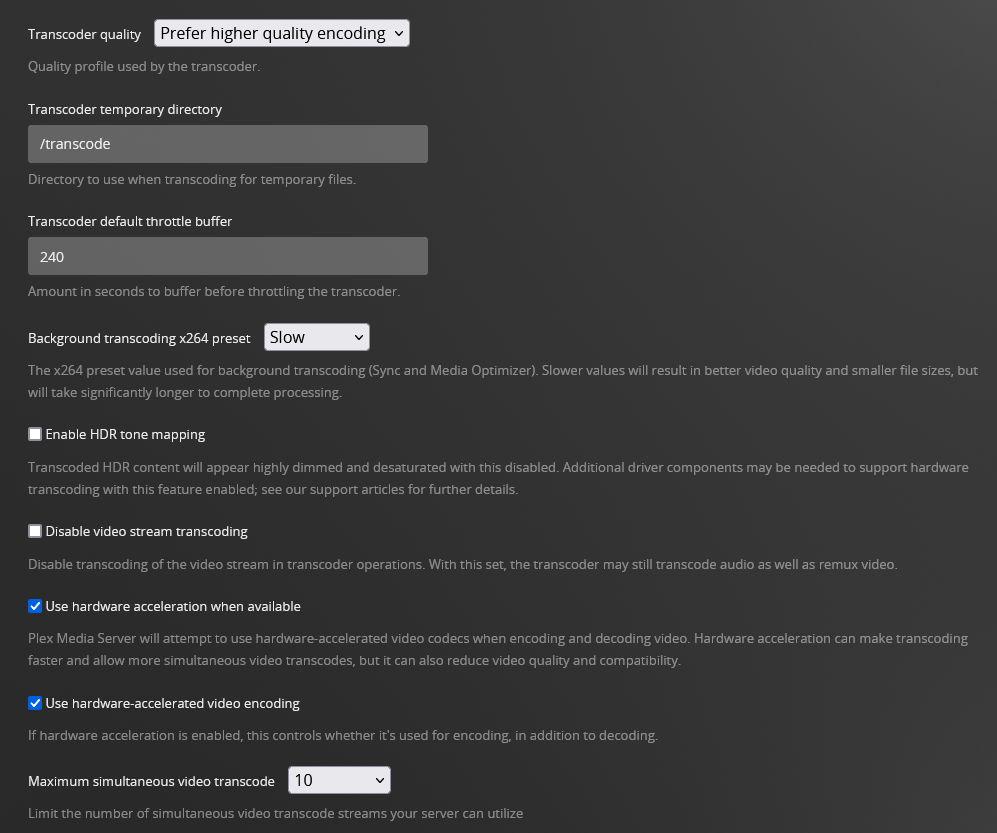

I think then it would be best that you post this issue in the according support thread for the Docker container since this is not an issue with the plugin itself.
Please note that I always recommend to use the official Plex container, I got a few reports that some of the 3rd party containers won't work properly sometimes with HW transcoding.

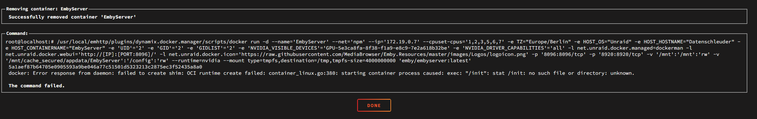

Hello,
after following your instructions, unfortunately I can't get Emby to run. I get the following message:
docker: Error response from daemon: failed to create shim: OCI runtime create failed: container_linux.go:380: starting container process caused: exec: "/init": stat /init: no such file or directory: unknown.
A reinstallation of EMBY Docker solved the problem. Even though I don't know what the problem was.
If the issue occurs the next time, please post your Diagnostics.

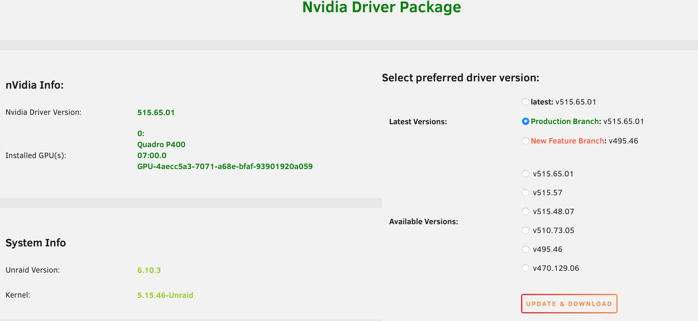

ive been having an issue for past month or so. I found that Plex wont run when I have a GPU listed, then I looked at the nvidia plugin and it shows that no GPU is there. if I look into system devices, it is there. I tried uninstalling the plugin and reinstalling it. This all worked before, the only difference is the driver version/plugin version.
its an Nvidia 1660 Super.
backup-diagnostics-20220907-2317.zip

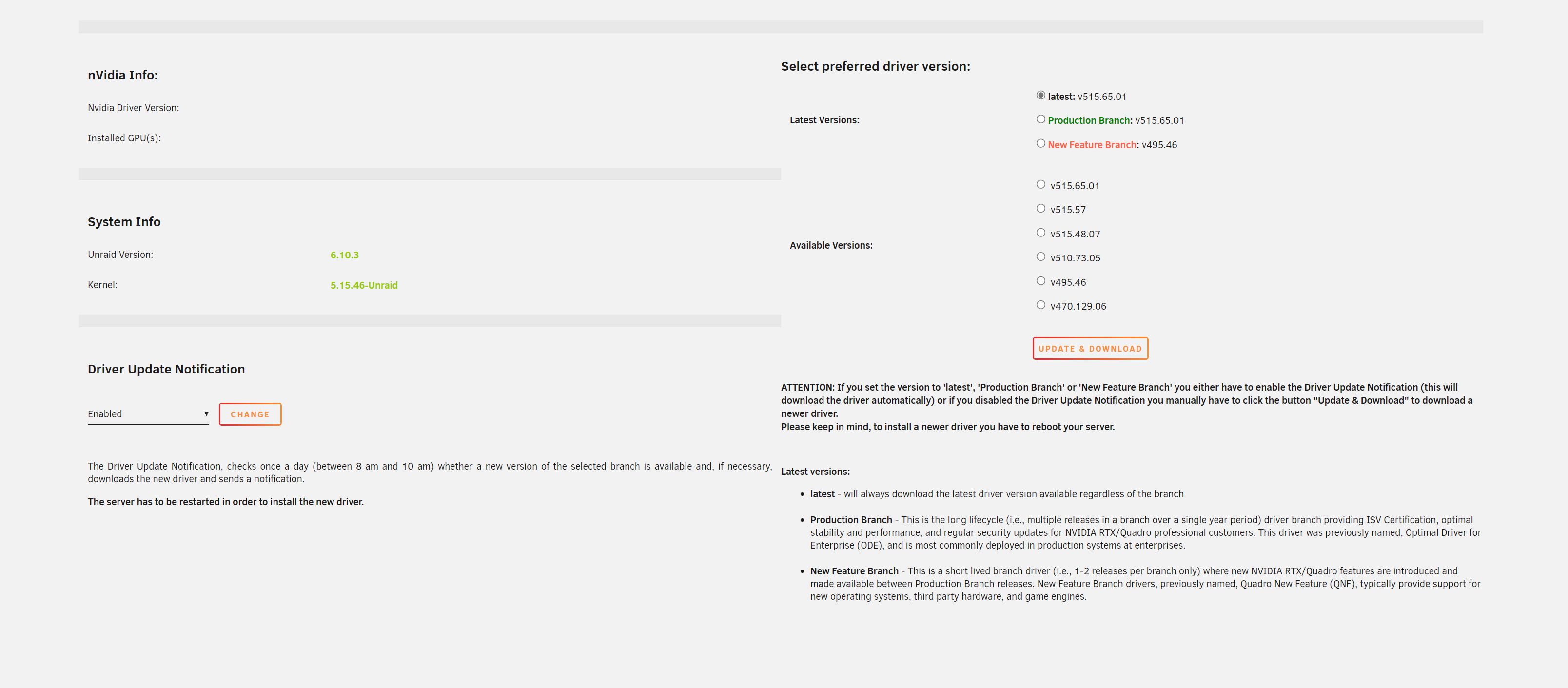

It seems like the driver isn't installed fully. Did you wait until the DONE button was displayed on plugin installation?
What is the output from:
nvidia-smi
from a Unraid terminal?
Can you please try to click the Update & Download button again and see what happens?
If it says that something is wrong with the driver please wait for it to fully download and restart your server.
Otherwise I would recommend that you:
  1. Uninstall the plugin
  2. Reboot
  3. Pull a fresh copy from the CA App and wait until the done button is displayed
  4. Reboot
After that the driver should be installed properly and you see your GPU listed on the Plugin page.
nvidia-smi
  2. Reboot
  4. Reboot
it said that the checksum was bad. it redownloaded and I rebooted. the GPU is now showing. thank you!

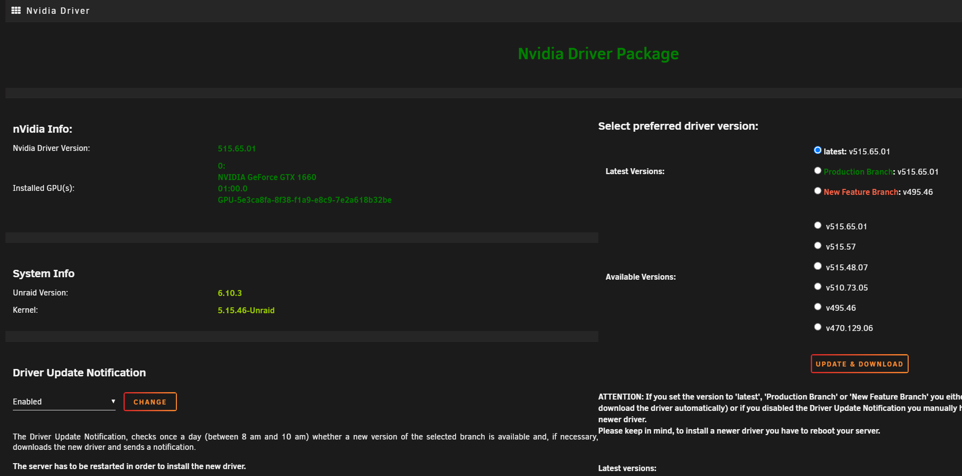

nvidia-smi
  2. Reboot
  4. Reboot
I completed the uninstall and reinstall like you laid out here and I can see one of the two GPUs in the Nvidia Driver plugin again (the other GPU is in pass-through to a VM so not sure if it should show up here). I have the server diag from before the change as well if your interested. Let me know if you want the one after and I can upload it too.

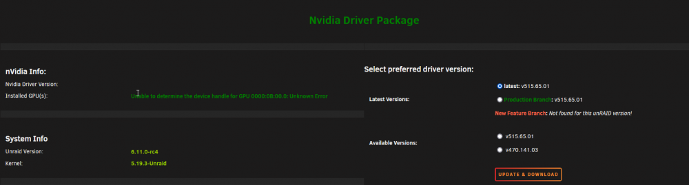

New to Unraid I have a Dell R720 and a Quadro P2000 I use with Jellyfin, I upgraded my OS to 6.10.3 and after that I could not get the NVidia Drivers to work it did not seem to see my card any more I then downgraded back to 6.9.2 with no luck if you start the NVidia Drivers download it will start and stay on the download screen and will never give me the done button. I have now upgraded to 6.11.0-rc5 and all my problems are gone I have my Quadro P2000 back and the Nvidia Drives installed
Have you any Diagnostics from where you got the issues? I really can't help with that little information.
The issue with the Done button is usually caused because it can't properly communicate with GitHub (this is where the driver packages are located) and/or GitHub has issues with it's downloads again.
Over here sometimes (but this happens really occasionally) I get download speeds of about 100KB/s and as you can imagine for a driver package of about 200-300 MB this can take a long time.
I also would recommend the next time you got such an issue that you:
  1. Remove the Plugin
  2. Reboot
  3. Grab a fresh copy from the CA App
  4. Reboot
If you never get a Done button then I would recommend that you wait a few hours and remove the plugin in the meantime and then try it again.

Hi sorry no Diagnostics next time I will add some if I have any problems.
Removed rebooted and all that from what I can see it never got the .md5 file this was over a day and still never got to the done button, I have also done a manual download off all the files needed and added it into the correct location with me doing that I got to a point that I could start the Nvidia Driver but then I get the no card detected errors. I did see in some posts that someone upgraded to 6.11.0-rc4 if I recall so I did the upgrade to 6.11.0-rc5 and redownloaded from the CA app and took less than 5 min all done and working now.
Please keep in mind that I downgraded my test server to 6.10.3 and verified that the download is working indeed, I think there is some weird issue with GitHub sometimes and certain files.
Anyways, glad that all is working now.

Yes thanks all working now I will keep going on 6.11 for now, I also think it's weird as it was working 100% on 6.9 it was after the upgrade to 6.10 I have started to see some weird thing happening.
But thanks all working good now had some Dockers I had to reinstall but looks like it's all working again from what I can see.

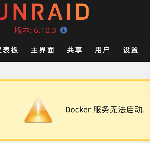

After I install the driver, the Docker service cannot be started. Please help me diagnose the problem. Thank you.
EDIT: SOLVED
Edited by ich777
Removed Diagnostics
You inject a private Docker registry to /etc/docker/daemon.json from your go file.
Please remove that from your go file and reboot your server.
After you‘ve rebooted you will see that your daemon.json has the changes for the nvidia runtime in it.
If you want to keep that private Docker registry, you have to also customize your injection into the file that it includes this changes for the nvidia runtime.
From what I saw it also looks very suspicious that you have:
{undefined
at the start, are you sure that this is correct?
