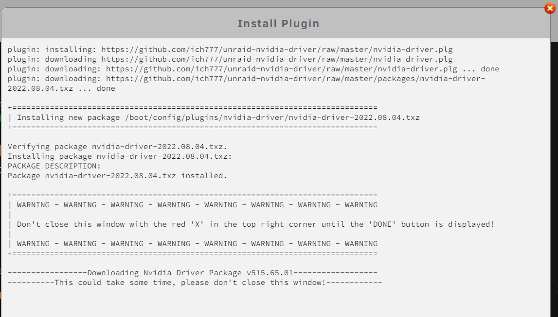

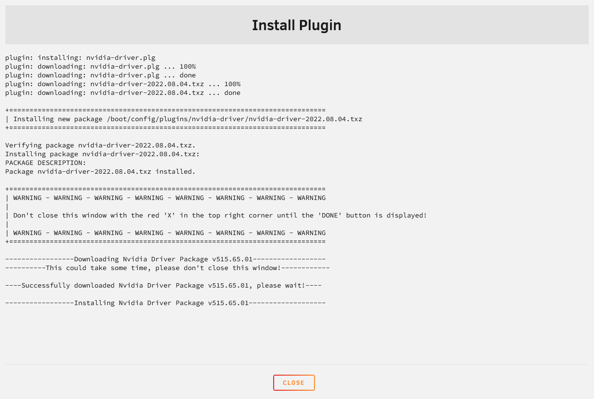

10 hours ago, Dbudd424 said:
I can leave the window up for hours and it never finishes installing.
Something really strange is going on here and really can't tell what the cause of this issue is.
Please try this:
  1. Remove the plugin
  2. Execute: rm -rf /boot/config/plugins/nvidia-driver*
  3. Reboot
  4. Try to install the plugin again from the CA App - of course wait for the plugin window to display the Done button
  5. Reboot again
  6. Pull the Diagnostics and post them here

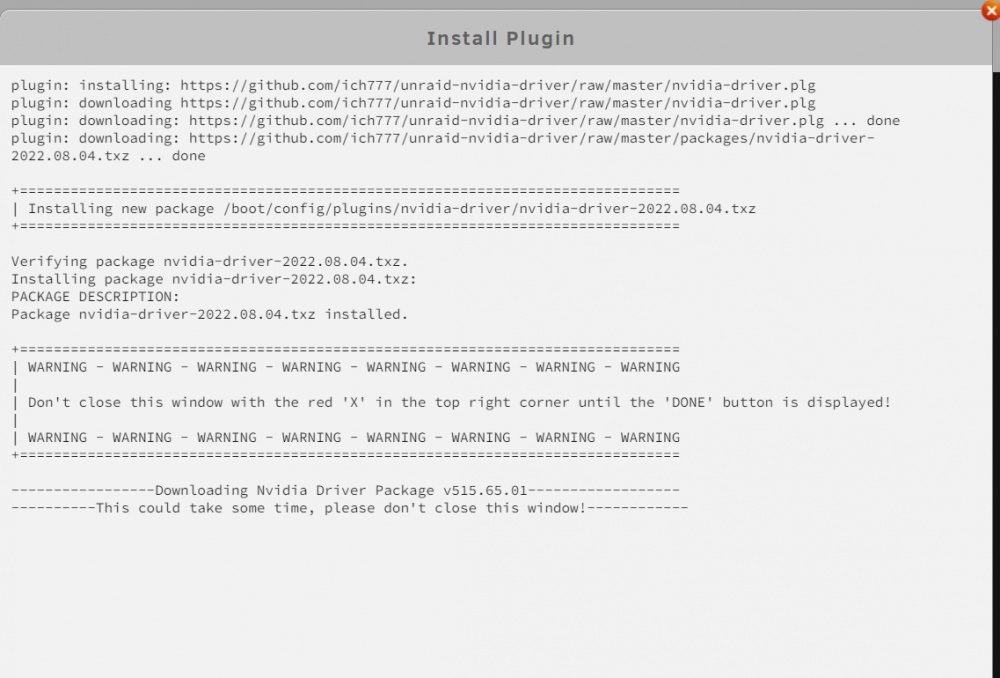

Please try this:
  3. Reboot
  5. Reboot again

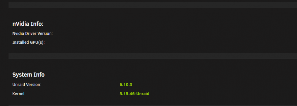

So the strange thing is If I close out of the installer and go to settings it will show the plugin there till I reboot and then it goes away.
I have rebooted and confirmed the plugin isn't in settings anymore.
Ran rm -rf /boot/config/plugins/nvidia-driver* and confirmed the folder no longer existed under flash\config\plugins
Rebooted again.
Started my Array back up.
Started the install from CA Apps at 8:52 am CT.
Checking flash\config\plugins\nvidia-driver
\flash\config\plugins\nvidia-driver\packages\5.15.46
Waited 2 hours and here is where its at 10:52 am CT.
I'm going to give it another hour and I'll close reboot and pull the Diagnostics and post them here.

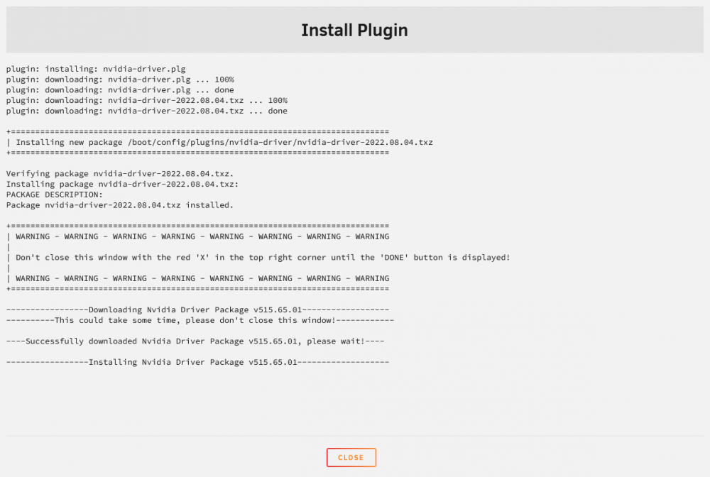

I seems that it has issues pulling the .md5 file for this driver.
What kind of USB Flash drive are you using?
Have now tried it and it worked flawlessly:
Yes, because it can't find the md5 file on reboot and thinks that the driver isn't valid and so it gets removed.
You can circumvent that by simply placing the .md5 file in this directory and it should work that way too.
Flash drive is a 2.0 16gb Model: ona16aa016
Place the files in the folder and booted the server back up.
If I reboot with these files here Nvidia driver doesn't show up in settings so if I run the app give it an hour close it out and go to the nvidia driver under settings and run Update & Download I get
If I reboot nvidia driver is no longer in settings but all the files still exist in the folder.
I'm going to see if I can setup a new flash drive for unraid and give the install another go.

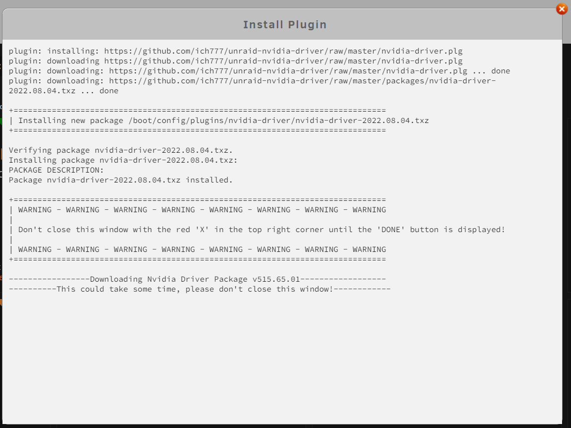

Never heard of that I would recommend that you use something like a Transcend JetFlash 600 USB 2.0
After thinking again about it I think I had that issue oncex
The user solved this by changing the USB Boot device IIRC and never had that issue again.

On 8/18/2022 at 1:12 PM, ich777 said:
This (Above 4G decoding) has nothing to do with the memory size from add on cards, this is only the address space that a add on card can use in RAM.
I have the Quadro M2000 card installed and working now. Plex is able to see it and transcode!
So I changed flash drive to a different one and moved my license to it.
Tested it in a different usb port on the motherboard as well.
After 2 hours still stuck on this screen.
Looking at flash\config\plugins\nvidia-driver\packages\5.15.46 it still looks like its having an issue pulling the .md5
I test installed 2 random apps without any issues just to make sure it wasn't some crazy read only issue on the flash drive.
I'm going to play with it some more and see if I can get it to work.

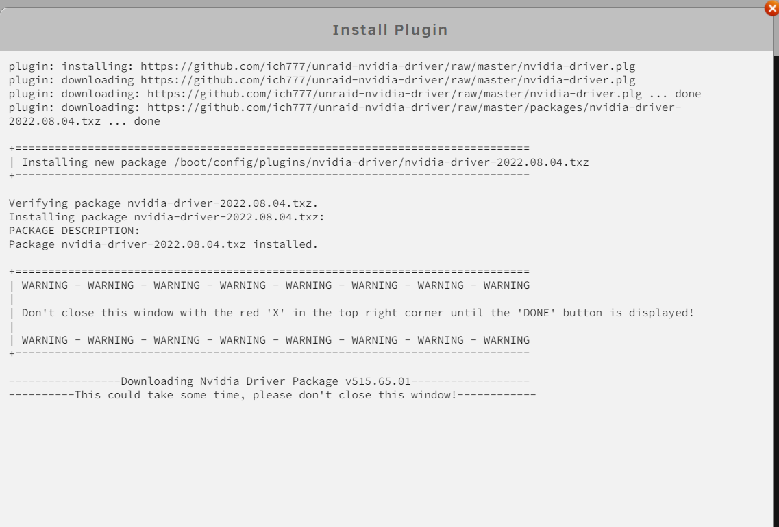

This is really some funky stuff and I really can't explain what causes this on your system.
Are you willing to upgrade to 6.11.0-rc3 and try if it's the same there?
I've even now tried it on my production server where no Nvidia card is installed and it is working fine there too.
Ok, So I upgraded to 6.11.0-rc3. And at first the close button almost tricked me into thinking it worked instantly but I left it alone for 5 minutes and it ran through and completed and changed from close to done.
I'm going test it but it looks like upgrading the OS worked. Thank you for the help.

Aug 28 03:13:25 Tower kernel: NVRM: nouveau, rivafb, nvidiafb or rivatv
Aug 28 03:13:25 Tower kernel: NVRM: was loaded and obtained ownership of the NVIDIA device(s).
Aug 28 03:13:25 Tower kernel: NVRM: Try unloading the conflicting kernel module (and/or
Aug 28 03:13:25 Tower kernel: NVRM: reconfigure your kernel without the conflicting
Aug 28 03:13:25 Tower kernel: NVRM: driver(s)), then try loading the NVIDIA kernel module
Aug 28 03:13:25 Tower kernel: NVRM: again.
Aug 28 03:13:25 Tower kernel: NVRM: The NVIDIA probe routine failed for 1 device(s).
Aug 28 03:13:25 Tower kernel: NVRM: None of the NVIDIA devices were initialized.
Aug 28 03:13:25 Tower kernel: nvidia-nvlink: Unregistered Nvlink Core, major device number 241
Aug 28 03:14:11 Tower webGUI: Successful login user root from 192.168.1.101
Aug 28 03:14:17 Tower kernel: nvidia-nvlink: Nvlink Core is being initialized, major device number 241
Aug 28 03:14:17 Tower kernel: NVRM: This PCI I/O region assigned to your NVIDIA device is invalid:
Aug 28 03:14:17 Tower kernel: NVRM: BAR0 is 0M @ 0x0 (PCI:0000:02:00.0)
Aug 28 03:14:17 Tower kernel: nvidia: probe of 0000:02:00.0 failed with error -1
Aug 28 03:14:17 Tower kernel: NVRM: The NVIDIA probe routine was not called for 1 device(s).
Aug 28 03:14:17 Tower kernel: NVRM: This can occur when a driver such as:
Aug 28 03:14:17 Tower kernel: NVRM: nouveau, rivafb, nvidiafb or rivatv
Aug 28 03:14:17 Tower kernel: NVRM: was loaded and obtained ownership of the NVIDIA device(s).
Aug 28 03:14:17 Tower kernel: NVRM: Try unloading the conflicting kernel module (and/or
Aug 28 03:14:17 Tower kernel: NVRM: reconfigure your kernel without the conflicting
Aug 28 03:14:17 Tower kernel: NVRM: driver(s)), then try loading the NVIDIA kernel module
Aug 28 03:14:17 Tower kernel: NVRM: again.
Aug 28 03:14:17 Tower kernel: NVRM: The NVIDIA probe routine failed for 1 device(s).
Aug 28 03:14:17 Tower kernel: NVRM: None of the NVIDIA devices were initialized.
Aug 28 03:14:17 Tower kernel: nvidia-nvlink: Unregistered Nvlink Core, major device number 241
24 minutes ago, Andrea Nizzola said:
I'm not sure what else to try at this point, please give me a hand.
Please post your Diagnostics.
5 minutes ago, Andrea Nizzola said:
Thank you for the reply, here is the diagnostic
Have you maybe upgraded the BIOS at one point?
Please make sure that you have the following BIOS options enabled:
  • Above 4G decoding
  • Resizable BAR Support
This issue is usually caused by something miss configured in the BIOS or a hardware incompatibility issue.
Have you yet tried to re seat the card or put it in another PCIe slot?
