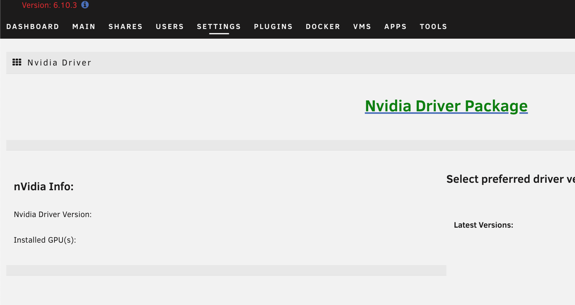

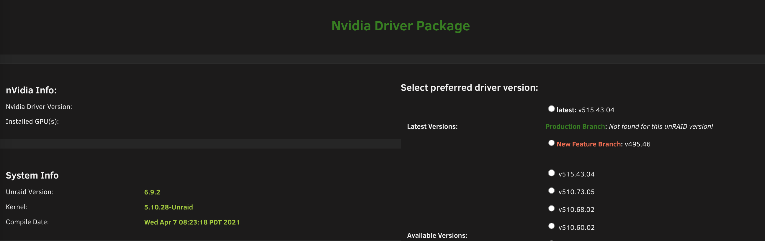

I just upgrade to 6.10.3 and I lost my GPU plugin support in process. I have tried to reinstall/reboot multiple times without any luck. GPU won't show up in plugin. GPU is available option to VMs if I try to make one. GPU is not passed trought to any VM.
Here is message when tried to install Nvidia-Plugin:
| Installing new package /boot/config/plugins/nvidia-driver/nvidia-driver-2022.05.06.txz
Verifying package nvidia-driver-2022.05.06.txz.
Installing package nvidia-driver-2022.05.06.txz:
PACKAGE DESCRIPTION:
Package nvidia-driver-2022.05.06.txz installed.
-------Main download URL not reachable, using Fallback URL-------
-----ERROR - ERROR - ERROR - ERROR - ERROR - ERROR - ERROR - ERROR - ERROR------
---Can't get latest Nvidia driver version and found no installed local driver---
plugin: run failed: /bin/bash retval: 1
Plugin will also disappear from settings during reboot.
Any help?
Please post your Diagnostics.

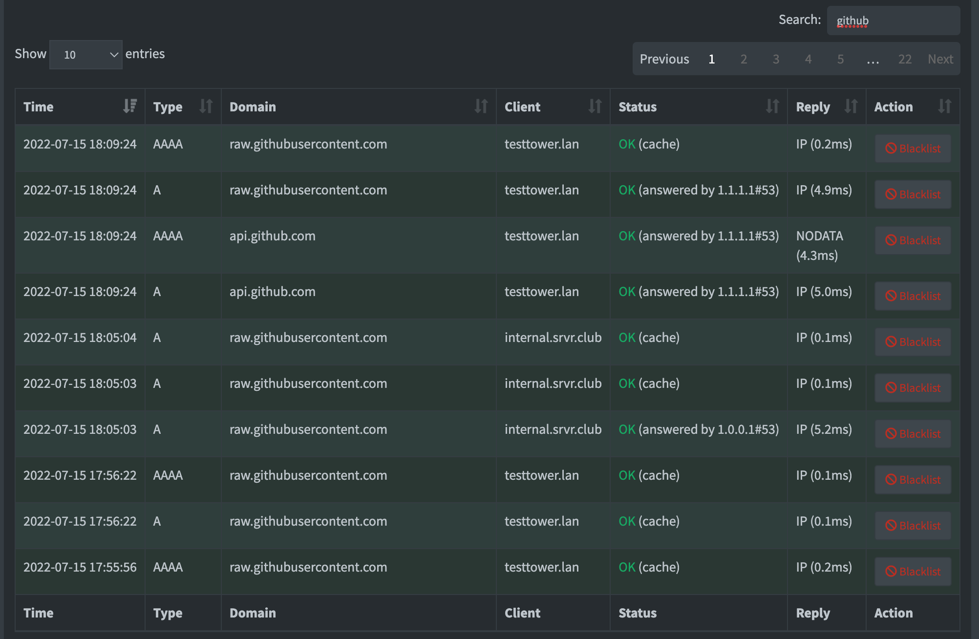

Have you any AdBlocking software on your network running?
Can you reach GitHub from your local computer?
Seems like that your Server can't communicate with GitHub (where the driver package is located).

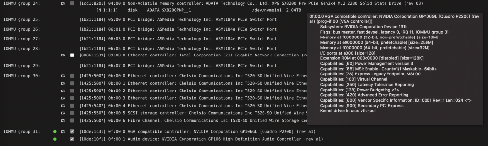

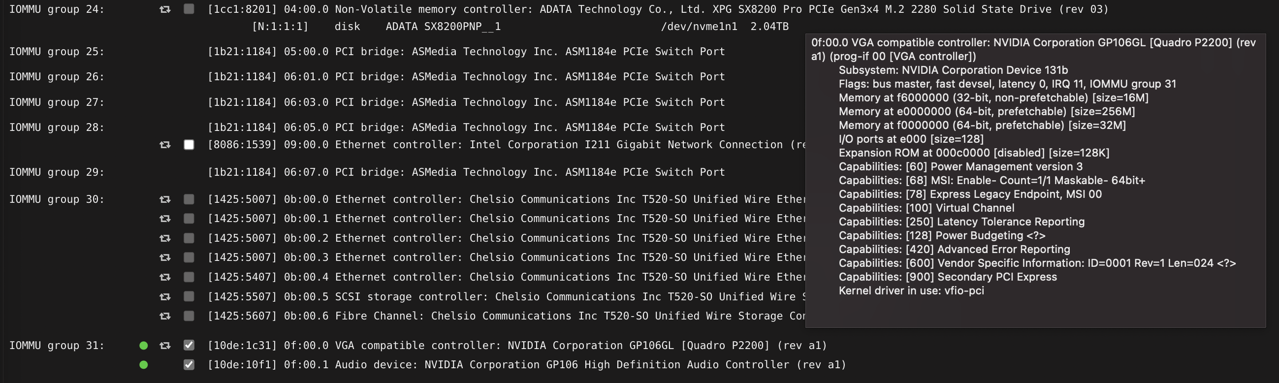

Nvidia Quadro P2200 not recognized.
Had a Quadro P2000 lying around - same issue . .
Was working, but from one day to the other it just disappeared from unraid.
master-diagnostics-20220708-1429.zip
Edited by elcapitano
How should the Quadro be recognized by the plugin if it‘s bount to VFIO?
BIND=0000:0f:00.0|10de:1c31 0000:0f:00.1|10de:10f1
This is something that can't work and you can also see from your screenshot that the driver in use is "vfio-pci" and not "nvidia".
0f:00.0 VGA compatible controller [0300]: NVIDIA Corporation GP106GL [Quadro P2200] [10de:1c31] (rev a1)
	Subsystem: NVIDIA Corporation Device [10de:131b]
	Kernel driver in use: vfio-pci
0f:00.1 Audio device [0403]: NVIDIA Corporation GP106 High Definition Audio Controller [10de:10f1] (rev a1)
	Subsystem: NVIDIA Corporation GP106 High Definition Audio Controller [10de:131b]
Also why are you on 6.9.2? Unraid 6.10.3 is the most recent version.

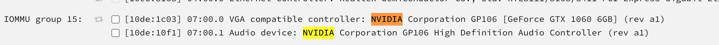

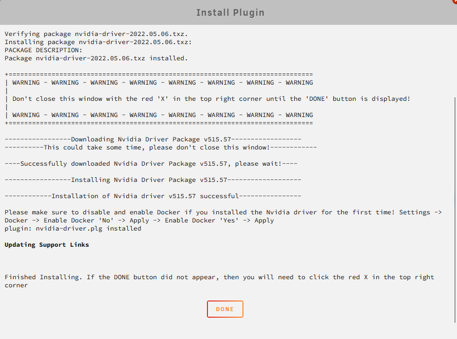

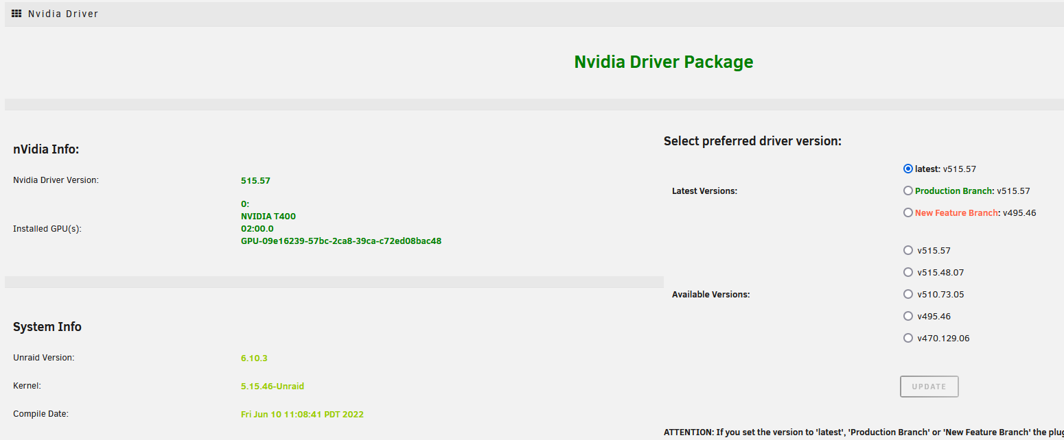

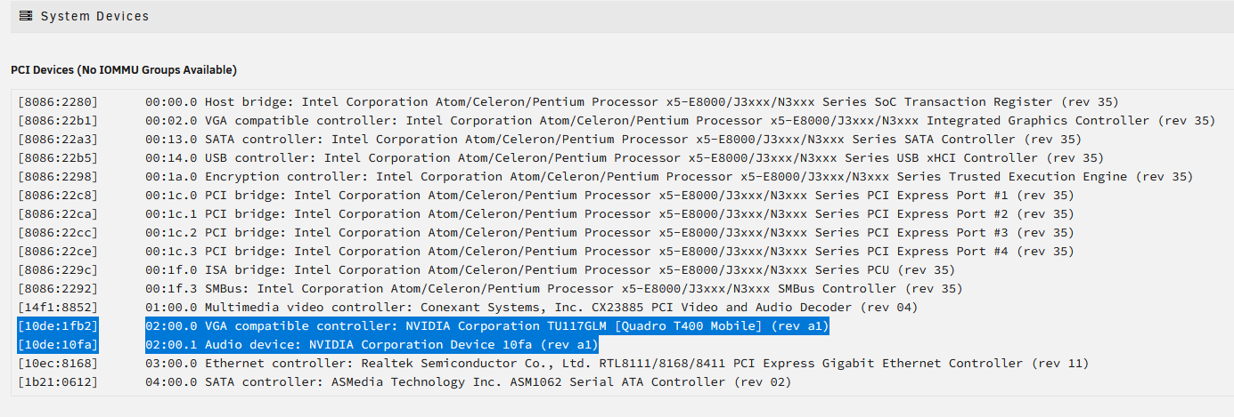

@VoNpo & @elcapitano just to let you know and because I was also curious, I've now tried it on my test server and it works without a hitch, I've uninstalled the Nvidia-Driver plugin, rebooted my server and pulled a fresh copy from the CA App:
(the screenshot shows the installation stage because this takes a little while on my test server, it's not really the fastest machine)
This is after it was finished installing:
Here you can see my system devices:
And here is also a screenshot from the plugin itself:
Thanks for this - big help.
I un-bound the device - reboot - removed the driver - reboot - installed new driver - reboot -> All good 🙂

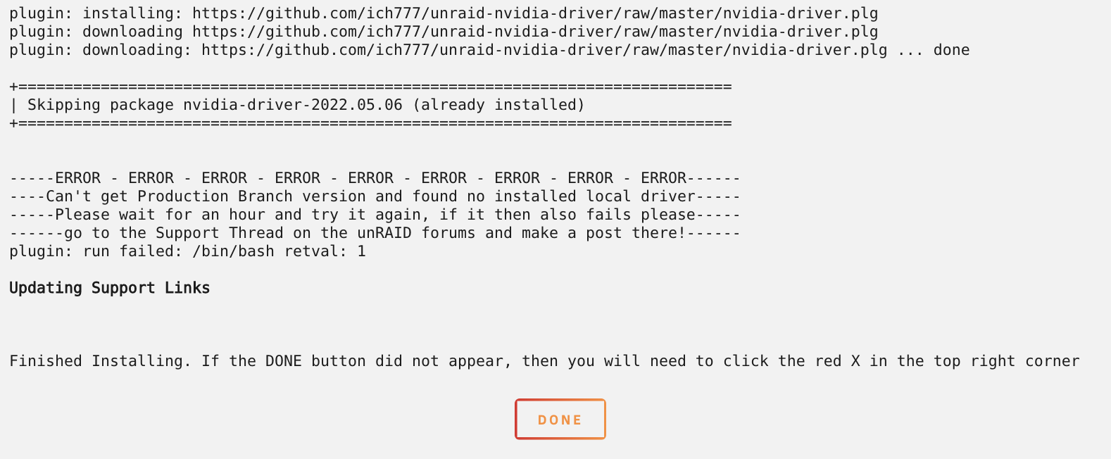

Hello,
I am having an issue with this plugin. I rebooted my server and it was no longer showing up. I tried to install it but am receiving this:
----Can't get Production Branch version and found no installed local driver-----
-----Please wait for an hour and try it again, if it then also fails please-----
------go to the Support Thread on the unRAID forums and make a post there!------
I have attached my logs/diagnostics. Hopefully someone can help :)
server-unraid-diagnostics-20220709-0837.zip

Update: I followed a previous posts advice and deleted the plugin using the terminal. Reinstalled, rebooted and running fine now.
I think in some parts of the world GitHub has some issues or something isn't working quite right since it can't pull the latest driver version...
Really not sure what to do about that, sorry for the inconvenience...

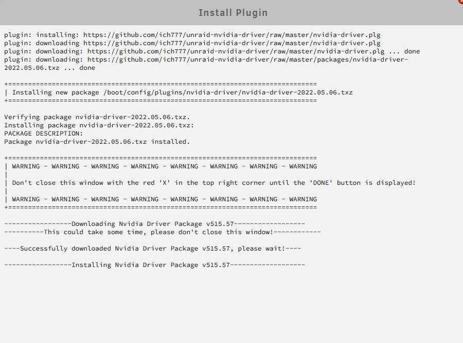

Man, I really struggled getting the nvidia driver plugin reinstalled after upgrading to 6.10.3. The problem was that I'm an idiot. Also, maybe a slight problem with the plugin installer user interface?
I followed all the instructions here -- removed the plugin using 'rm' at the command line, rebooted about 40 times, and kept trying to reinstall the plugin from community apps. The problem arose because the plugin installer status window would get to the line that says
"Package nvidia-driver-2022.05.06.txz installed."
And then the window/text would pause and do nothing for 30-60 seconds. So at that point I thought the driver was installed and rebooted. I never waited for the plugin to actually finish installing. I did this about 10 times.
The problem was I never saw the *next* part that says:
"WARNING - WARNING - WARNING... Don't close this window ... until the Done button is displayed!"
But it took soooo loooong for that text to be displayed, I never saw it. I didn't figure out that the process wasn't finished until I saw other people's screenshots here on the forum.
I wonder what's happening between the "Package... installed" and "WARNING - WARNING" that caused such a long delay? If there's some call there that can be moved/removed so the WARNING WARNING comes up immediately, it sure would have saved me a couple hours of going around in circles and rebooting too soon.
Of course, once I actually waited until the whole thing was *actually* finished and the Done button finally appeared, it all worked great.
This text should be shown imediately.
The first steps are basically that the plugin itslef is downloaded and installed (the GUI part), wich is actually not even 1MB and then the message WARNING is displayed.
I really can‘t imagine what‘s going on there, maybe the pull from the version numbers are takig that long but I really can‘t imagine that that‘s the case since this file is only a file with a few KB.
Also everything is hosted on GitHub.
May I ask where you are located in the world?
I have most of the times issues with people living in China that the downloads are really slow and everything takes ages to complete.

I'm setting up a new unraid instance with this plugin and can't seem to fix this issue: on server reboot, the GPU doesn't show up in the plugin (but it does show up in system devices).
Attached diagnostics.
On boot, I see the following in the logs on screen (but not in syslog -- so this may be a red-herring):
modprobe: FATAL: Module nvidia not found in directory /lib/modules/5.15.46-Unraid
I have uninstalled and re-installed the plugin three times now because it keeps breaking on reboot.
While I do use pihole for DNS, it's not blocking github:
1107052083_ScreenShot2022-07-15at6_13_56PM.thumb.png.c1441ab6a47d87c7032fdfec8af268cd.png
In fact, no DNS queries from `testtower` are blocked.
For my BIOS, I have CSM disabled, Secure Boot disabled, fTPM disabled, TPM 2.0 disabled. I've tried with all combinations of enabling these (except secure boot of course) with no luck.
Any help would be appreciated.
UPDATE:
I tried once more after deleting the plugin, restarting and ensuring the following: CSM disabled, Secure Boot disabled, fTPM disabled, TPM 2.0 disabled. It seems to have worked now. Do I really need to keep TPM and fTPM disabled for this plugin?
testtower-diagnostics-20220715-1756.zip

5 hours ago, Howboys said:
For my BIOS, CSM disabled, Secure Boot disabled, fTPM disabled, TPM 2.0 disabled
I tried once more after deleting the plugin, CSM disabled, Secure Boot disabled, fTPM disabled, TPM 2.0 disabled
These are two times the same things that you‘ve wrote…
This is the first time that I hear from such an issue that is related to TPM in general.
I know that CSM disabled and booting with UEFI can cause issues with the Nvidia driver but never heard of TPM causing such issues.
EDIT: From what I saw from your syslog it seems like it never did load the module, but I think the Diagnostics from a boot with UEFI instead of a Legacy boot (CSM)?
