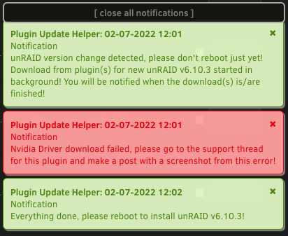

Unraid instructed me to make this post. I received this error after installing the newest Unraid build. I have not rebooted my machine yet. Is this going to mess things up if I reboot?
If you have a active internet connection on boot, no.

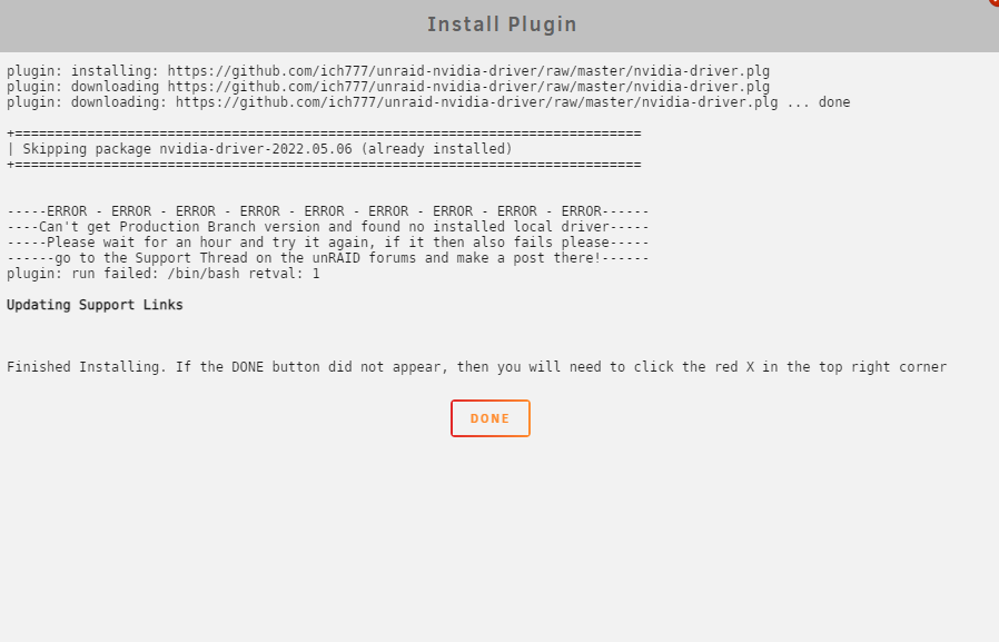

Hey
I was wondering if someone could help me. I had the driver installed and was using it for transcoding in plex. Last reboot the driver doesn't show up in the plugins anymore, when I try to re install it, it says it's already installed...

I rebooted and I couldn't start Plex. The GPU wasn't showing up. I downgraded back to 6.9.2 and now Apps doesn't work, my GPU isn't there. Nvidia plugin isn't there. And I can't upgrade again because it doesn't give me that option. My system is basically unusable for what I use it for, now.
Did you make sure you had the newer Nvidia Driver plugin that is needed for 6.10.3?    There was an earlier one with a similar name that many people have installed.
This is all my fault. I forgot that I was running my primary DNS through a Docker container. When I rebooted there was no DNS available. I am trying to straighten things out right now. But, it is all my fault for overlooking the DNS settings.
Please remove the plugin, also check if it is not in the Plugins Error tab, execute the command from a Unraid Terminal:
rm -rf /boot/config/plugins/nvidia-driver
, reboot and after that pull a fresh copy from the CA App (don't forget to restart once more or restart the Docker service).
Where are the Diagnostics?
Why did you do this?
Click on Check for updates, go to the Main tab and back to the Upgrade OS page and it will show you 6.10.3
Please pull the Diagnostics next time before downgrading, without them I can't say anything what went wrong and steps to fix it.
I would always recommend to set the Server IP and also the DNS to something static, be it the DNS server from your router or something like 8.8.8.8
Your server always needs exclusive access to the Internet without any AdBlocking in place...
Hope that makes sense.
