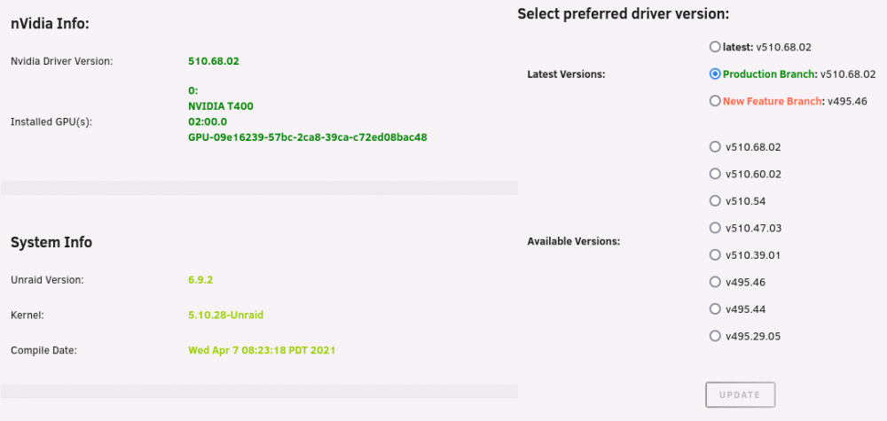

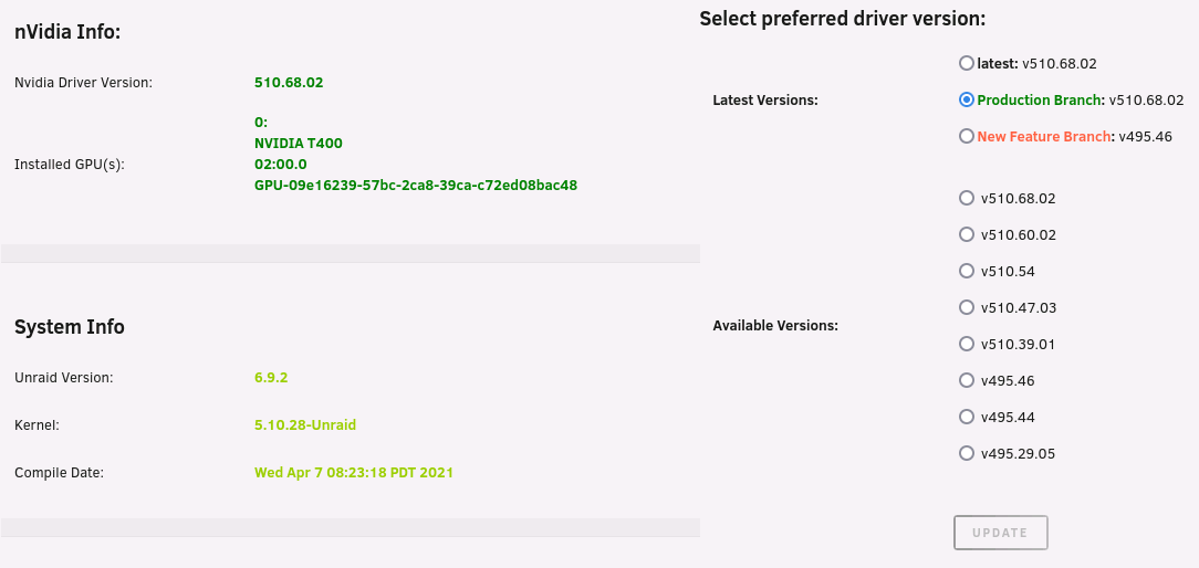

Anyone got an idea why my P400 is not recognized with the latest Production Branch driver v510.68.02?
The info section in the plugin screen remains empty and plex and tdarr won't see the card either (of course).
Rolling back to v470.94 and everything is working again.
Since this is a Pascal based card which still is fully supported by NVIDIA and the latest Linux drivers on their webpage are also the v510.68.02, I am wondering what the problem is?!
Can you please upload your Diagnostics?
Had the same problem. Kernel panic related to the nvidia drivers after update them.
Upgrade unraid to rc8 solved the problem.
Maybe something is incompatible with 6.9.2?

As said above, tested the driver and transcoding on my Nvidia T400 with three concurrent streams is working just fine.
OK, in order to capture the diagnostics for both driver installs I reinstalled the v510.68.02 and miraculously this time the card has been recognized after reboot. I did exactly the same thing 3 times before, no success. Now it works.
I swear that I don't changed anything... :)
Really strange that it now just works... but I'm also happy that it now is working... :)

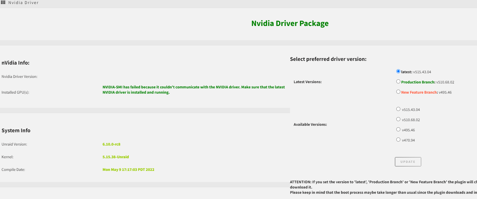

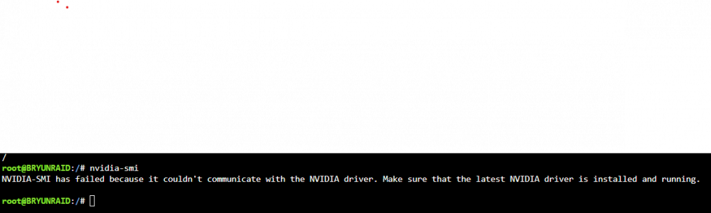

Trying to figure out why I am getting this SMI error.
I have tried to a uninstall of the plugin and reinstall of the plugin this did not help.  With reboot in between removal and adding  of th nvidia plugin
The tools system devices  list shows the card is there.
10de:128b] 03:00.0 VGA compatible controller: NVIDIA Corporation GK208B [GeForce GT 710] (rev a1)
Results below

/boot/config/plugins/nvidia-driver/nvidia-driver-2022.05.06.txz
plugin: installing: https://github.com/ich777/unraid-nvidia-driver/raw/master/nvidia-driver.plg
plugin: downloading https://github.com/ich777/unraid-nvidia-driver/raw/master/nvidia-driver.plg
plugin: downloading: https://github.com/ich777/unraid-nvidia-driver/raw/master/nvidia-driver.plg ... done
plugin: downloading: https://github.com/ich777/unraid-nvidia-driver/raw/master/packages/nvidia-driver-2022.05.06.txz ... done
| Installing new package /boot/config/plugins/nvidia-driver/nvidia-driver-2022.05.06.txz
Verifying package nvidia-driver-2022.05.06.txz.
Installing package nvidia-driver-2022.05.06.txz:
PACKAGE DESCRIPTION:
Package nvidia-driver-2022.05.06.txz installed.
| WARNING - WARNING - WARNING - WARNING - WARNING - WARNING - WARNING - WARNING
| Don't close this window with the red 'X' in the top right corner until the 'DONE' button is displayed!
-----------------Downloading Nvidia Driver Package v515.43.04------------------
----------This could take some time, please don't close this window!------------
----Successfully downloaded Nvidia Driver Package v515.43.04, please wait!----
-----------------Installing Nvidia Driver Package v515.43.04-------------------
------------Installation of Nvidia driver v515.43.04 successful----------------
Please make sure to disable and enable Docker if you installed the Nvidia driver for the first time! Settings -> Docker -> Enable Docker 'No' -> Apply -> Enable Docker 'Yes' -> Apply
plugin: nvidia-driver.plg installed
Updating Support Links
Finished Installing. If the DONE button did not appear, then you will need to click the red X in the top right corner
bryunraid-diagnostics-20220513-1741.zip
Edited by whynot88
added diags
may your card is just too old and not supported anymore, may try the oldest driver instead ...
as sidenote, this card prolly cant hardware decode hevc anyway ...
Exactly as @alturismo said, your card is too old for this driver version...
You have to select driver version 470.94 (this is the last driver that supports this card), click Updated, click on the Download button, wait for it to finish and reboot.
