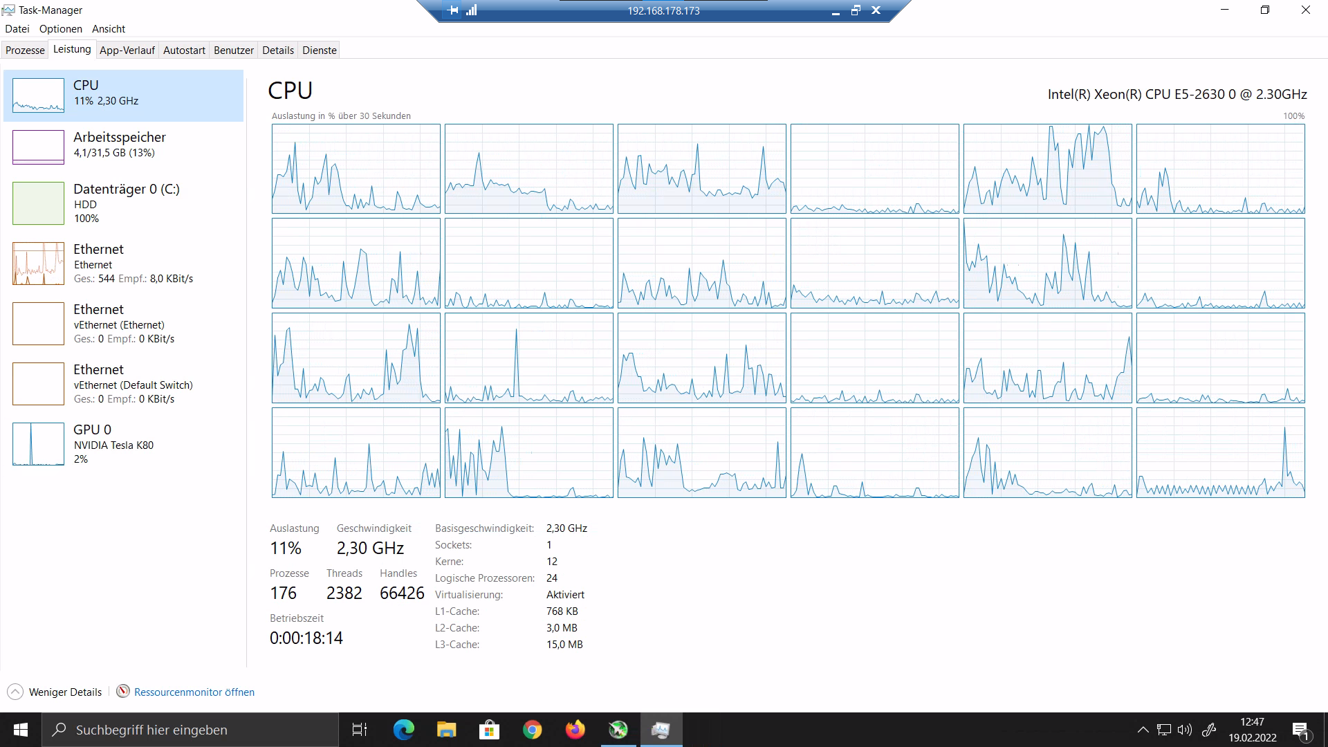

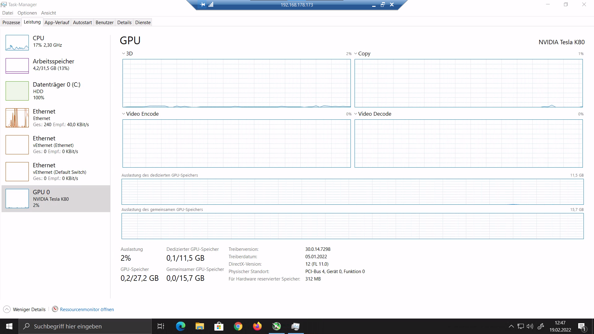

15 hours ago, ich777 said:
The next thing is I don't think you even can use one from the two cards in a VM because it doesn't even have a display output and from what I know display drivers won't install properly in VMs, but I could be wrong about that...
You can use this card in a VM because I do. There is a little trick on how to do it, but nothing too complicated. Because it's a computing card, you need to put it in WDDM mode, but it works.image.thumb.png.47862b7d93a1735fabb3bab802de5b9f.pngimage.thumb.png.29e4c1aa51394e0c1a8f337bf01f78e2.png

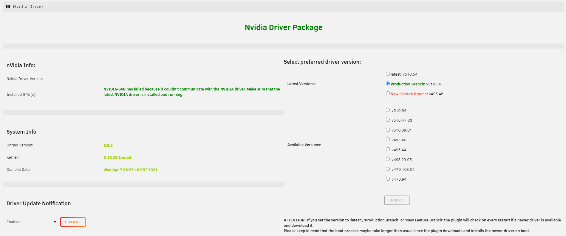

Hello!
I'm very new to Unraid so forgive me if there's something basic I'm missing here. I recently got everything set up and installed a Quadro P620 to use for transcoding with Plex. Everything was working fine! After I rebooted, however, I saw that the Plex Docker wouldn't launch any longer because of an invalid parameter call to load with nvidia support. Looking in the plugins tab, I saw that the Nvidia-Driver plugin was no longer listed as installed and under the Plugin File Install Errors, there was an entry with "/boot/config/plugins-error/nvidia-driver.plg." If I re-install the plugin, everything works fine until I reboot again. Any idea what might be going on? Attached diagnostics after my most recent reboot. Any help would be VERY much appreciated.
EDIT: Was just looking through the logs. It looks like it realizes that it already has the desired version downloaded and installs it. Then after the NIC initializes, it attempts to download the driver again and fails. Would this lead to the situation I'm in? Any idea why this might be happening?
tower-diagnostics-20220308-1349.zip
Edited by Zoidoid
Where did you see that?
The plugin basically installs itself and then tries to download the driver package.
i really don‘t understand why that is happening on some systems because the driver is actually downloaded when you install the plugin for the first time.
58 minutes ago, Zoidoid said:
After I rebooted
Please try the following, delete the plugin from the failed tab within the CA App, reboot your server, install the plugin again from the CA App, try to reboot again and see if it is working.
Male also sure that you have enough space on your USB boot device.
Have you waited until the plugin finished downloading the driver package and waited for the Done button to appear?
Once the package is downloaded and no internet connection is available on boot the plugin will search for local available driver packages and install the appropriate package but that didn‘t happen in your case.
Thanks for this advice! Everything seems to be working as expected now. I didn't read the settings carefully enough originally. I didn't realize that selecting an option from the top few versions forced it to download rather than use the pre-downloaded version. Why the download failed is a little bit of a mystery to me -- I think it might be an order of operations thing where my network interface isn't ready by the time Unraid wanted to try to download the driver? Regardless, I'm happy for it just to use the perfectly-functional driver that's now on the usb stick. Appreciate the help!
No, that's not how it works, it tries to fetch the latest version and if this fails it searches for locally predownloaded packages and if a package is found it will install the predownloaded one.
Even when your network is not available at installing the drivers and a predownlaoded file is found it will be installed, regardless of the selected version.
