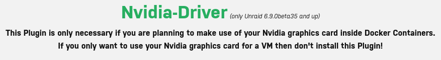

[Plugin] Nvidia-Driver

41 minutes ago, comet424 said:
i used to have a nvidia card in there... for passing VMs  but it burned out...    and figured i needed the driver for my card...
but i 100% never noticed any improvements  using the unraid nvida driver when i had a nvida card in for my VMs
No definitely not, if you use the card in a VM then not, see the first post in this thread:
42 minutes ago, comet424 said:
and if it doesnt help vms  when  do u need the driver for unraid itself?
I would recommend to uninstall it because it slows down the boot because well, it has to install the driver on each boot.
ah ok  i dont remember reading  that  in the Community Apps page back in 2020
and normally  when i goto support page  i just goto to the end..  i guess i should read the first page i guess. my bad
so what dockers use a graphics card?
