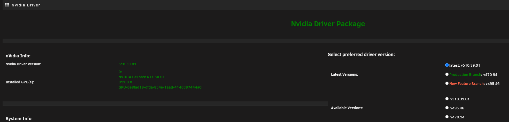

Hello,
I got the notification about the Nvidia 510 driver and I rebooted Unraid to install it. Looking at the last few messages, it appears that was a mistake. Now my instance doesn't boot. Is there a way to revert the installed Nvidia driver?
Joe Schroedl
1 hour ago, Jschroedl said:
Hello,
Joe Schroedl
You can select the driver.
settings>Nvidia Driver>Select preferred driver version

3 hours ago, david279 said:
I only ask because someone said their machine would not boot after updating.
As you can see from the screenshot from me and @alturismo we are both on this driver version.
The boot issue can be caused also by something else but I have not heard back fron the user yet.
