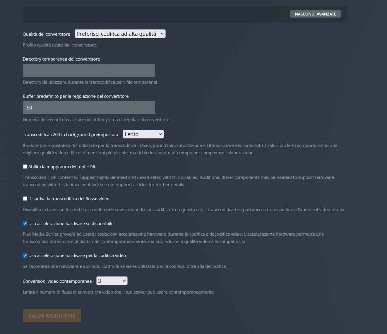

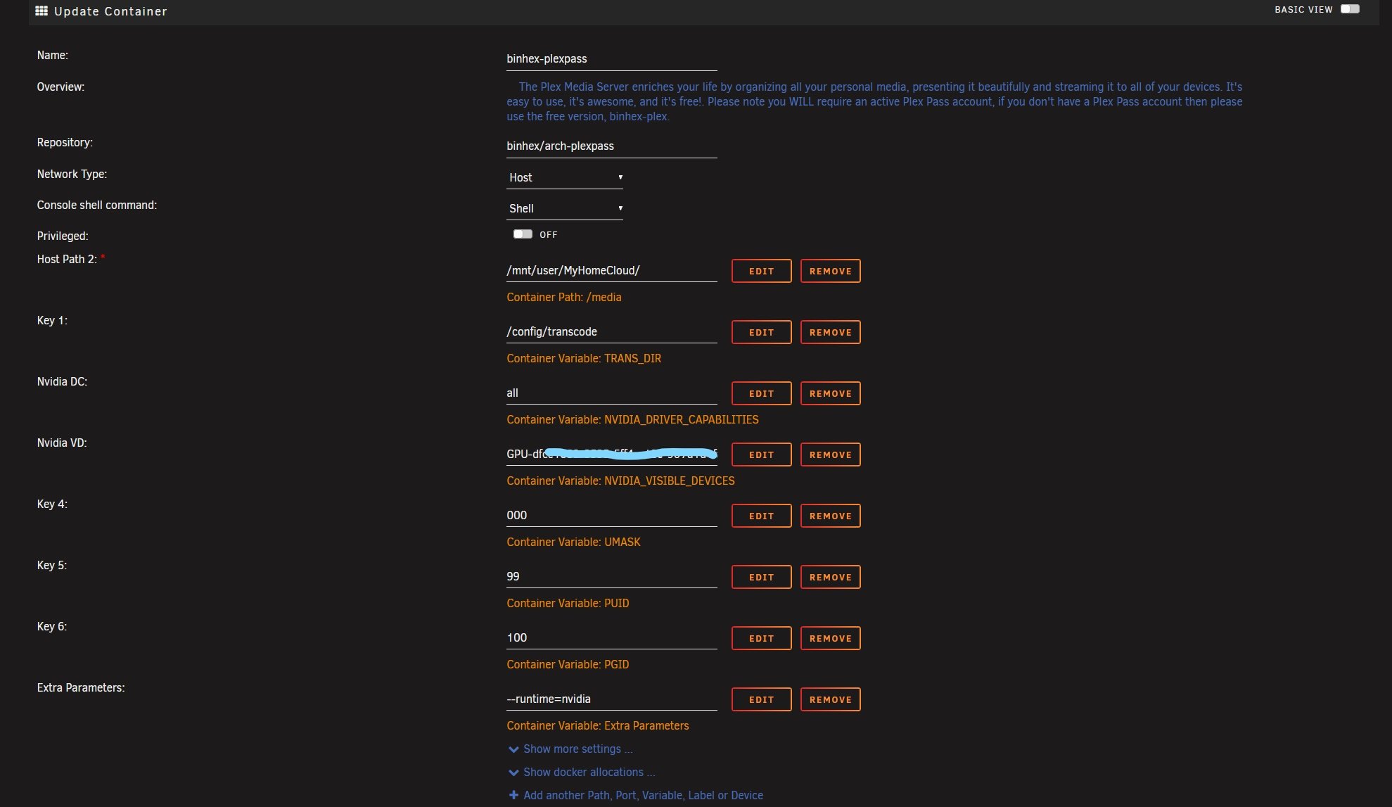

Please post a few screenshots from what you did so far (container templates & Plex settings) please, this would be a good start, have you enabled HW transcoding in the Plex settings and also created a Plex Token?
Ok, I attach screeshot, what do you mean by Plex Token?
You did the '--runtime=nvidia' wrong, please look at the second post of this thread again.
36 minutes ago, Fastbobo said:
attach screenshot,
You do not create a variable called Extra Parameters.  It is already part of the template.  You must turn on Advanced View (Basic/Advanced View toggle) in the container template to see it.
Since I have an Intel CPU with an iGPU I use that for transcoding as seen below.  You need the --runtime-=nvidia in Extra Parameters.
Thanks a lot, the problem was the extra parameters, my mistake, thanks again!

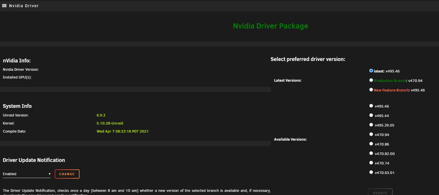

Hello, struggling to get this installed with a P2000. It is supported by the latest driver so really not sure what the issue is atm.
 991550024_Screenshot2021-12-29at12_44_21.thumb.png.031f5385b79f200a98736d99d0084ee6.png
I tried with a GT 710 which works just not the P2000. Any ideas what could be causing the issue?
Any help would be greatly appreciated
server-diagnostics-20211229-1246.zip
You have bound the card to VFIO from what I see in the screenshot and also in the Diagnostics.
If you bind it to VFIO the plugin can't see the card, please unbind it from VFIO and reboot your server. After that it should see the card, if not please post your Diagnostics again.

Cheers that was the issue

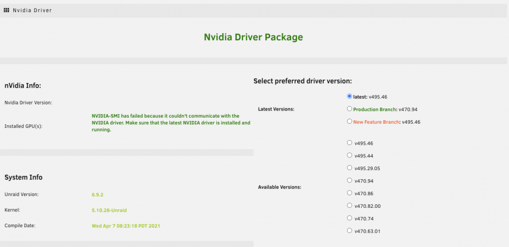

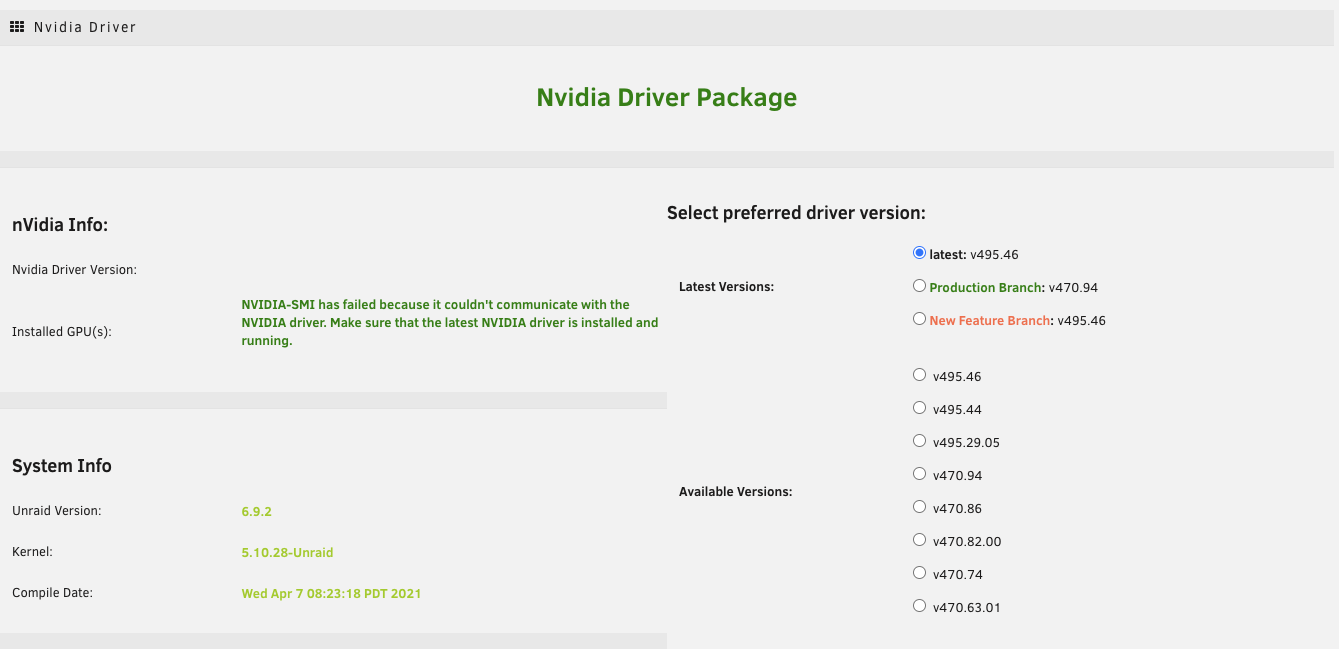

I have a brand new 3060 that I just put into my new unraid server. Had an older 6GB 1060 that was in there and it worked okay, but wanted more power. Unraid doesn't detect the 3060.
Any thoughts?
Nvidia drivers updated and v495.46 is loaded. Nvidia driver plugin shows this error.
"NVIDIA-SMI has failed because it couldn't communicate with the NVIDIA driver. Make sure that the latest NVIDIA driver is installed and running."
This is a supermicro server mobo.
3060 was in a Windows 10 pc for a week or 2 so I know it works.
Without the Diagnostics I really can't tell anything.
Have you turned on Above 4G decoding in the BIOS also enable resizable BAR support if you have this option in your BIOS. Most of the times it seems like it's incompatibility between the hardware (Motherboard & Graphics Card) or a BIOS issue of some kind.
Looks like the Above 4G decoding in bios fixed it.
