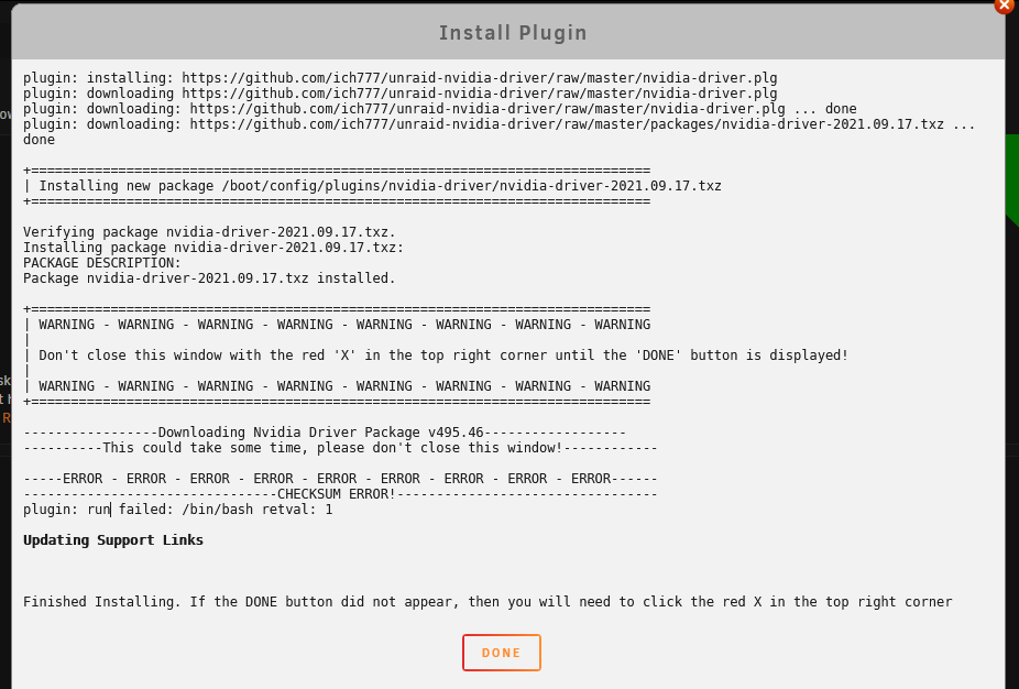

Hello, I have being using this driver for like a year or so, and was working correctly until today.
I have and old 750TI card, but for my plex configuration was sufficient, I add a new drive today so I did a restart, and after that I'm missing the NVIDIA driver and everything.
If I try to install the driver (I did several times) I get...
Downloading Nvidia Driver Package v495.46------------------
----------This could take some time, please don't close this window!------------
--------------Can't download Nvidia Driver Package v495.46-----------------
plugin: run failed: /bin/bash retval: 1
After that I see the Nvidia menu in settings (not in plugin) and if I go inside there is an empty space in the graphics part and if I select any other version I cant force the download, and after the restart there is nothing related to nvidia anywhere.
tower-diagnostics-20211221-2228.zip
Edited by Curros
Have you changed anything else to your server than adding a disk?
Do you run any AdBlocker like AdGuard or PiHole somewhere in your network?
Please go to your Plugins page within unRAID and see if you got a Plugins Error tab and uninstall the Nvidia Driver plugin from there, after that try to install the Nvidia Driver again from the CA App, if you got an AdBlock installed try to disabling before you pull it from the CA App.
Something really strange is going on on your system... My best bet is that the plugin is in the Plugins-Error tab.
Just for testing, can you donwload this file: Click
(this is the file that the plugin tries to download and is failing for you, tried it now and it downloads just fine)
No I dont.
The plugin was in the error tab, and I just delete it :D
But now I get different error (image below)...
I did a full restart (router, switchs, everything in the network), I also download the file in my computer and I could, so I'm kind of lost....
PD: Brainstorming, could be an issue with the driver version, I mean, my card is kind of old 750ti, I'm not sure v495 will work with that.
1706388462_Capturadepantalla2021-12-22111829.png.391aff5cc37dbc5663bc415e261f449b.png
That was the main issue why it wasn't installing.
How quick was the download? It should be 200MB in terms of size. The checksum error means that something went wrong with the download.
That has nothing to do with the card itself since the download fails.
Also your card is supported, go to this page and click on "Supported Products" and you will see that the GTX750ti is supported.
How long does it sit there after you get the error message?
Do you have enough space left on your USB boot device? Have you also checked if the DNS servers are correct on your unRAID box?
Do you have AdGuard, PiHole or something similar installed somewhere on your network?

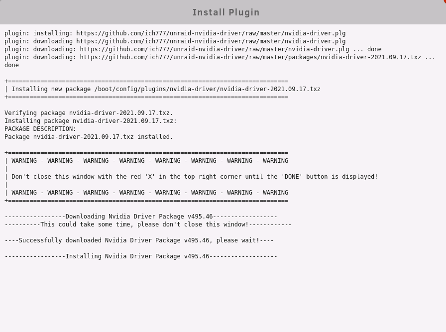

EDIT: I have tested it now on my other server (that is on 6.9.2 and even has no Nvidia card installed) and it works just fine, must be some kind of network issue in your case:
(made two screenshots because it won't fit on one...)
You are not going to believe it, before your message, I see a yellow ribbon in the CA App saying that the store was running on backups servers (was not there before!)
I just reload, and now that ribbon doesn't appear, and try the install again, and voila its working.
I cant thank you enough, you are the best!
PD: DM me and I will invite you a beer.
