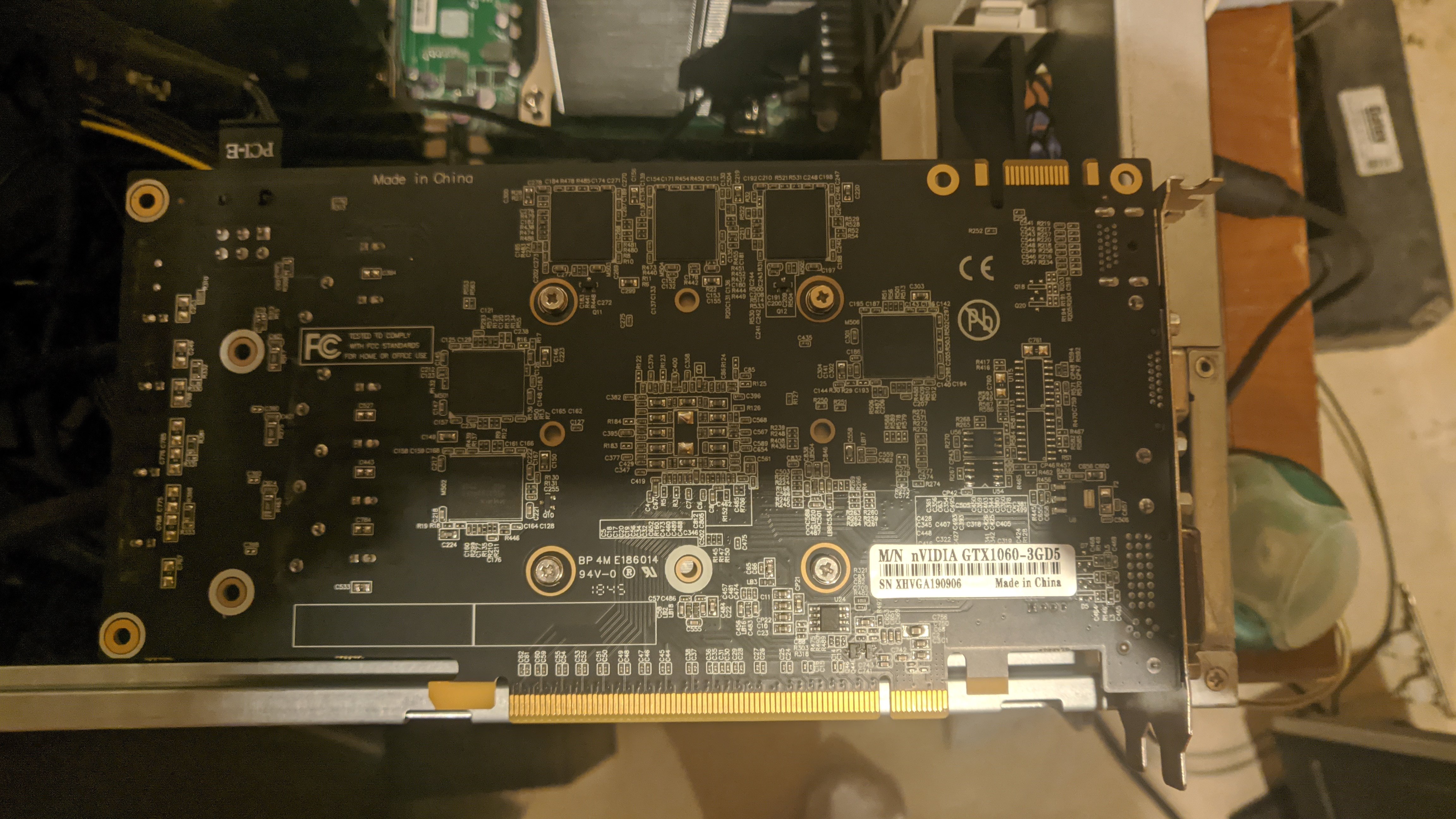

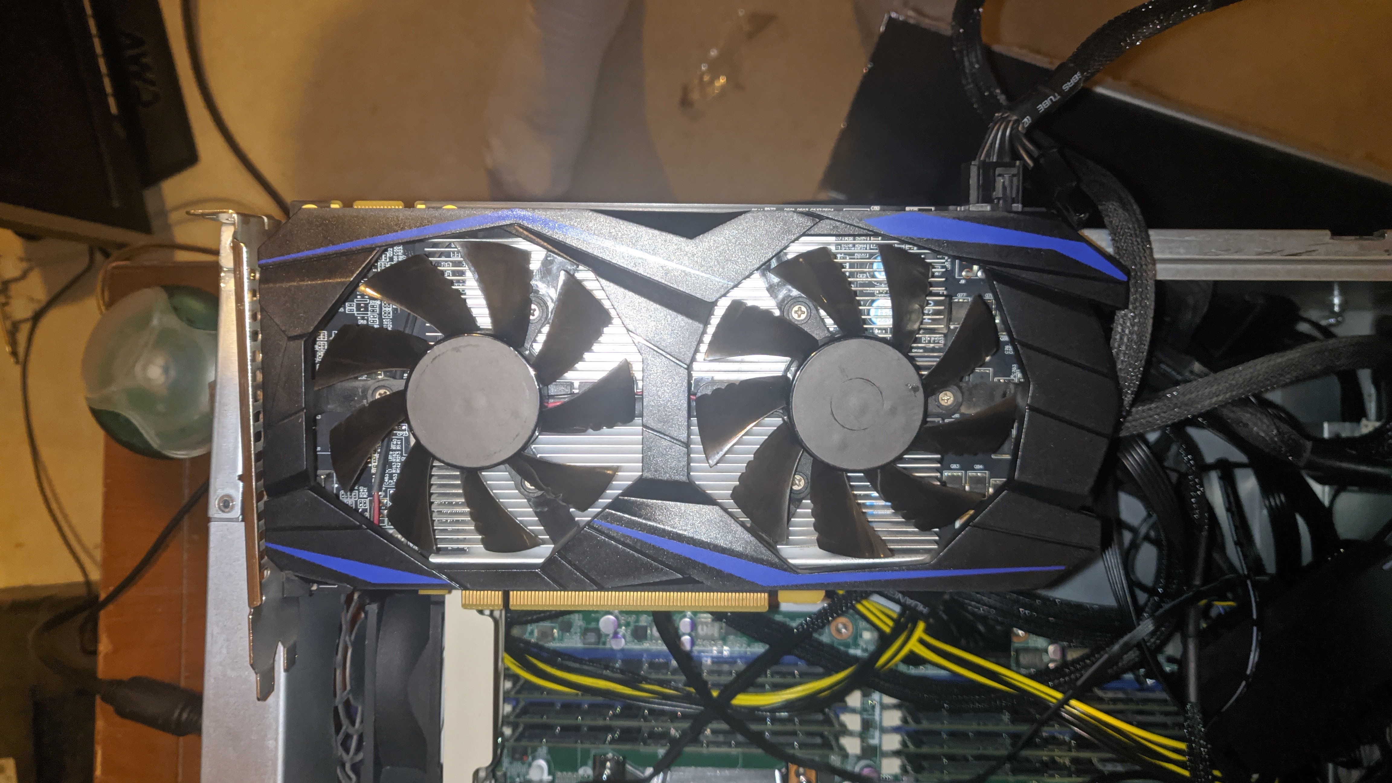

I'm running into the NVIDIA-SMI has failed issue with a used GTX 1060 I just bought off ebay. The thing appears to work. I can get a display out of it for unRaid. I'd like to use it with Plex and tdarr is my goal. Both Docker containers. I looked it up and it should be compatible. I'm currently on driver v470.86 because I wanted to try something different but I'm about to go to the latest again and reboot with nothing (including dummy plug) in the back of this card. Thinking maybe it's something in my BIOS? I'm not sure I haven't used a GPU in 2 decades. I appreciate all the help I can get.
03:00.0 VGA compatible controller: NVIDIA Corporation GP106 [GeForce GTX 1060 3GB] (rev a1)
03:00.1 Audio device: NVIDIA Corporation GF116 High Definition Audio Controller (rev a1)
M/B: GIGABYTE GA-7PESH2 Version 00000001 - s/n: 0123456789AB
BIOS: GIGABYTE Version R17. Dated: 06/26/2018
CPU: Intel® Xeon® CPU E5-2660 0 @ 2.20GHz
unraid-diagnostics-20211120-1805.zip
unraid-diagnostics-20211120-1846.zip
Edited by pinion
This seems like a counterfeit card to me since the audio controller is a GF116 (Fermi Architecture - GTX 500 series).
Does this card also have VGA on it? Not 100% sure from the pictures but this is also a indicator that this is not a Pascal (GTX 1000 series) based card.
I would recommemd that you watch out for a Nvidia T400 you can get them brand new for about Eur. 130,-
In terms of transcoding it is as good, or even better than a GTX 1060 and more efficient.

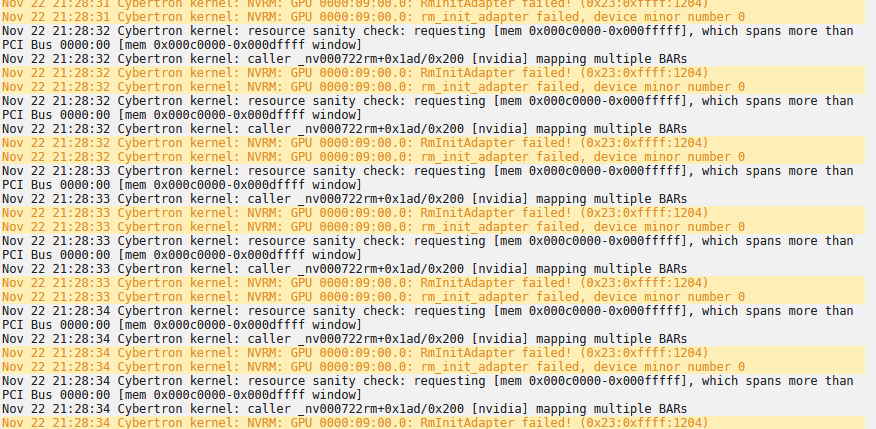

So I finally fixed my RTX 3060 Ti disappearing by just buying a damn new computer :D Went with an Asrock X570 and an AMD 5950X and now it all works.. Maybe it was just some hardware issue. but it's nice to be able to use this now without it disappearing :)
OK so it happened again and I think I know why. When the setup runs headless, this happens.
I just had my HDMI cable in my video card and it was working fine for a few days. Today I'm building a pfsense router and i took out the HDMI cable to plug it in to my pfsense box. That's when unraid starts giving the can't init adapter error and the nvidia card disappears.
I might just buy one of those HDMI ghost plugs to see if that works, but I think if there's nothing plugged into the RTX 3060 Ti,  after a little it'll just fail to be detected.
Nope... it's happening even with it plugged in.. i give up. :)
OK Maybe it's because I turned off the monitor.. I'm keeping the  monitor on to see if it stays working....  So far so good..
Edited by HellraiserOSU
OK, so this seems to be it.
As long as I have the monitor plugged in and on, it's fine.
After a minute or so when I turn off the monitor, those RmInitAdapter errolr happens.. and when I turn the monitor back on, nothing comes back on the screen.
So maybe it has something to do with how it goes to sleep and can't wake itself up? Maybe I will order that headless ghost plugin and try.
