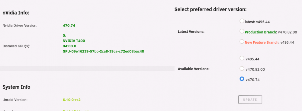

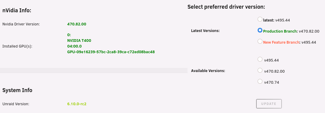

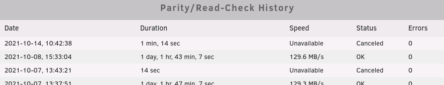

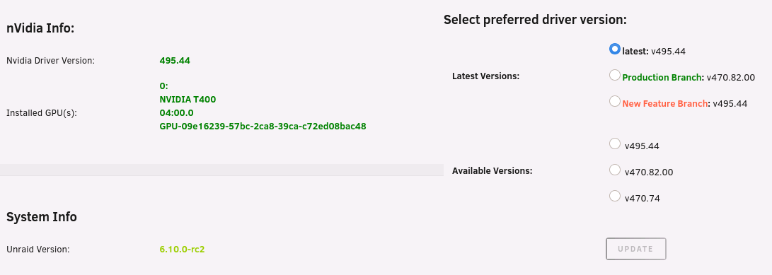

40 minutes ago, wildfire305 said:
No rush

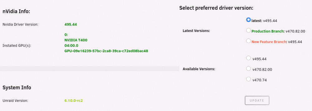

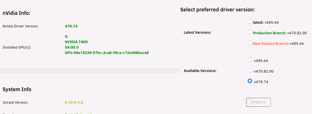

Tested it now and had no Parity Checks or whatsoever.
Downgraded from 495.44 to 470.82.00:
Then downgraded from 470.82.00 to 470.74:
And lastly upgraded again from 470.74 to 495.44:
Here is also the Parity History (please ignore the canceled ones that I did about half a month ago, I did that by accident... :D ) :
Are you sure that you don't have a SSH session or something similar open? This also could lead to a unclean shutdown.

But as you can see from the screenshots, no parity check was triggered in between the reboots.

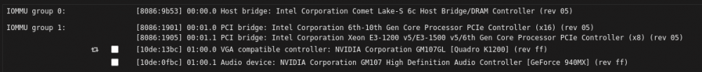

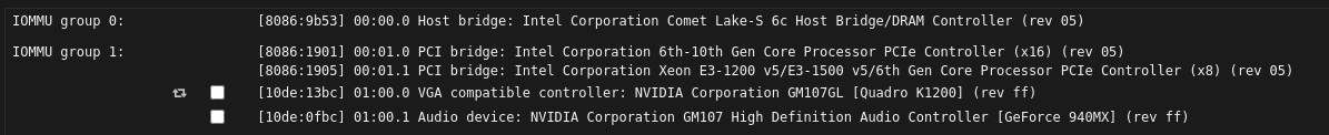

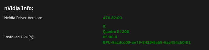

After a random crash today on my unraid server, powered back up to find one of my graphics cards not being recognised.  I've had this setup running for several months without any issues what so ever.
The nvidia plugin is showing only a single card, but lspci and unraids system devices shows both.  nvidia-smi only shows one card.  I have swapped in a spare card as I originally thought the card had failed but that's not the case.  Bios update to the latest as of today also no success.
Some hardware background
Motherboard: Gigabyte Z590 UD AC (F2 original bios, updated to F5)
2 x nVidia Quadro K1200's
Unraid Version: 6.10.0-rc2 (has been working without any issues for several weeks on this version and rc1 prior to that)
Nvidia driver version: Was running latest (v495.44, tried downgrading to v470.82.00)
Nvidia plugin output (attached)
System tools/devices (attached card 1 and 2)
I'm not sure what caused the crash, this has happened twice in the last couple of weeks but this setup has been fine for months.
/proc/(etc) only shows a single card which is as per nvidia plugin.
Any suggestions would be greatly appreciated.
Edited by Wingede
Please post your Diagnostics, otherwise I don't have any clue what the plugin or better speaking the driver is doing.
3 hours ago, Wingede said:
Another update: Windows recognises the card but with error 43, updated drivers and reflashed the card and still not working.  Put it in the other slot and working but this doesn't help long term.
So the second K1200 is not working in Windows if I understand that correctly? Have you tried this in a VM or in another physical computer?
Yes but this is from your logs:
Nov  8 20:13:22 aV4 kernel: nvidia 0000:01:00.0: enabling device (0000 -> 0003)
Nov  8 20:13:22 aV4 kernel: nvidia 0000:01:00.0: vgaarb: changed VGA decodes: olddecodes=io+mem,decodes=none:owns=none
Nov  8 20:13:22 aV4 kernel: NVRM: The NVIDIA GPU 0000:01:00.0
Nov  8 20:13:22 aV4 kernel: NVRM: (PCI ID: 10de:13bc) installed in this system has
Nov  8 20:13:22 aV4 kernel: NVRM: fallen off the bus and is not responding to commands.
Nov  8 20:13:22 aV4 kernel: nvidia: probe of 0000:01:00.0 failed with error -1
Seems like your card is not responding and this means basically for the driver that it has fallen from the bus.
Keep also in mind that hardware can fail over time, I don't want to say that the card is defective but I would like to keep in mind that it can happen.
This should make no difference because your card is supported on the latest drivers anyways.
My suggestion would be to put the card in another computer and try if it is working there, but also keep in mind that you have to install the Nvidia drivers on that other machine because the basic display output is working most of the time without a problem, only after installing the driver and putting a 3D load on it you will see if it is fully working.
Thanks for going through my logs.
Windows or unraid in that primary pcie slot the os's are always able to see the card but not functional, windows shows error 43 and you get the picture from unraid.  I have 3 of these cards and thought it might be a faulty card (as they are getting old).  Moving that initial card to another slot everything worked fine but re-using that primary slot regardless of card used I have the issue.
Going to just a single k1200 card in the system hasn't made any difference even with bios update and reset to defaults etc.  Moving that particular card to another other slot everything works as expected (tested some transcoding operations).
I think it is pointing to a motherboard issue (this is the second one since purchasing, bad luck as the first one had a faulty LAN controller on it - well wasn't faulty, dead is more appropriate).    I just hope I haven't pushed the boundary on the motherboard by using 2 k1200's (would think not).
Regards and thanks again for parsing my logs.
I only have a few suggestions that you can try:
  • Enable Above 4G deconding in the BIOS
  • Change from UEFI Boot to Legacy and vice versa, depending on what mode you are booting with now
  • Manually set the PCIe Gen for slot one to Gen3 or Gen2 (would not make much of a difference in terms of performance for this most cards anyways)
Also saw that you are using a Gigabyte motherboard from which I am not a huge fan of because they gave me also troubles in the past and also I read recently a few posts about fault Motherboards, not working/correctly working HPET timers, various BIOS issues... :/
Tried the above changes and no difference.  I will go down the RMA process with the supplier again ;(.
What motherboard manufacturer do you recommend (for future reference)?
This is completely subjective I have to say, but I never had problems with ASUS or MSI.
Maybe it's also some BIOS or hardware compatibility issue...
