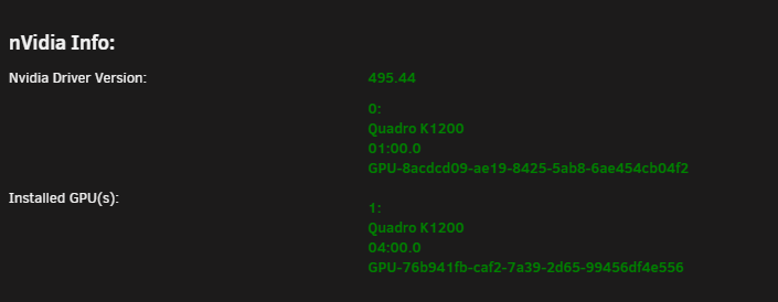

My configuration has always been card 0 for docker and card 1 for a Windows based VM.  This has been running on 6.9.x for ~6-8 or so weeks before upgrading to 6.10-rc1, then recently rc2.  Same hardware etc.
Where I mentioned Windows seeing the card but having the error 43 issue was when I booted the entire system into a windows native installation with just a single card in the primary slot.  This was an attempt to see if it was linux/unraid related or narrowing down hardware.  I haven't booted native windows since.
I will look to update back to rc2 and see what happens.  Perhaps there is some compatibility issue with my motherboard and kernel 5.14.  What I don't understand is that it was running rc2 for a couple of days at least before it all went pear shaped.  I will report back later on in the week as I need the system running and curious to see if it is stable for a few days.

unRaid console uses iGPU, docker specifically uses the first k1200 for doing transcodes for emby or plex.  The second k1200 doesn't do a heck of a lot but is passed through to a Windows VM which I use for different things, some cad stuff when remote/being lazy ;).  I probably could just use the igpu for emby transcodes but I have the cards.

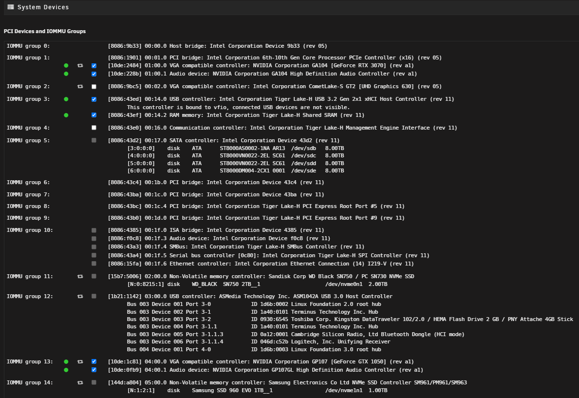

7 hours ago, yakboyslim said:
I am still unable to get a second GPU working in my computer. Contacting Asrock support has led to them telling me that two nvidia cards is not supported,

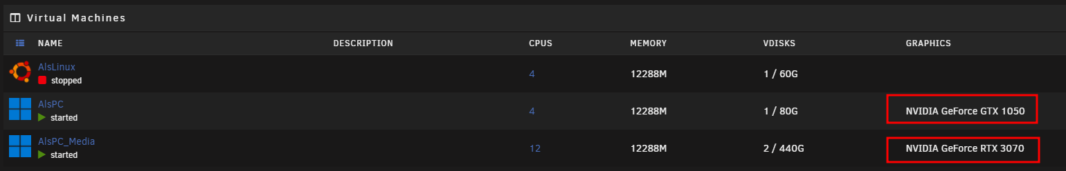

but i have a z590 board with a 10850k CPU, i also had to vfio bind the cards to get them working (even igpu is as primary set), when using CPU based slots i also had to use ACS override both to get them properly seperated in iommu.
as the 1050 is desktop usage only i settled it in the PCH based x16 slot (running x4 mode) but leaves the gaming mashine untouched with x16 and rBar active, didnt tested further now if there is a collission with rbar when using both gpu's in CPU based PCI slots.
may post a screen from your iommu's
and drop a note what board exactly and which slots you tested, also as sample, i have to disable the z590 wifi device so it wont brake the USB slots etc ... may disable the devices you dont need in bios too.

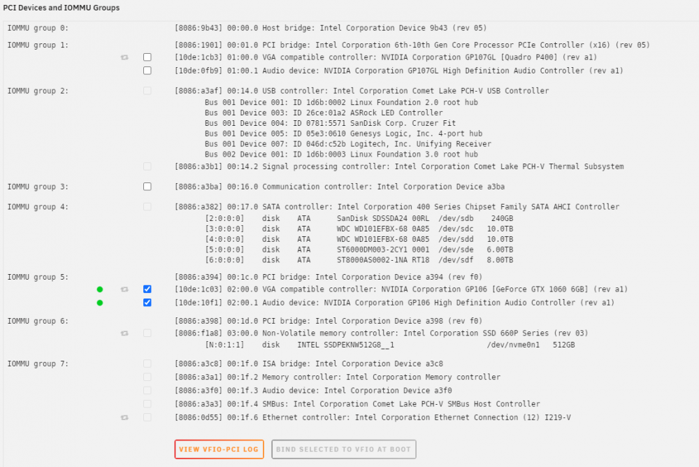

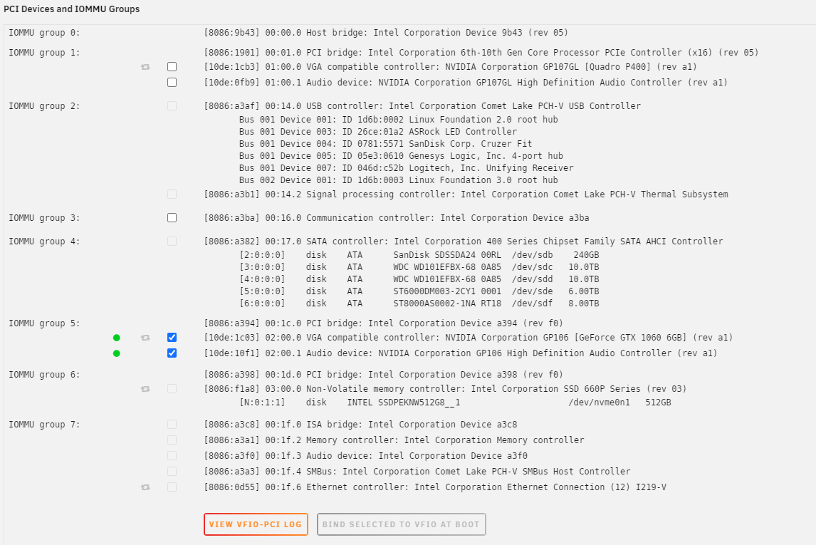

Its an ASrock B460 Phantom Gaming 4. I currently have the Quadro P400 in the upper x16 slot (CPU lanes) and the GTX1060 in the lower x16 slot (PCH running at x4 I believe) But that is just the arrangement that I stopped troubleshooting on, I have tried both slots, with every combo of VFIO I can think of.
Currently the GTX1060 is VFIO since the hope is one day to pass that card to a VM while the P400 is used by docker containers. I have tried a few different ACS override settings with no effect. When I try to start my VM (currently a Ubuntu 18.4 server) it fails to start with the error "Execution Error: Internal error: qemu unexpectedly closed the monitor"
If need be I can rerun the diagnostics, but I have included the diagnostics for how it is currently (GTX1060 with VFIO binding).
And what is not working exactly?
The P400 is recognized by your system and you should be able to use it in Docker containers.
The 1060 is also recognized by your system and should be also ready for usage in a VM.
Do you want to pass through the card to a Ubuntu Server?
Please remember if you bind the card to VFIO the card won't show up in the Nvidia Driver plugin.

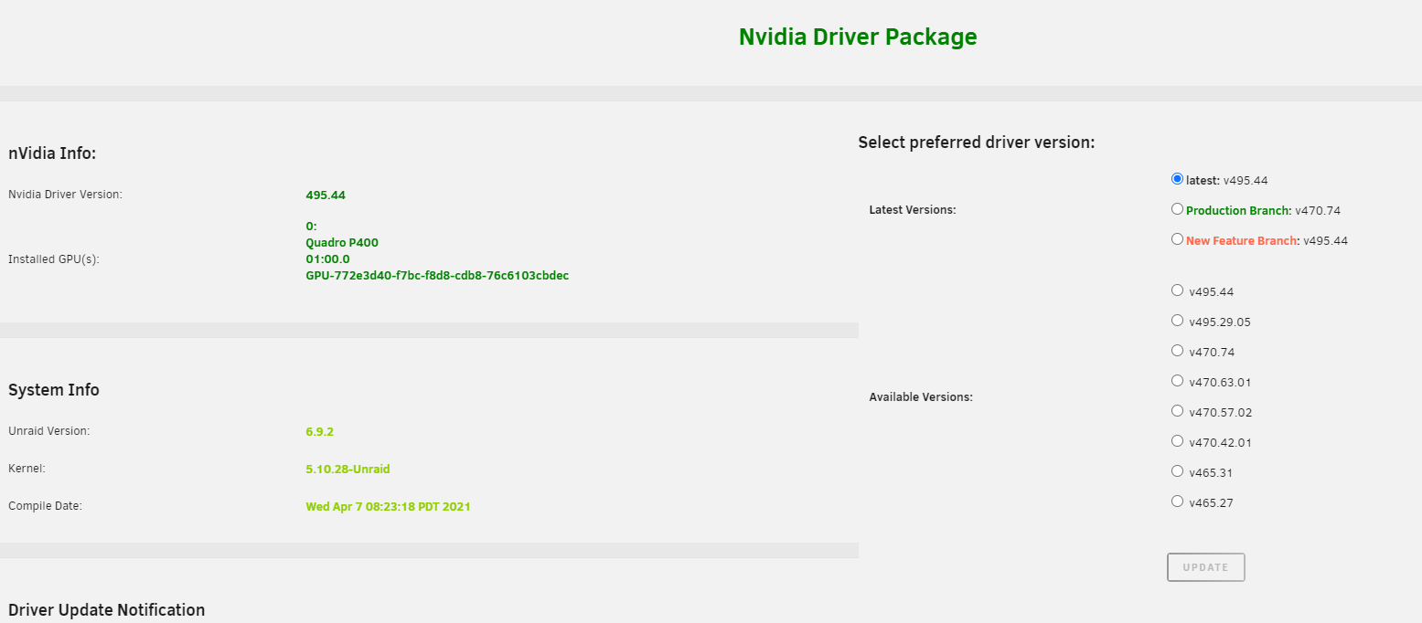

Nvidia is advising I try driver version 470.82.00. This is not an option for me in the Unraid Nvidia plugin. They included some instructions for manually installing the drivers to slackware, and disabling noveau. Is it advisable to follow those instructions or will it play nice with the unraid nvidia plugin?
Please try the following, nvidia manual driver installation.
First please remove previous driver installation attempts.
If you installed using packages, remove with the package removal tool and reboot.
If you installed manually, remove with: sudo /usr/bin/nvidia-uninstall and reboot.
Then use the instructions here: https://docs.slackware.com/howtos:hardware:proprietary_graphics_drivers
search for 'Installation via the nVIDIA Binary'
follow the instructions to disable nouveau by creating a text file in /etc/modprobe.d/  and reboot before installing
No. From your Diagnostics I see you are on 6.9.2 right?
I will compile the package for you and will report back when it's done.
I am on 6.9.2. You rock, thanks so much for all the help
Please go to the Nvidia Driver plugin page and you now should see the driver 470.82.00, if not wait at least 5 minutes and go again to the Nvidia Drier plugin page and then it should appear in the list.
I would recommend this steps:
  1. Select driver 470.82.00
  2. Click "Update"
  3. Then click on "Download" (keep in mind this can take some time and wait for it to say that it's finished)
  4. After the Download finished reboot your Server
