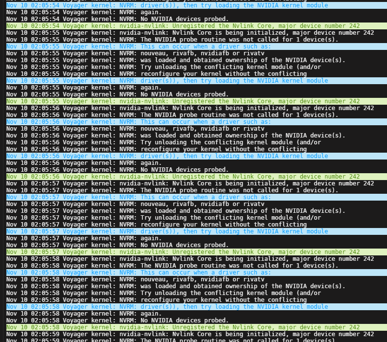

5 hours ago, yakboyslim said:
Complete. Still not working, but at least Nvidia knows I am on the most current and maybe can troubleshoot further with them as well.
Got it working finally. Rolled back my BIOS version from 1.70 to 1.40. Took me forever to get it to boot, but eventually found out CSM is broken in this older BIOS version.
Disabled CSM, unraid booted fine and everything works now! So apparently Asrock broke multiple GPU in an update at some point. Either way, I have one GPU working in dockers, and one passed through to the VM and everything else seems to work as before!
Thanks for the help! Now to learn all these other PCIE passthroughs...

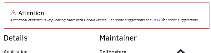

  • Do you have the GPU Statistics plugin installed?
  • Do you still use Tadarr currently to convert files?
  • Do you still use any other container that uses the card when the VM is not turned on?
1 minute ago, ich777 said:
No, that's for example one thing why I don't recommend using one card with Docker and VMs, but I think you are running into this issue because of something else.
I understand, my other card is an AMD and its not great for gaming, hence using my Nvidia card for pretty much everything.
  • Do you have the GPU Statistics plugin installed? Yes
  • Do you still use Tadarr currently to convert files? Tdarr and Tdarr node dockers are installed but both are turned off and not set to auto run
  • Do you still use any other container that uses the card when the VM is not turned on? No

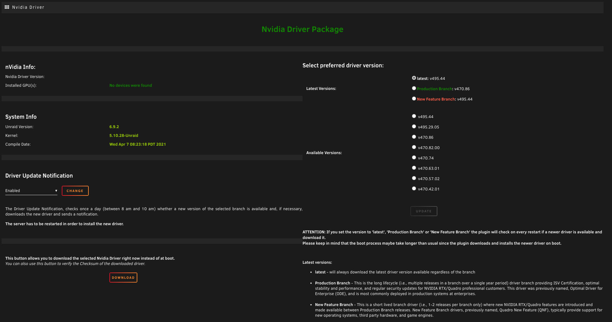

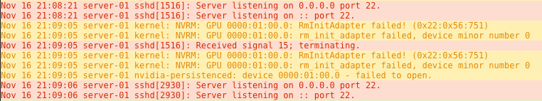

I know it is not officially supported but I am running Unraid in a VM on Proxmox and passing a Quadro P400 to Unraid.
The Device is correctly appearing unter system devices but the Nvidia Driver ist not detecting it.
'Nvidia-smi' is also outputting No devices were found
Anyone got any Tips?
(The GPU was working fine when I was running Unraid directly on the Host and the GPU is outputting the Bios etc. correctly so I don't thing it is a Hardware Failure. I switched the GPU to another Pcie slot with no change.)
Thanks for any help
I’m using my GTX-1660 Super with the TDARR docker for transcoding and it seems to be working ok in my initial testing but this plugin doesn’t display any info while transcoding. Any suggestions for fixing this?
Thanks for any help
Please post you Diagnostics.

This seems like a issue from Tdarr from what I know, please see here:
Please also note that switching the branches in the Nvidia Driver plugin does nothing else then change the version in the config file from the driver plugin which is located on the USB Boot device.

When I woke this morning I noticed that my server was frozen again. Had to do another hard shutdown to resolve this (no access via web, ipmi, ssh).
Have you access to a display that is connected directly to the server. I'm really curious what causes this...

The TDAR docker was actually running and using the GPU for transcoding when I changed the setting initially. I wasn’t planning to do the reboot until it had finished but that didn’t work out.🤨
I think this is more related to Tdarr (issue linked above):
Have you tried Unmanic yet if this happens there too?
