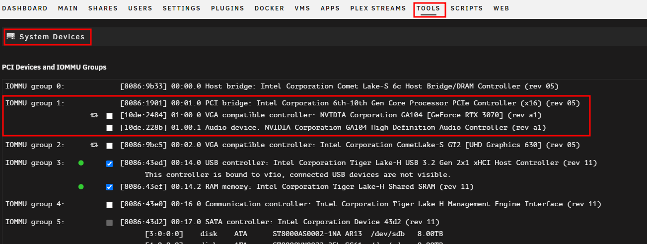

may post a screen from your vfio's from tools, system devices ...
sample
and i assume your card is currently NOT used by any VM.

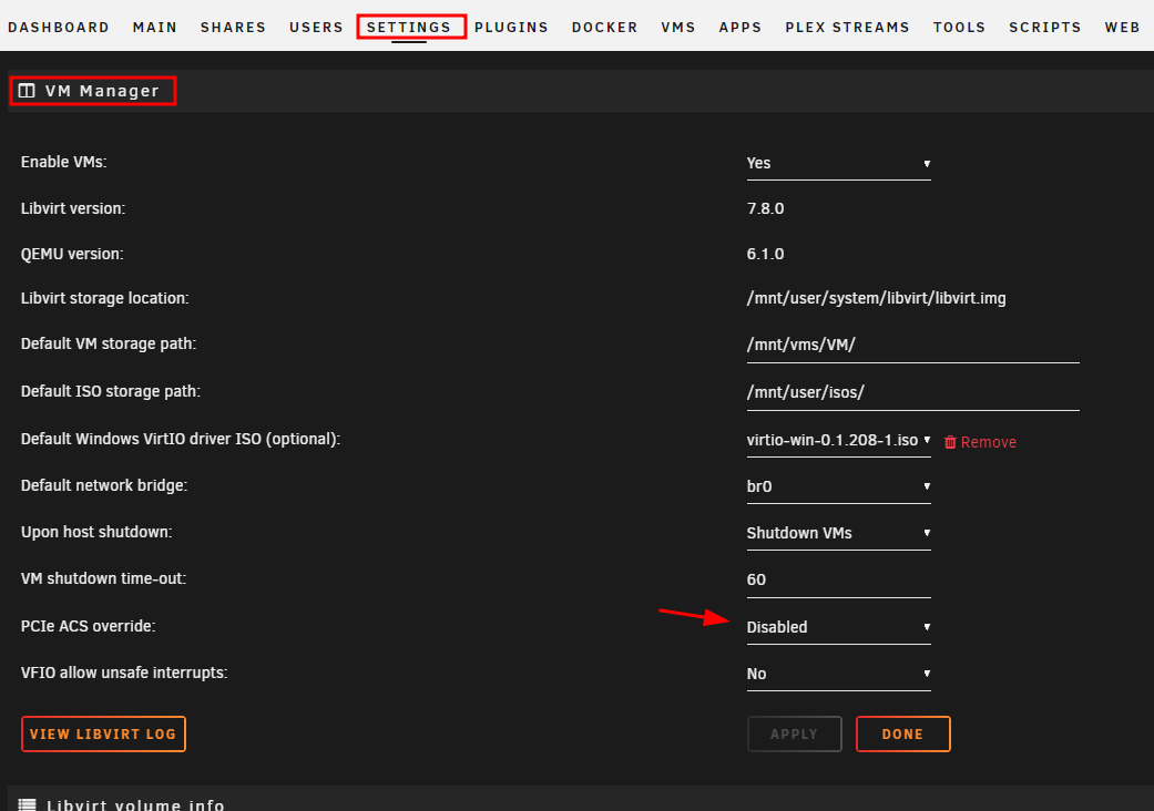

ok, then ... when i see your iommu, do use downstream, multi function as ACS Override ?
if so, may try turn this off
next would be, try another pcie slot on your board
also, take a look at the bios setting if you boot in uefi, may try change this (or vice vers)
not much more to say ... as it looks all good
how may one do this ? :D
if its disabled, keep it disabled, just looks almost like its enabled
best bet, try another slot and/or change boot type
yes it was disabled. i removed the extra 2 network adapter leaving only the 2 raid controller and placed the gpu on another one
