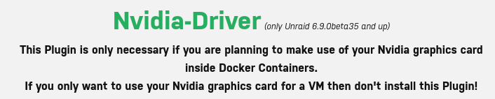

  • To utilize your Nvidia graphics card in your Docker container(s) the basic steps are:   Add '--runtime=nvidia' in your Docker template in 'Extra Parameters' (you have to enable 'Advanced

What do you mean with that?
The plugin isn't needed for VMs... (please see the first post in this thread)

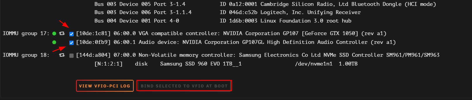

may to clarify, you are talking about your GPU usage in a VM, therefore you
- dont need this plugin, the nvidia-driver plugin is intended for Nvidia docker usage on unraid, not for VM's
- you should read up, use the VFIO bind in tools, system devices, assign it to your VM and thats it
then the card should be free and so on ... thats why its not really the right place here as this plugin is for a different usecase

Ah. Got ya. I did not realize the plugin was only for dockers. Didn't read the fine print, just assumed I needed it for a card to work. Sorry for the confusion. I'm still fairly new to unraid and VERY new to VMs. I will give VFIO bind a try. Thanks!

Hey. Yes, talking about just using it in a VM. Sorry for the confusion, I have not heard of VFIO bind until your post and assumed I needed the plugin for using a card. I was going off of Spaceinvader One's videos and dont believe he mentioned it in his VM videos (I could be wrong though). Will give this a try as soon as I get a chance. Thanks!
