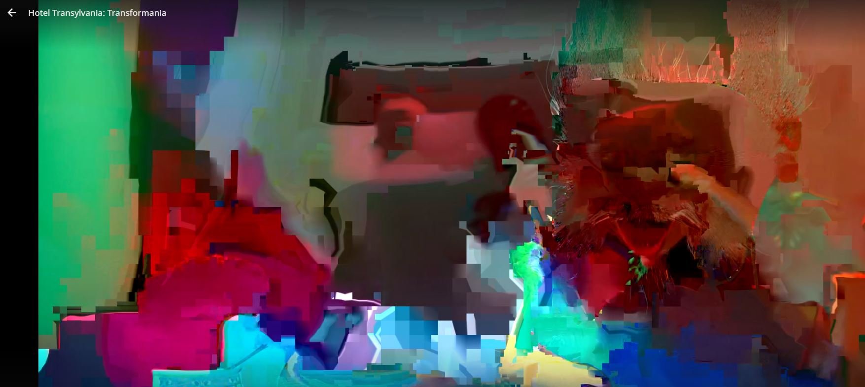

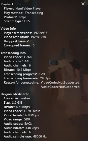

I seem to be having an issue with transcoding HEVC media - see images below. Could this be an issue with my graphics card or driver? I have a NVIDIA GeForce GTX 1050 Ti. I have tried the latest driver as well as the current production driver with the same results.
With HEVC transcoding disabled
With HEVC transcoding enabled
Transcoding Data
I think this has to be an issue with the card itself, but I could be wrong about that.
Then your CPU is hit pretty hard I think in terms of utilization or am I wrong?

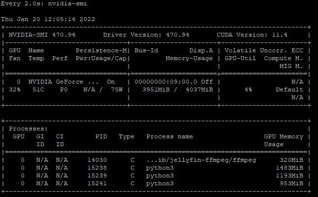

When transcoding can you try to open up a terminal from unRAID itself and type in:
watch nvidia-smi
What exact encoders did you set in the Jellyfin settings?
From what I see this a SDR movie and not HDR, there should be no issue transcoding these kind of files.
watch nvidia-smi
See below - this is with HEVC transcoding enabled in the Jellyfin options:
Currently how it is now (and I have the issue playing videos)... if I disable HEVC the video plays normally
Strange... I will need to find a way to try a different container... currently using Linuxserver but will look at switching to yours without a reinstall. I do have another 1070 graphics card in the server used by a VM so I could also try that...
May I ask what python3 application is using your card? Do you use it in other containers too? If yes, does it work in the other containers?
Yes and it seems to be working fine - the python3 app you see there is Deepstack

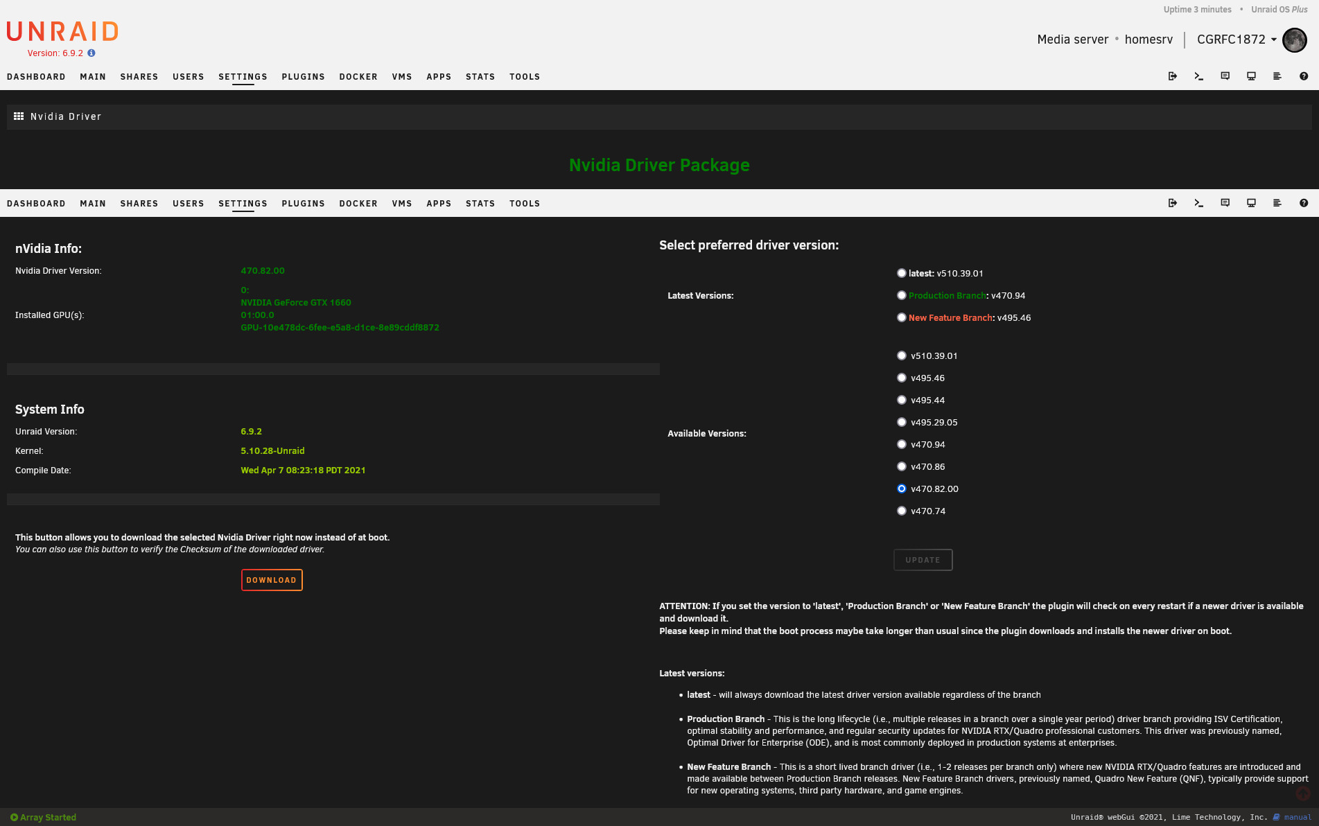

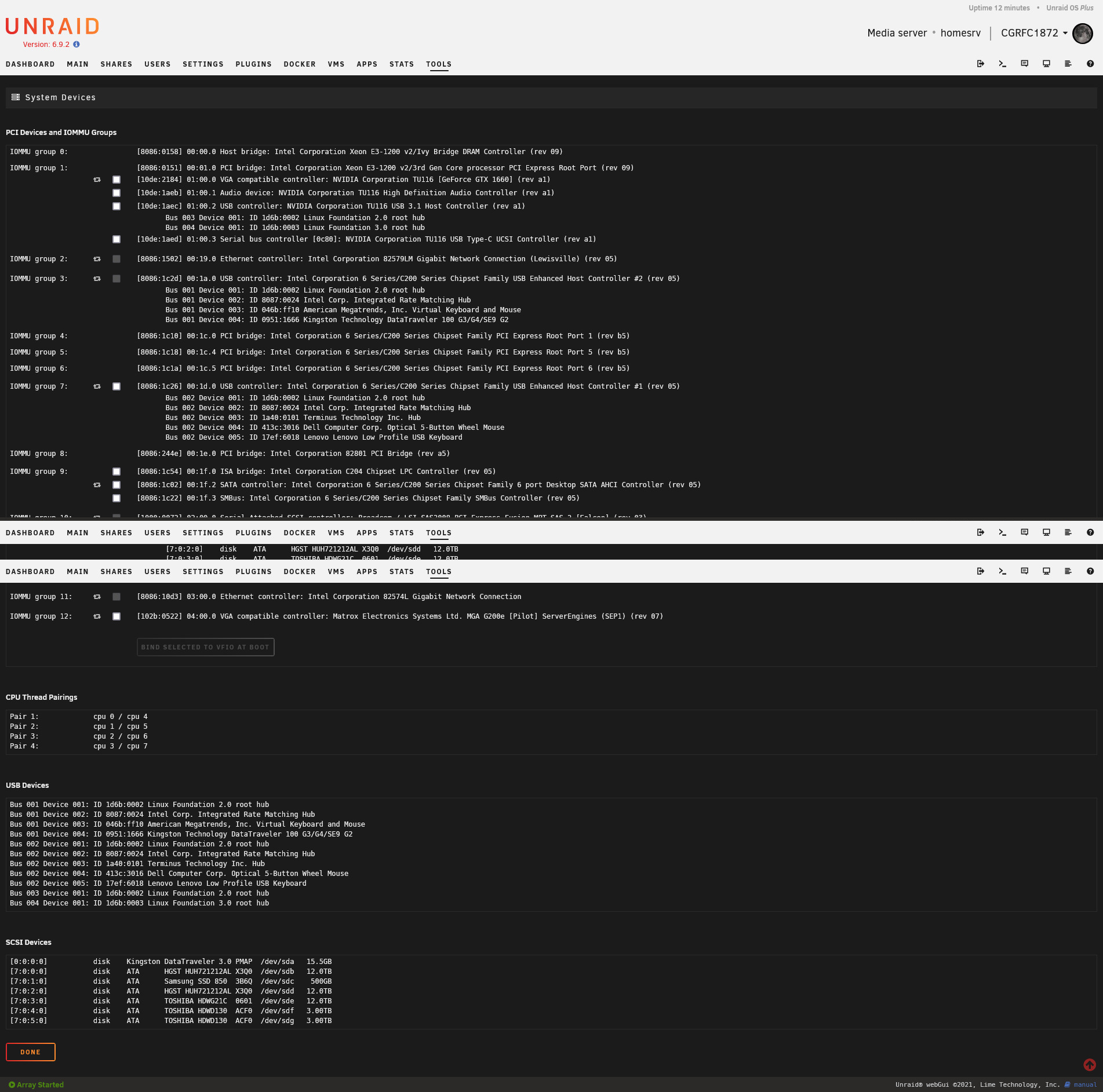

Hello,
My gpu is no longer showing in my nvidia driver after having to reinstall it after uninstalling all plugins.
As seen below it shows in the syste devices (at the top (GTX 1660)) But it doesnt appear to show up in the unraid driver.
I have plenty of storage on my usb so find this a little strange and i always disable my ad block (unraid uses a different dns server anyway)

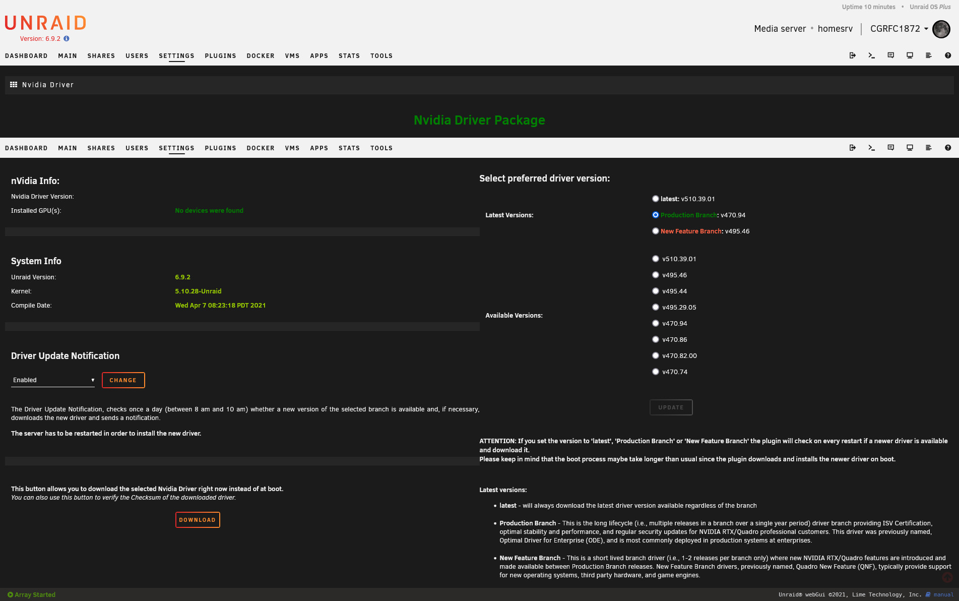

but now when i go onto the nvidia driver plugin page it just has this. I've tried multiple reboots but nothing seems to solve ithomesrv.local-homesrvnvidia-driver.thumb.png.0ad0e325e8f22c9f6caa7560021f2868.png
Please post your Diagnostics.

14 minutes ago, CGRFC1872 said:
i've attatched the diagnostics
Hav eyou exposed the server directly to the Internet or do you have it in the DMZ? If yes please revert this imediately!
Your first syslog is full of login attempts.
16 minutes ago, CGRFC1872 said:
Downgrading the driver worked?
I don't think that's what made it to work, please try a the latest production branch and it should work to, have you changed anything in your BIOS? Seems like Above 4G Decoding isn't turned on in your BIOS.
Server isnt in a DMZ, the login attempts might have been me as i was constantly spamming it very scared it had just broken.
I've not changed anything in the bios since i got the server in 2017 its litreally been since last night its had this issue after i updated due to getting a message saying there was a new nvidia driver
