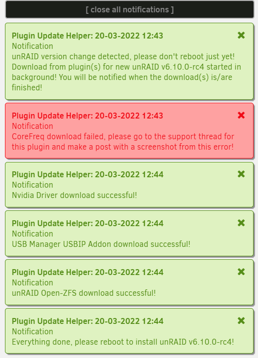

FYI looks like this plugin is not ready for 6.10.0-rc4, got the message that the driver could not be downloaded, immediately rolled back to RC3.
It is only an error in the plugin helper. ich777 posted this in another thread.
investigated a little further and found the cause of the issue, the naming from the Linux Kernel version changed, updated the Plugin-Update-Helper to take that into account. Hopefully it will work next time.
It is safe to reboot because the plugins are downloaded on boot too, just make sure that you have a active Internet connection without any AdBlocking software in front of it.
If you don't have a active Internet connection on boot a plugin removal from the Plugin Error tab and a new installation will fix it.
Plugin is ready, see here: Click
Can you try to upgrade again to RC4 and tell me if it is now working?
Downgrade to rc3 then back to rc4 error still appears
What do you get from:
cat /tmp/update-helper
root@computenode:~# cat /tmp/update-helper
2022.03.19
root@computenode:~#
Just now, SimonF said:
2022.03.19
Can you try to downgrade once more and reboot so that it pulls the new version 2022.03.20 and then try to upgrade once more?
Yes looking better now.
Thank you as always for your help! :)
Really strange that it reports that CoreFreq isn't found...
Tried as well:
  • upgraded to RC4
  • error, but after reboot all is good
  • downgraded to RC3
  • reboot, all is good
  • upgrade to RC4, no more errors
Thanks for fixing this so fast!
