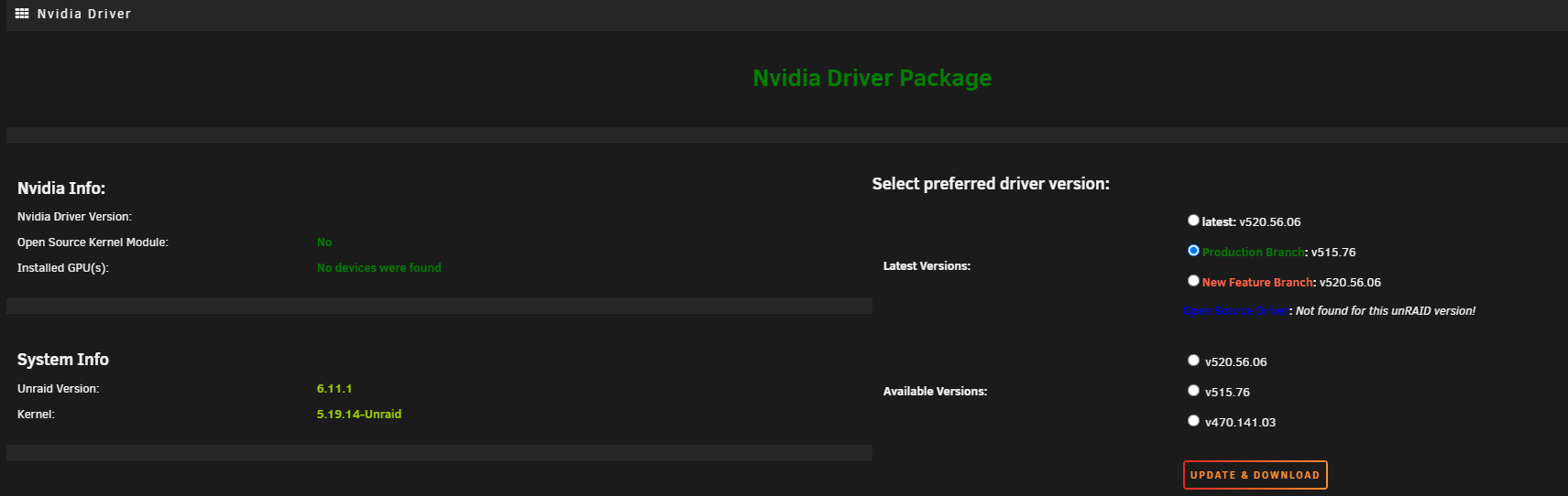

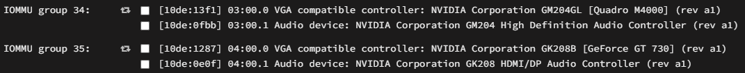

I have installed the Nvidia drivers and have two Nvidia cards installed, a GeForce GT 730 and a Quadro M4000. Both show up under System Devices.
But, the Nvidia Driver Package says no devices found.
SSH command:
root@Media:~# nvidia-smi
No devices were found
I had used the latest driver when installing and changed to Production to see if that would help. I rebooted every time.
The GT 730 is used only for a Windows VM. I had it bound, but un-bound it when trying to get the drivers to show. Diags are attached just in case.
Thanks in advance,
Eddie
EDIT:
I just installed the M4000 today. I just found a note about no power adapter in the logs and just ordered a cable. But, the GT 730 does not install drivers even with the M4000 removed.
Nov  4 15:11:42 Media kernel: NVRM: GPU 0000:03:00.0: GPU does not have the necessary power cables connected.
Nov  4 15:11:42 Media kernel: NVRM: GPU 0000:03:00.0: RmInitAdapter failed! (0x24:0x1c:1377)
Nov  4 15:11:42 Media kernel: NVRM: GPU 0000:03:00.0: rm_init_adapter failed, device minor number 0
media-diagnostics-20221104-1511.zip
Edited by Eddie Seelke
power adapter
The GT730 needs the legacy drivers, these are the 470 series drivers as you can see from your screenshot on the bottom.
The GT730 is a pretty bad card for transcoding because it doesn't support h.265 (HEVC).
I was only using it for a Windows VM and didn't really need the drivers for it. I should get the power cable for the M4000 on Sunday. Hopefully, that will resolve my issue.
Thanks
Definitely because the driver recognizes the card. ;)

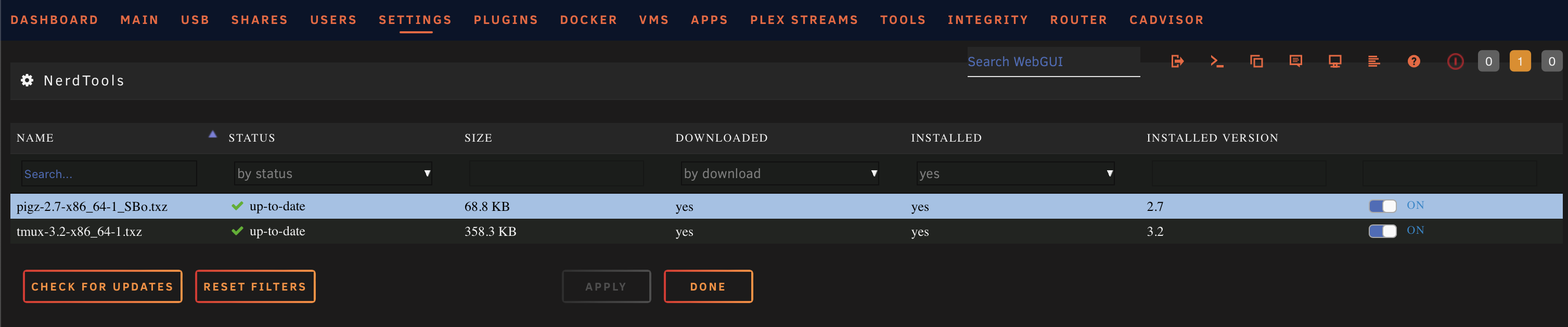

hello again,
now containers starting with nvidia runtime...
but like I'm not sure how it started - I'm also not very sure how it's now fixed

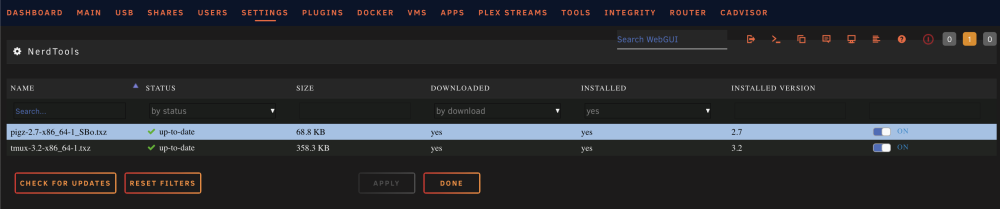

  1. so I removed the GPU statistics add-on
  2. went to nerd tools and these packages were installed (not by me, not sure why) and updated them:
93040470_Screenshot2022-11-04at23_38_30.thumb.png.568a72ace716061eadac28437c597187.png
3. reboot
4. fixed... by maybe one of these actions...
but I have a feeling that I'm not finished with this problem as I don't know how to not make it occur again
i attach a new diagnostic from after i got it working in case this may help
thanks again for your help !
unraid-diagnostics-20221104-2336.zip

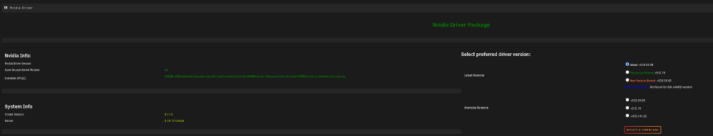

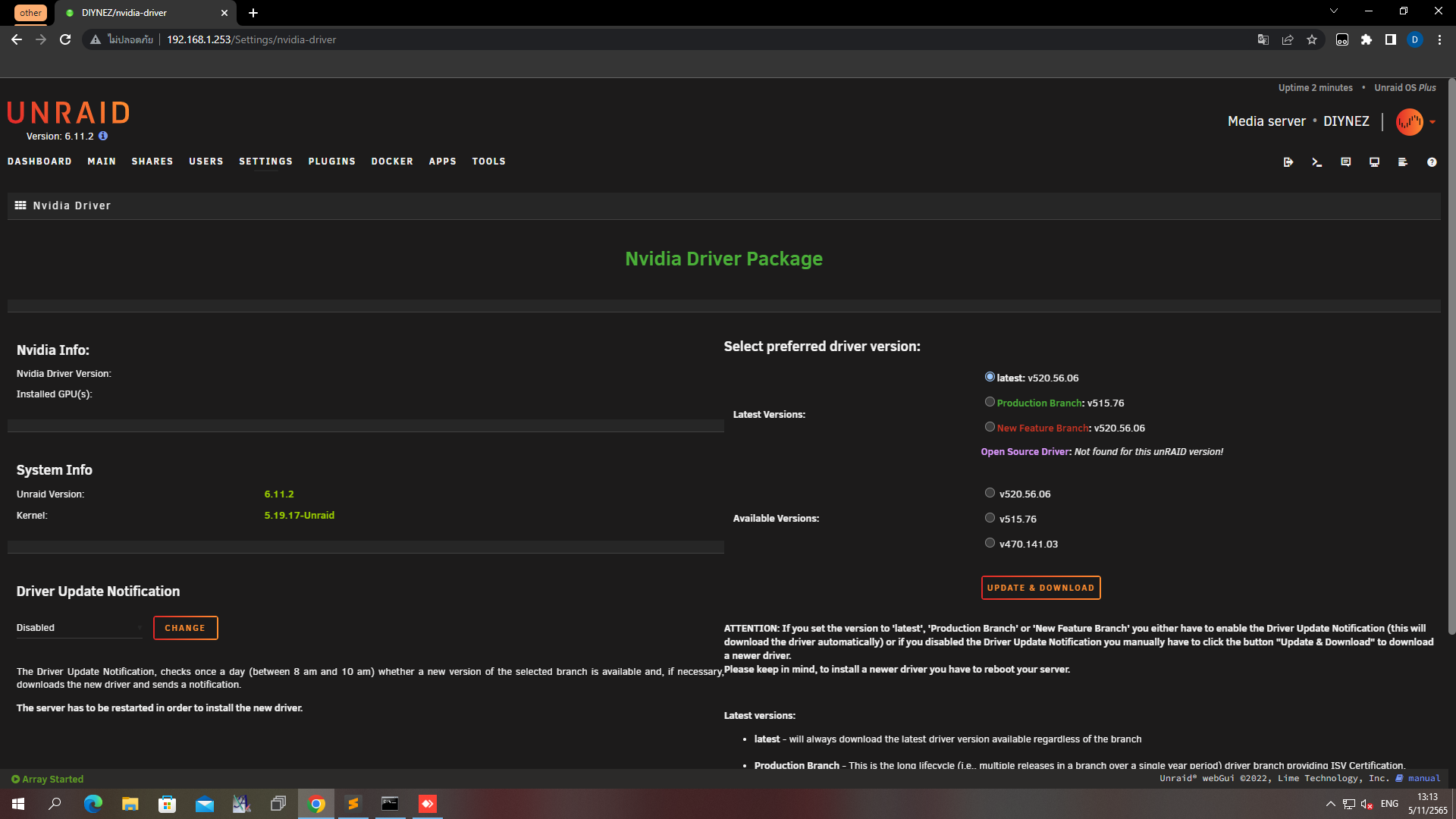

15 minutes ago, neunghaha28 said:
After update 6.11.1 to 6.11.2 please help  me.
The driver download is incomplete, have you waited before upgrading to 6.11.2 where it said to wait until it displays a message that everything is done?
Anyways, please select the driver that you want to install and press the "Update & Download" button on the Nvidia Driver page, this should redownload the driver.
1 hour ago, ich777 said:
The driver download was incomplete, have you waited after upgrading to 6.11.2 where it said to wait until it displays a message that everything is done?
Anyways, please press the "Update & Download" button on the Nvidia Driver page, this should redownload the driver.
Thanks i will try it I feel that the download speed is very slow.
Update: Now it works fine Thanks for the help again.
Edited by neunghaha28

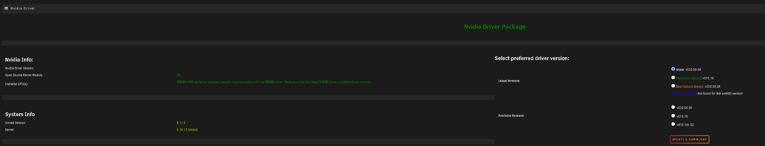

I got an issue downloading th edriver whilst upgrading Unraid 6.11.1 to 6.11.2. The error msg asked to make this post sho here it is.
Please let me know if anyone need any more information. 🙂
Seems like something went wrong with the driver download, please reboot, maybe the reboot will take a bit longer since the plugin tries to download the driver on start too (as long as you have a active internet connection on boot) if it failed like in your case.
Please report back if it is working afterwards, if not I would recommend to uninstall the plugin and pull a fresh copy from the CA App.

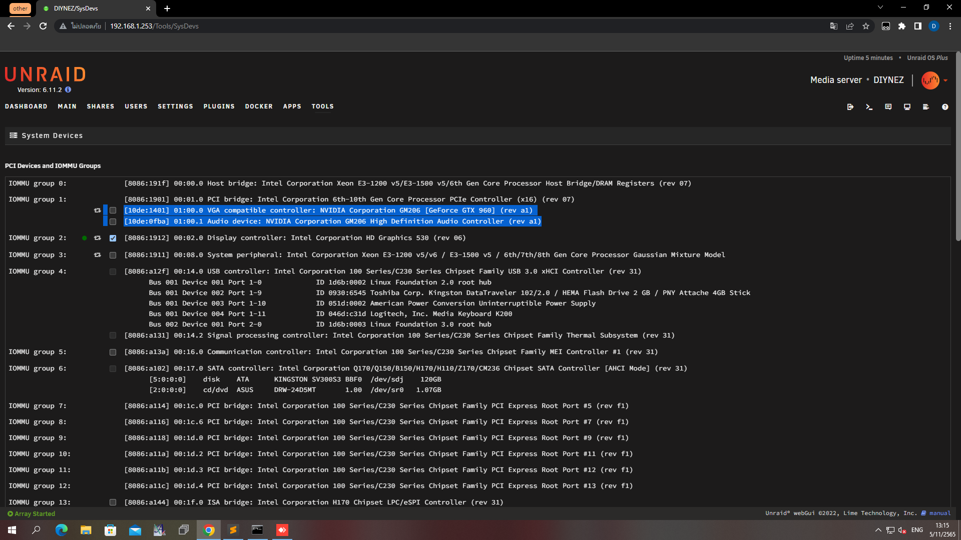

On 10/20/2022 at 1:11 PM, carnivorebrah said:
Hmm, alright.
It is a Supermicro X9DRL-iF, which does have IPMI and a VGA port for displaying video, but I have the BIOS set to the PCI slot the GPU is in for video output because the VGA port wouldn't work before.
I can try switching the BIOS to the VGA port and seeing if it works now instead of the GPU...
So, as a test, I switched out the P2200 for a spare GT 710 I had lying around.
I'm able to get it load all the way to the log in screen with this card, but oddly, it doesn't show up in the Nvidia plug-in:
It does show in my IOMMU groups though:
Why wouldn't it show in the Nvidia plugin?
Diagnostics attached.
It's really odd that everything was working with the P2200, except the login screen, but with the GT 710, it's the complete opposite.
diagnostics-20221106-1324.zip
This is because you need to select the 470 series driver:
Nov  6 13:12:46 AKWSERVER kernel: NVRM: The NVIDIA GeForce GT 710 GPU installed in this system is
Nov  6 13:12:46 AKWSERVER kernel: NVRM:  supported through the NVIDIA 470.xx Legacy drivers. Please
Nov  6 13:12:46 AKWSERVER kernel: NVRM:  visit http://www.nvidia.com/object/unix.html for more
Nov  6 13:12:46 AKWSERVER kernel: NVRM:  information.  The 520.56.06 NVIDIA driver will ignore
The GT710 is a really horrible card IMHO... :D
Please report back what happens if you switch over to the 470 series driver after a reboot.
