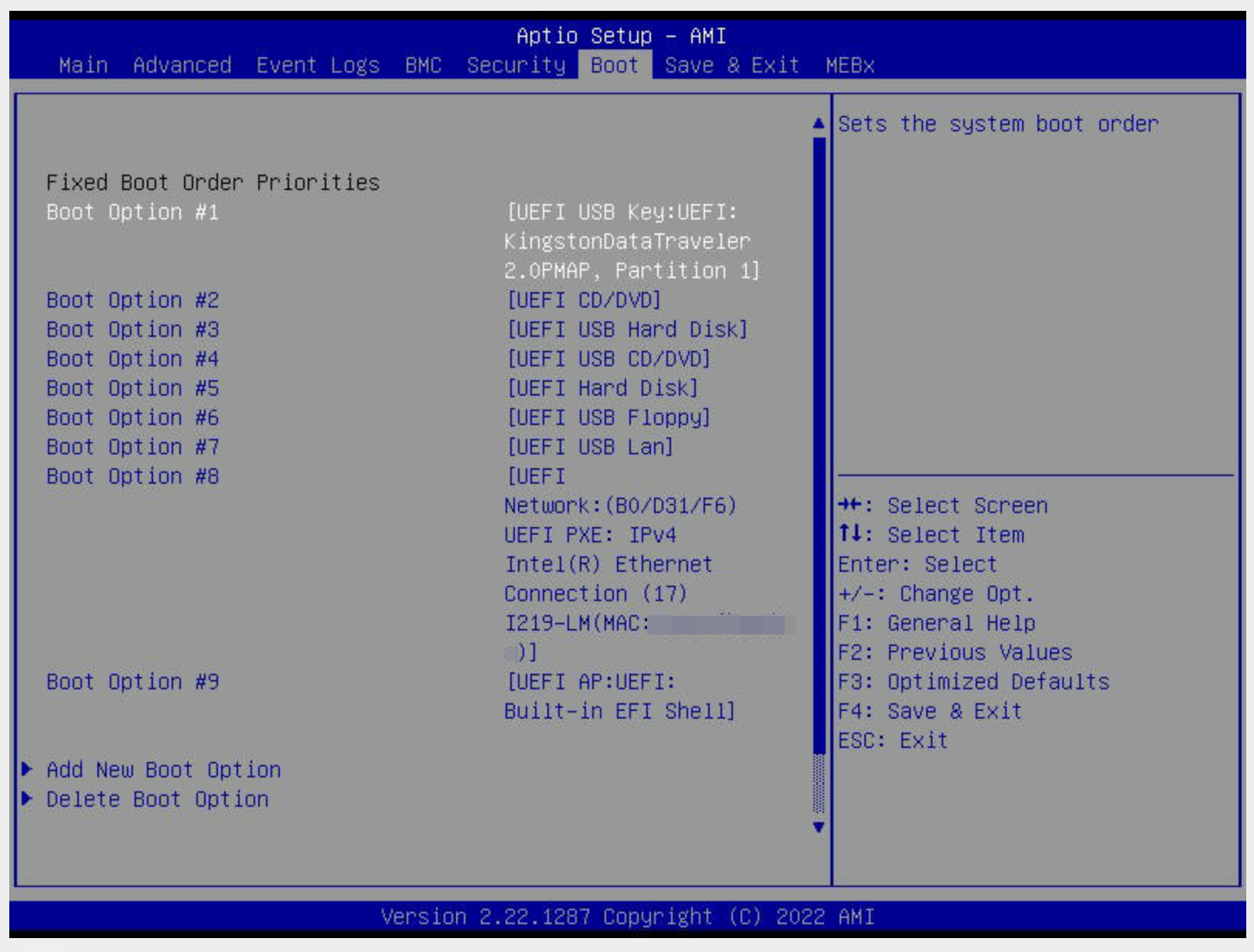

On 12/21/2022 at 8:54 PM, ich777 said:
May I ask why do you want to use a Nvidia GPU when you have the iGPU, the new Intel iGPUs are pretty much capable of the same amount of transcodes like your 1650 (depending on the source quality) and as a benefit you save a lot of power.
Honestly I do not know. I want to evaluate the performance difference between GPU and CPU. This is really an unnecessary option, and only the CPU will be enough for transcoding.
32 minutes ago, brainreplaced said:
Thanks for the answer. I completed the first and third points. Unfortunately, I don't quite understand how to switch to legacy with this motherboard. Google searches ended in failure, I'll do some researching over the weekend.
Should be CSM or Legacy Boot somewhere in your BIOS.
The iGPUs are a bit slower with transcoding in terms of FPS but they are pretty much capable of the same amount of transcodes as consumer Nvidia GPUs.
I really don't know if it's an issue with the GTX1600 series cards since very many users have issues with this cards (not only on Unraid, Linux in general).
9 minutes ago, ich777 said:
Должен быть CSM или Legacy Boot где-то в вашем BIOS.
Yes, I understand. On most motherboards, switching is in this section as a separate option, but here it is missing 😞
1423280932_MonosnapResolution800x600FPS102022-12-2312-19-07.thumb.png.2f5322c575ec9bd00be3f62e06f30b2c.png
As far as I can tell you should have the option in your BIOS since even your Motherboard Manual mentions it.
I also see a options that may be also relevant for you "Above 4GB MMIO BIOS Assignment" which should be also be Enabled.
As said above I really don't know if this is a hardware compatibility issue in your case because many users have issues with GTX1600 series cards.
You can also try and disable your onboard GPU and see if this makes a difference, other users said that the disabling the BMC did also help but these all things which I can't test because I don't have such an card or motherboard.
