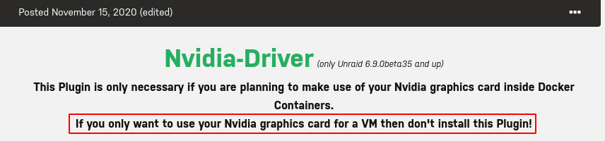

On 1/24/2023 at 6:22 PM, ich777 said:
If you want to use this card for a VM then please uninstall this plugin, this plugin is only meant if you want to use your Nvidia card in a Docker, or even multiple, Docker contianer(s).
See the first post from this thread:
Hi !
Thanks for this note ! Previously i used my Nvidia card for the H/W transcoding on Plex docker but recently i switch to use the card on a Windows VM. But i didn't unistall the driver-plugin on Unraid and right now it's works pretty well with the VM. Dispite this recommendation.
Can you precise why it's not recommanded to have the driver for a VM ? This topic is pretty huge, so i may be missed this information. The performance are less than expected with the plugin install ?
Thanks for your great work by the way !
Regards,
no performance issues, but, if you have a active docker running using the driver and turning on the VM ... this can result in a crash overall as its a either or usage only ... so either your VM using the GPU in passthrough OR the host using it, as sample for a GUI usage, docker usage, ... just be aware ;)
Ok, I see the potentiel problem, it's happen to me the first days of transition to the VM, so i will follow this recommendation ahah ! 😄
Thank you for this prompt answer ! Have a great day !
