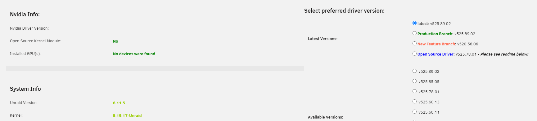

I can't get my 3060Ti to show up My 3060Ti shows up, and keep getting the "No devices were found" message.
It shows up under System Devices, not bound to vfio. Any suggestions?
tower-diagnostics-20230225-0835.zip
Please make sure that you are on the latest BIOS version for you Motherboard and you've enabled Resizabe BAR support/Above 4G Decoding in your BIOS.
Feb 24 18:20:06 Tower kernel: nvidia 0000:01:00.0: vgaarb: changed VGA decodes: olddecodes=io+mem,decodes=none:owns=io+mem
Feb 24 18:20:06 Tower kernel: NVRM: loading NVIDIA UNIX x86_64 Kernel Module  525.89.02  Wed Feb  1 23:23:25 UTC 2023
Feb 24 18:23:49 Tower kernel: resource sanity check: requesting [mem 0x000e0000-0x000fffff], which spans more than PCI Bus 0000:00 [mem 0x000d4000-0x000e7fff window]
Feb 24 18:23:49 Tower kernel: caller _nv036385rm+0x2a/0x60 [nvidia] mapping multiple BARs
From what I see you are using a Intel Board and some people have really bad experiences with it and Nvidia cards on Linux.
If the above doesn't work try to boot with UEFI and see if this makes a change.

Thanks, yeah it's an Intel s1200bt. I updated the bios and still don't have a resizable BAR option. It might just be time for an upgrade.
Try to boot with UEFI mode but I'm not entirely sure if it will work after you do so...
I remember a few users with Intel Board who had issues so far.

1 hour ago, MasterPepe said:
Hello all
I have already searched in the forum and also on google. Unfortunately still without success.
Perhaps someone can kindly help me or already has a solution for this problem.
I have the classic error:
NVIDIA-SMI has failed because it couldn't communicate with the NVIDIA driver. Make sure that the latest NVIDIA driver is installed and running.
I have an Nvidia Quadro P4000
The driver is the v525.89.02
Unraid Version: 6.11.5
And yes, the Quadro 4000 is supported by the driver and is listed.
Here is the list of system devices. The graphics card is listed and not bound.
Could someone please help me with this?
Thanks a lot!
MP

11 hours ago, MasterPepe said:
Where exactly do you look for information?
You have a Quadro 4000 and this card is simply to old to be supported by this plugin:
Feb 28 20:55:01 Tower kernel: nvidia: loading out-of-tree module taints kernel.
Feb 28 20:55:01 Tower kernel: nvidia: module license 'NVIDIA' taints kernel.
Feb 28 20:55:01 Tower kernel: Disabling lock debugging due to kernel taint
Feb 28 20:55:01 Tower kernel: nvidia-nvlink: Nvlink Core is being initialized, major device number 245
Feb 28 20:55:01 Tower kernel: NVRM: The NVIDIA Quadro 4000 GPU installed in this system is
Feb 28 20:55:01 Tower kernel: NVRM:  supported through the NVIDIA 390.xx Legacy drivers. Please
Feb 28 20:55:01 Tower kernel: NVRM:  visit http://www.nvidia.com/object/unix.html for more
Feb 28 20:55:01 Tower kernel: NVRM:  information.  The 525.89.02 NVIDIA driver will ignore
Feb 28 20:55:01 Tower kernel: NVRM:  this GPU.  Continuing probe...
Feb 28 20:55:01 Tower kernel: NVRM: No NVIDIA GPU found.
For what do you want to use the GPU? This GPU won't do much in terms of transcoding because it simply too old, the next thing is that you can't use the legacy driver for Docker containers because you need at least a driver based on version 4xx.xx
