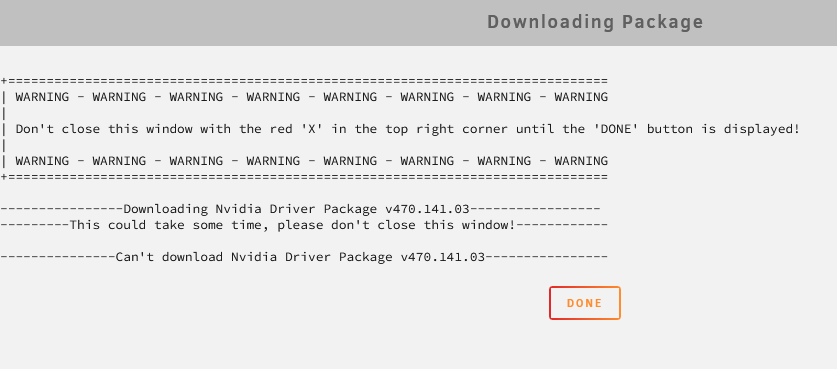

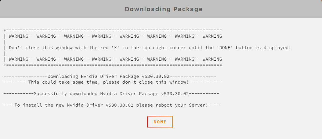

8 hours ago, ich777 said:
I can't reproduce this on my end, I've even tried to downgrade to the driver version 470.141.03 and then set it again to latest and it properly downloaded the latest (v530.30.02) driver version.
I've tried restarting server and still doing same thing. Have any suggestions for resolution?
Sounds a bit complicated but can you do the following:
  1. Uninstall the Plugin
  2. Reboot
  3. Install the Plugin again
  4. Reboot once more or restart the Docker service
I‘ve now tried it again on another machine and 6.11.5 and it is working there too as it should.
I will contact another user if he can test that for me too.

13 hours ago, tusculumgolfer said:
When I select "latest" or manually select "v530.30.02" it still acts like it is trying to download v470.141.03 and spits out "Can't download Nvidia Driver Package v470.141.03". Is this a plugin error or something with my server?
i guess more something wrong with your flash ... working also fine here
just as simple testrun, downngrade to 470, up to 525, 530 now, all fine

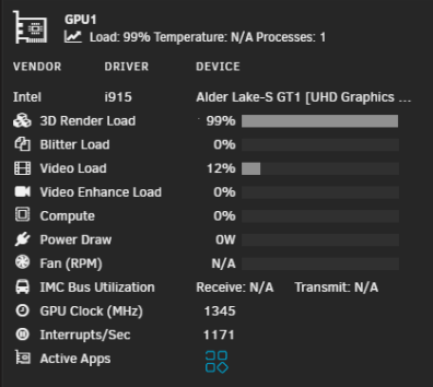

I have been having some issues recently with the plugin. From time to time I come home and find that my server GUI is in a 500 internal server error. The SSH into the server works fine, and all dockers and VMs are all running, but the web GUI just fails to load. If I SSH in and to "/etc/rc.d/rc.php-fpm restart" the GUI will come back, sometimes for a short time and sometimes for a while, but eventually I find myself back in the crash 500 internal server error. I have this plugin as well as GPU Statistics by b3rs3rk installed. The other weird thing is that when I do get the GUI back, the Statistics on the main page for my GPU are all blank.
I have a ASUS Strix 1050ti installed with the latest official driver in the plugin installed as well. I only use the GPU for Tdarr transcoding, and have had no issues while the GPU is doing that task. The output files also look fine so I dont think that MY GPU is dying. Any thoughts?
eos-diagnostics-20230101-1425.zip
Edited by Tithonius
added diagnostics
I don't see a Nvidia GPU connected to your system in the attached Diagnostics, I even don't see the Nvidia Driver plugin installed...
The only thing that I see is a Intel iGPU, may I ask why you aren't using the iGPU for HW transcoding?
i almost guess its the 0:01:00 + 01 (video/audio) which is vfio bounded and missing from lspcie ...
I have a 1050ti installed... And the latest driver installed. I'll do another diagnostic and post it, I took that while a crash was happening and I'd be willing to bet that might be why that was missing. The igpu in the system is not nearly as fast as the 1050ti at least in my testing. I have almost 30TB of data I need to transcode through, so I was looking for the higher fps while transcoding.
In lspci.txt I can see the GPU there.
01:00.0 VGA compatible controller [0300]: NVIDIA Corporation GP107 [GeForce GTX 1050 Ti] [10de:1c82] (rev a1) Subsystem: ASUSTeK Computer Inc. GP107 [GeForce GTX 1050 Ti] [1043:85d1] Kernel driver in use: nvidia Kernel modules: nvidia_drm, nvidia
But I also see in the log that it's unable to bind device? I'm confused.
Edited by Tithonius
may delete the vfio bind, looks like this was from another device you had a vfio bind active (possible another GPU from earlier times ?) for VM passthrough ?
vfio bind should only be activated for devices which you want to passthrough a VM ...
