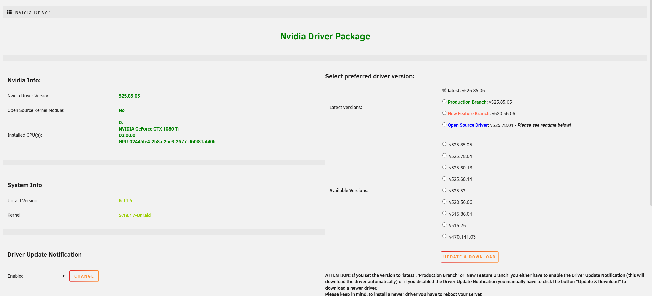

  • Recompiled the drivers and they are now just working fine (to get it working scroll down):   Please do the following (this is only necessary if you upgraded before I recompiled the dri
  • I'm currently spinning up my build VM and compiling the drivers again, currently drivers for 6.11.0 stable are not available...

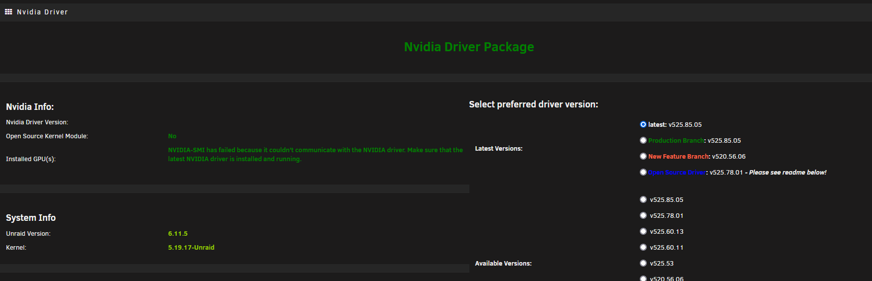

6 minutes ago, ich777 said:
Are you really sure that the card was working before? Please test it if possible in another system.
At your earlier suggestion i have tried it in another system and it is fully functional
Did you install a driver and put a 3D load too?
1 hour ago, Obbyed said:
Warning: file_put_contents(): Only -1 of 163 bytes written, possibly out of free disk space in /usr/local/emhttp/plugins/dynamix/scripts/notify on line 218
Uh wait, how much RAM do you have in your system?
How much space do you have on your USB Flash device?
Yes I did
Currently have 4gb as it was bought as a barebones server, i have 16gb of space on the USB
4GB of are too less for the base system and the driver nowadays.
You need at least 8GB of RAM for the driver to work since they are getting bigger and bigger with each revision.
Thankfully i have an 8GB kit coming on monday just to keep me online, thank you very much for your help

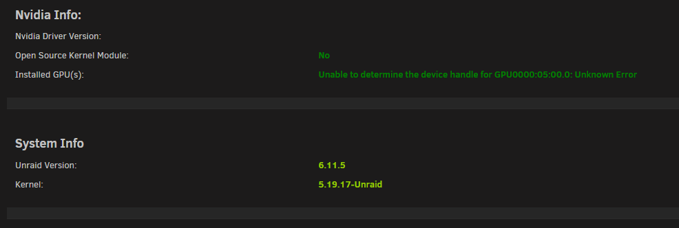

Hello Everyone,
I'm having a strange issue with my Nvidia Card (TESLA P4).
When I boot the server is working just fine.
It can transcode in PLEX & Unmanic.
After a couple of hours (or days it depends) - it stops working and it's no more recognized from the plugin:
Does somebody have the same issue?
sekiro-diagnostics-20230129-1248.zip sekiro-diagnostics-20230129-0900.zip
Seems like the Kernel module crashed, that happens usually because of some kind of hardware failure or hardware incompatibility.
Jan 26 02:59:57 Sekiro kernel: NVRM: GPU at PCI:0000:05:00: GPU-5d7f9c28-8f84-bb4a-7ae8-2456be369183
Jan 26 02:59:57 Sekiro kernel: NVRM: GPU Board Serial Number: 0322717107488
Jan 26 02:59:57 Sekiro kernel: NVRM: Xid (PCI:0000:05:00): 79, pid='<unknown>', name=<unknown>, GPU has fallen off the bus.
Jan 26 02:59:57 Sekiro kernel: NVRM: GPU 0000:05:00.0: GPU has fallen off the bus.
Jan 26 02:59:57 Sekiro kernel: NVRM: GPU 0000:05:00.0: GPU serial number is 0322717107488.
Jan 26 02:59:57 Sekiro kernel: NVRM: A GPU crash dump has been created. If possible, please run
Jan 26 02:59:57 Sekiro kernel: NVRM: nvidia-bug-report.sh as root to collect this data before
Jan 26 02:59:57 Sekiro kernel: NVRM: the NVIDIA kernel module is unloaded.
Is your card cooled enough so that it don't overheat?

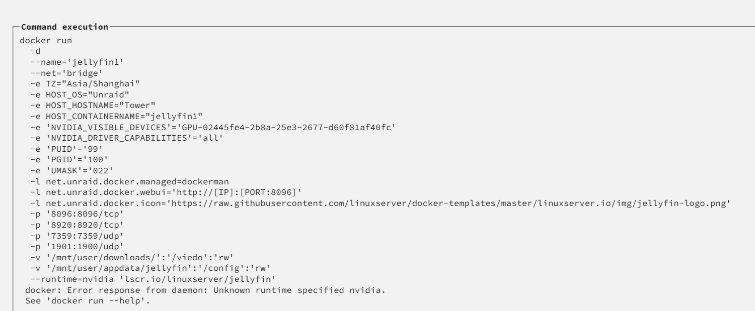

When I start jellyfin, I use Nvidia to appear
docker: Error response from daemon: Unknown runtime specified nvidia.
See 'docker run --help'.
How can I solve it? None of the methods on the network are good
image.thumb.png.8c446d615fdb4c11963618540719764e.pngimage.thumb.png.03130d3a5b3cce58640e120099d1fb0b.pngtower-diagnostics-20230130-0952.zip
Please read the first post again, did you restart the Docker service after installing the plugin?
EDIT: Now I see the issue, you are updating the daemon.json on boot in the go file:
# Update mirrors
tee /etc/docker/daemon.json <<-'EOF'
 "registry-mirrors" : [
  "http://REMOVED.com",
  "https://REMOVED.com",
  "http://REMOVED.cn"]
EOF
Please delete this entry or at least comment it, reboot and see how it looks like when there no modification is made.
I would recommend that you add the required entries for Nvidia in your go file routine.
Hope that helps. ;)
EDIT2: Take also a look at this post where I explain how you can inject your mirrors too:
# Update mirrors
EOF
Hope that helps. ;)
Thank you. The problem has been solved
