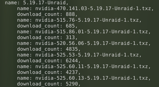

(these are the downloads from the individual driver packages for Unraid 6.11.5)
You have to at least see my point of view that so many people have installed the drivers and non of them have an issue like you.
Or better put it that way, if you have Unraid 6.11.5 installed with the driver 525.60.13 and someone else have the exact same system and the same driver installed you are both using the exact same package and nothing is different.
As said before, the drivers are pre compiled, compressed to a package which is downloaded by the plugin and ultimately installed on your system.
