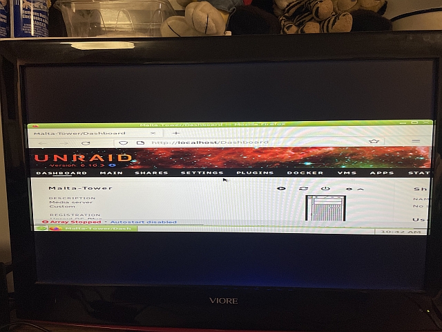

Hello, my friend.  I've been troubleshooting an issue now for over a week, and I could use some of your expertise in an area where, for my expertise, I'm well over my head.  I posted a thread last week in the General sub-forum, but haven't had much response.
I recently upgraded my server with a new 5700G and B550 motherboard.  The server retains the Quadro P400.  The goal is to use the AMD iGPU as an Unraid console (to use KVM) and the P400 for transcoding in Unraid dockers.
The issue is I cannot get the iGPU to display the Unraid login screen when booting into "Unraid OS GUI Mode" with the P400 and nVidia plugin installed.  With a monitor attached to the iGPU, from a power on boot I can watch boot sequence on the display, the initial Unraid boot text, GRUB menu, then more Unraid text.  I displays "Staring Samba" for just over a minute, then the display is blanked.
In my current configuration, if I boot into GIU Safe Mode, the display on the iGPU boots into the Unraid log in, and works as I would expect and desire.
I have tried so many different combinations of things:  EUFI vs Legacy, uninstall/reinstall both nVidia and Radeon_Top, remove P400, plugged HDMI dummy plug into P400 (was needed in earlier non-iGPU setup to boot), and more.  Each time I (usually) start from a power off boot.  I have so many hours now of troubleshooting, I have lost track.  What is common is if I remove the nVidia from the situation (physically or Safe Mode) the iGPU displays fine.  It seems that Unraid switches the console from the iGPU to the P400 at some point.
Any input you can offer is greatly appreciated.  The diags attached is the current/latest configuration in the standard GUI bott up.
malta-tower-diagnostics-20230124-0845.zip
Please run this command from a Unraid Terminal:
sed -i "/disable_xconfig=/c\disable_xconfig=true" /boot/config/plugins/nvidia-driver/settings.cfg
and reboot after that.
WOO HOO!  You are my hero!  First time I've seen this 100% correct since I started on it a week ago Sunday.
I had at one point added "disable_xconfig=true" to the config file.  It ended up displaying out put that was squished down and extending too wide for the monitor (see picture).  I had found this in a bug report thread for 6.9.  I then had a bunch of issues undoing it (set to 'false', removed entirely) that I ended up rebuilding my flash from an earlier backup.  (That's a whole other frustrating story).  So I decided not to go down that path again.
So thank you, once again, for your help.  Not just for this, but all you do for the Unraid community!

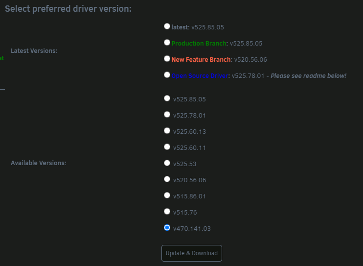

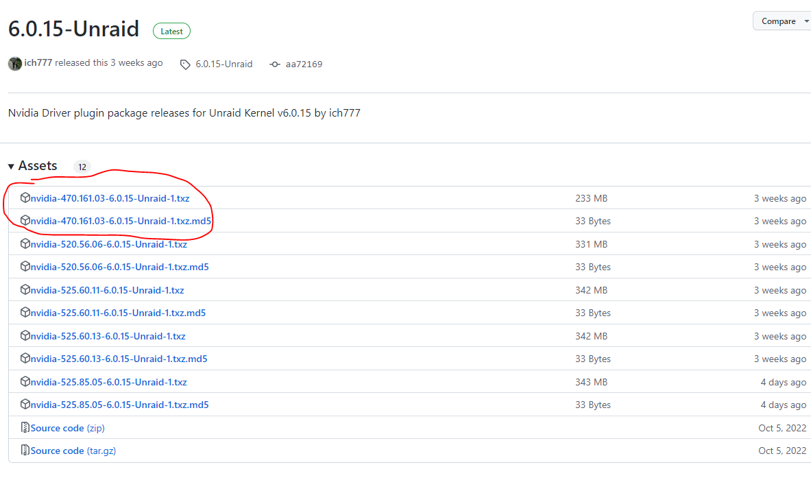

I need a little bit support.
I need the driver package 470.161.03
I saw that you released it.
But I cannot choose it in the plugin.
How is the procedure?
Thanks a lot
A quick follow up.  When I tried "disable_xconfig=true" earlier, I may have been booting with UEFI.  One notable difference I saw on my machine is the text size (and GRUB menu) had smaller text.  In hindsight, this may be why I had the funny looking resolution when I tried this config entry before.  Something to think about.
On what Unraid version are you?
Please post your Diagnostics.
May I ask why you need that specific driver?
This is caused by the implementation in the BIOS and mostly nothing I can do about...
However may I ask why you want to use the iGPU for Console or better speaking the Unraid GUI output?
It wouldn't make much of a difference if you for example disable the iGPU and display it through the Nvidia GPU, of course you have to set disable_xconfig again to false.
On 8/29/2022 at 8:25 AM, ich777 said:
May I ask first what you want to do with card?
I installed a gainward gtx650ti GPU
On gainward site driver is referred to NVIDIA page. There is this driver noted for this GPU.
I'm on Version: 6.11.5
tower-diagnostics-20230124-1750.zip
What is wrong with driver version: 470.141.03?
From what I see in your Diagnostics the driver is loaded and your card is recognized just fine.
BTW if you want to use this card for hardware transcoding that's a pretty bad choice because it even doesn't support h265 (HEVC).
25 minutes ago, SBH said:
Thanks a lot
The screenshot that you've posted above is for another Unraid version too...
I thought, that it should be equal with recommendation of NVIDIA.
Thanks for this input, I was really thought about to using GPU for HW Transcoding and the iGPU for a small VM. In this case, I will switch.
My iGPU is performing well for the HW Transcoding.
Thanks for the support
Yes and no.
The reason behind why it is like it is for the legacy driver is because I only compile the latest legacy driver which is available at a new release from a new Unraid version, like in this case Nvidia Driver version 470.141.03 was the latest legacy driver when Unraid 6.11.5 was released on November 3rd 2022:
(BTW 5.19.17 is the Kernel version from Unraid 6.11.5 and this version allows me to exactly identify in the plugin which version from Unraid a user is running and needs to be downloaded since the driver depends on the Kernel version)
This driver should run with all cards which need the legacy driver just fine.
On the other hand, for stable Unraid versions I compile ever new Nvidia driver (for recent cards) that is released in the life cycle for a specific Unraid version, like you can see for 6.11.5 there are a lot since November 3rd:

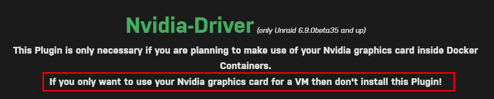

If you want to use this card for a VM then please uninstall this plugin, this plugin is only meant if you want to use your Nvidia card in a Docker, or even multiple, Docker contianer(s).
See the first post from this thread:
