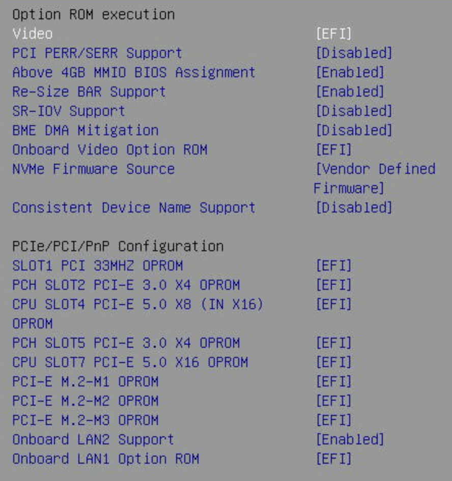

Options like "Above 4GB MMIO BIOS Assignment" and "Re-Size BAR Support" already enabled. Bios has the latest version. I've tried swapping cards, but no change. And I'm sure there's about 70W on that PCIe.
And one more thing, I cannot change EFI to Legacy, there are only two options: "EFI" and "Disabled"

What you can also try is to boot with UEFI mode instead of Legacy mode and see if this helps.
20 minutes ago, ich777 said:
Maybe, but I think most of the users where able to fix their issues with the cards.
I suspect that the card is maybe defective but I can't tell for sure if you can't test it in another system.
I've given up on it and started an eBay return. Spent a good 12hrs yesterday frying my brain trying to figure it out. The guy from reddit got back to me and he had no issues using the  linux drivers, his got recognised first time in the same config as me with no BIOS tweaks. So I'm almost certain its a dud card. Just my luck! :D
Well the p600 is all packed up and being shipped back. Just won an auction for a p1000. So if I get the same issues, thats my next action! Hope not to be back next weekend! :D
