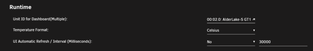

1 hour ago, JorgeB said:
What's the current default?
1 sec (1000ms) is the default value from the GPU Stats part, we may put this into the thread there as the questions about spamming are there (and related to the GPU Stats plugin) ?
Yes, I think it would be a good idea.
2 hours ago, JorgeB said:
What's the current default? There have been some reports that the plugin can spam the syslog with ACPI errors, possibly solved by changing that value.
I thought it was 10sec, but @alturismo is correct looking at default.cfg its 1sec. I will change to 30secs for the next time I release but that will only affect new users.

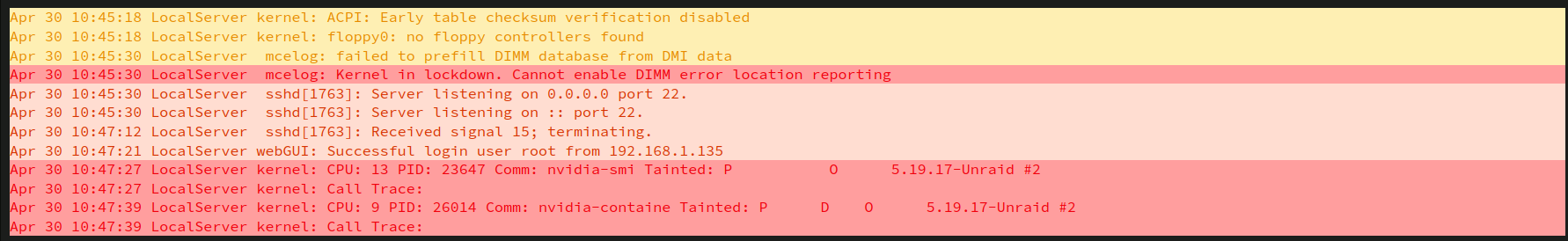

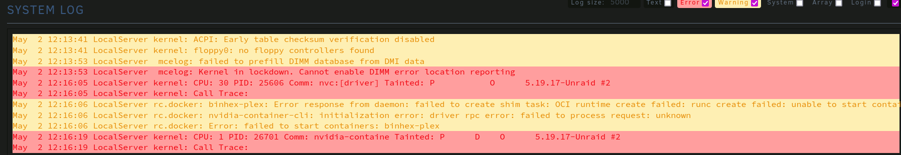

Hello, I have a P4000 for my Docker applications however sometimes the card will not mount when it is shown perfectly fine within "System Devices"; I can restart my server multiple times where eventually it will be mounted properly and usable for whatever task I throw at it.
This is the System Log from one of the instances where it happens; It will not appear if it is mounted properly.

6 hours ago, PeterNokes said:
Hello
First of all I would recommend that you first clean your /boot/extra directory:

You have many packages twice or even three times in there, why? I also can't tell for sure if there is a package in there which actually causes the incompatibility.
Do you need all those packages?
The next thing that you can try is to boot in Legacy mode and not in UEFI.
I can't also see the call trace, can you maybe post a diagnostics file after the call trace happened?
Hello when I try to post a diagnostics file when the issue happens it gets stuck at "/usr/bin/nvidia-smi --query 2>/dev/null|todos >>'/localserver-diagnostics-20230502-1242/system/nvidia-smi.txt'" and freezes my server. (Which happens to anything NVIDIA related)
I have deleted everything in /boot/extra just to make sure that is not the issue and that has apparently fixed it after restarting twice so I will have to have another look.
Thanks
Now that I see it, how do you added the GPU to the template?
Have you done it like mentioned in the second post from this thread?
Please note that the flag: --gpus all causes issues on many systems is not recommended by me...
I use the GPU ID (GPU-2066de26-xxxx-xxxx-xxxxxxx) for both of my Dockers which uses it; The only place where I have "all" is for the "NVIDIA_DRIVER_CAPABILITIES"
This is perfectly fine.
Please keep me updated on this...
