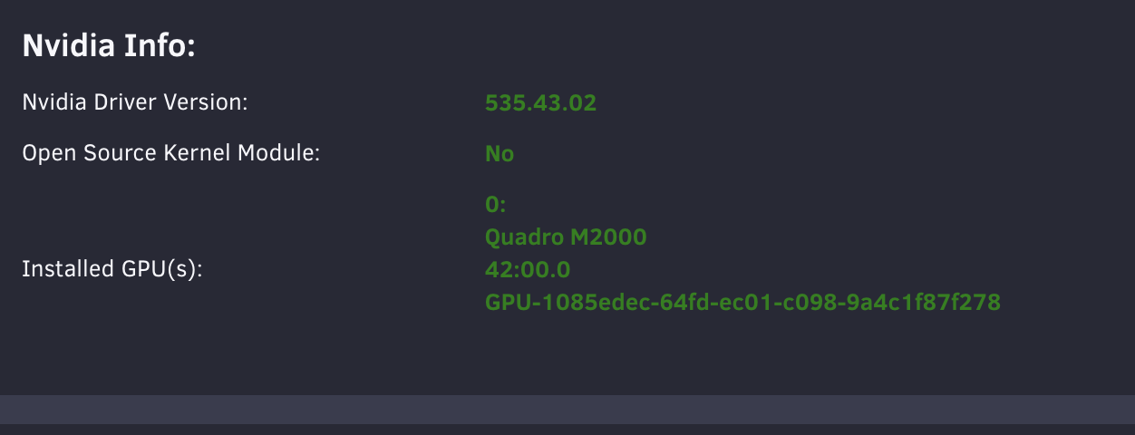

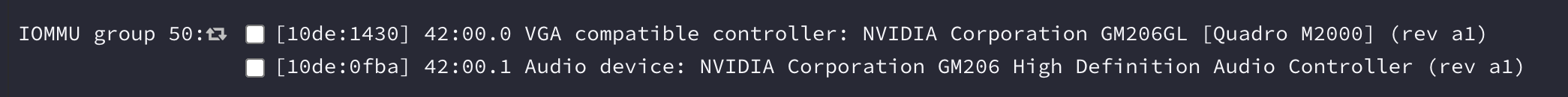

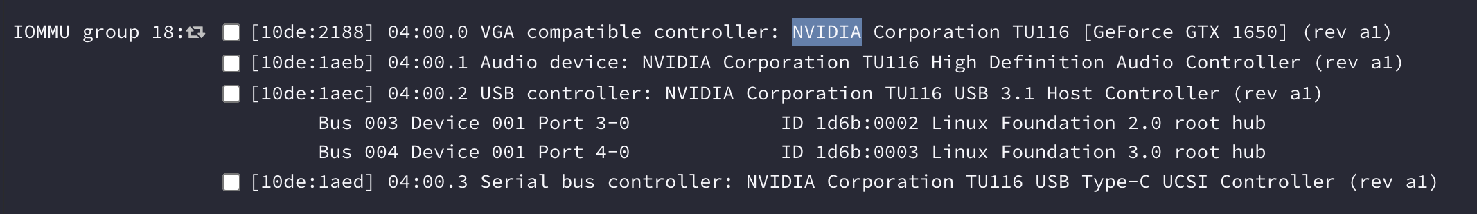

@ich777 I searched for this but couldn't find proper solution, the plugin only sees one of the GPUs.
I have Quadro M2000 and GTX 1650, but only M2000 is picked up by the plugin/driver.
1650 & M2000  in IMMOU
Please post your Diagnostics.
Hey, I think I figured out the issue in Diagnostics....But I still need help/suggestion wrt why this happens. I mean it's only 75W card, it should work without power cable just fine.
Jun 10 15:43:57 Graviton kernel: NVRM: GPU 0000:04:00.0: GPU does not have the necessary power cables connected.
Jun 10 15:43:57 Graviton kernel: NVRM: GPU 0000:04:00.0: RmInitAdapter failed! (0x24:0x1c:1211)
Jun 10 15:43:57 Graviton kernel: NVRM: GPU 0000:04:00.0: rm_init_adapter failed, device minor number 0
graviton-diagnostics-20230610-1556.zip
No, if it has a plug for external power you have to connect it.
Oh! Wasn't sure about that. Will have to buy it then, thank you.
That worked! Thank you.
GPU 0 - 1650
GPU 1 - M2000

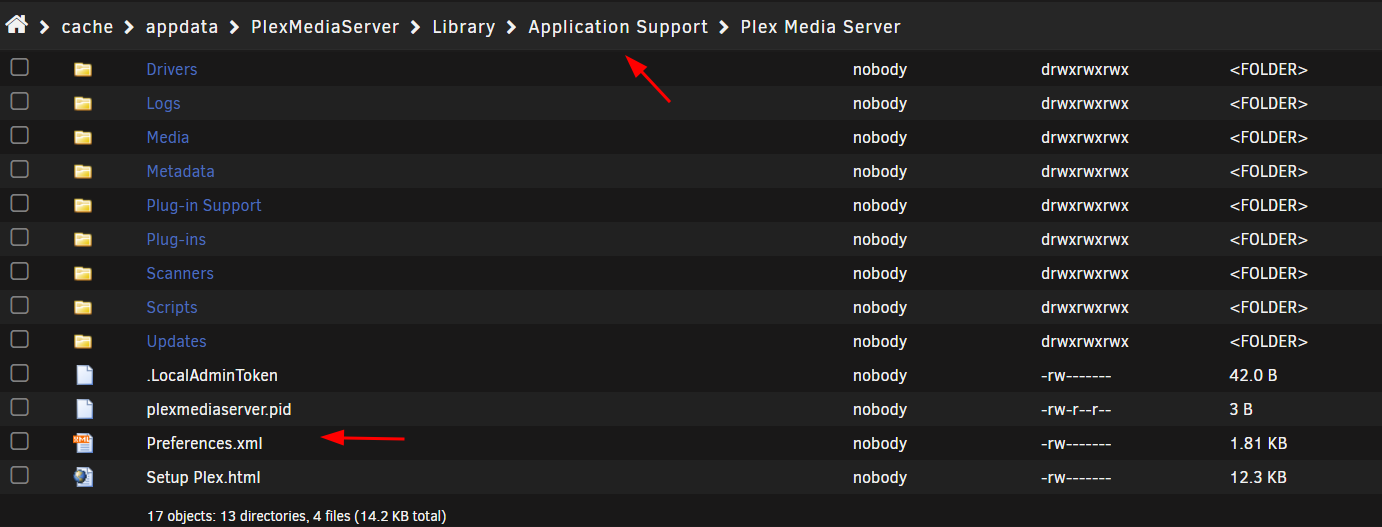

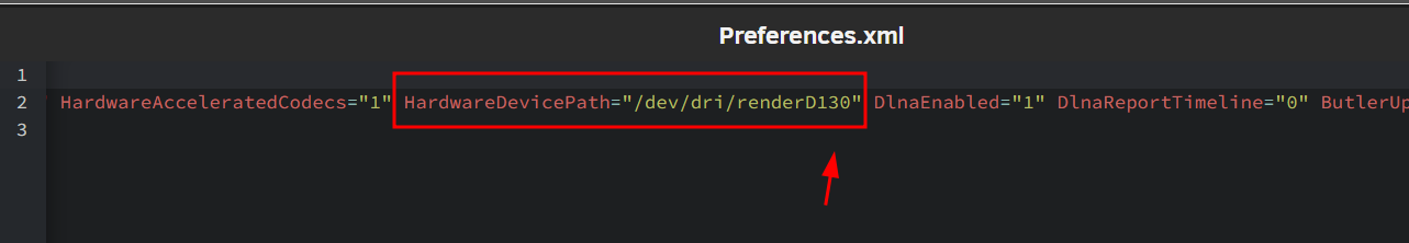

Extra Qs just in case if you have any idea, plex is using wrong GPU now (GPU 0), even though I am adding correct GUID variable (For M2000). Any idea why this happens if you're aware.
thats pretty sure more a plex related question, but may as hint what you could try
there is a preferences.xml file
where you can specify the render device (search for it or add it)
depending on your system its either D128, D129, D130, ...
a simple terminal command will show you all available cards
root@AlsServer:~# ls -la /dev/dri/ren*
crwxrwxrwx 1 nobody users 226, 128 Apr 22 08:00 /dev/dri/renderD128
crwxrwxrwx 1 nobody users 226, 129 Apr 22 08:00 /dev/dri/renderD129
crwxrwxrwx 1 nobody users 226, 130 Apr 22 08:00 /dev/dri/renderD130
root@AlsServer:~#
i have 3 (intel iGPU, NV 3080ti, NV 1060), jest test it through ... be aware, a unraid update can switch the card(s) and Plex aint smart enough to ... so may a manual adjustment would be necessary, Plex Forums would be the place to look for this ;)
