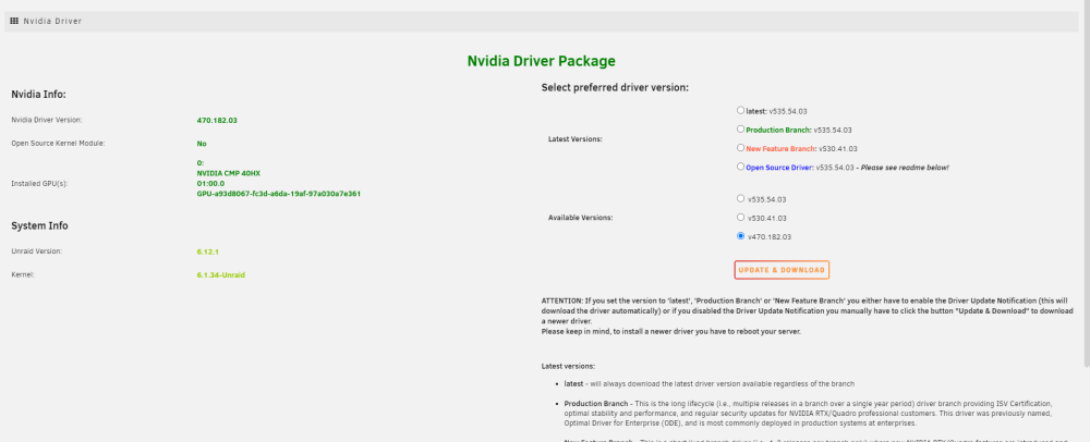

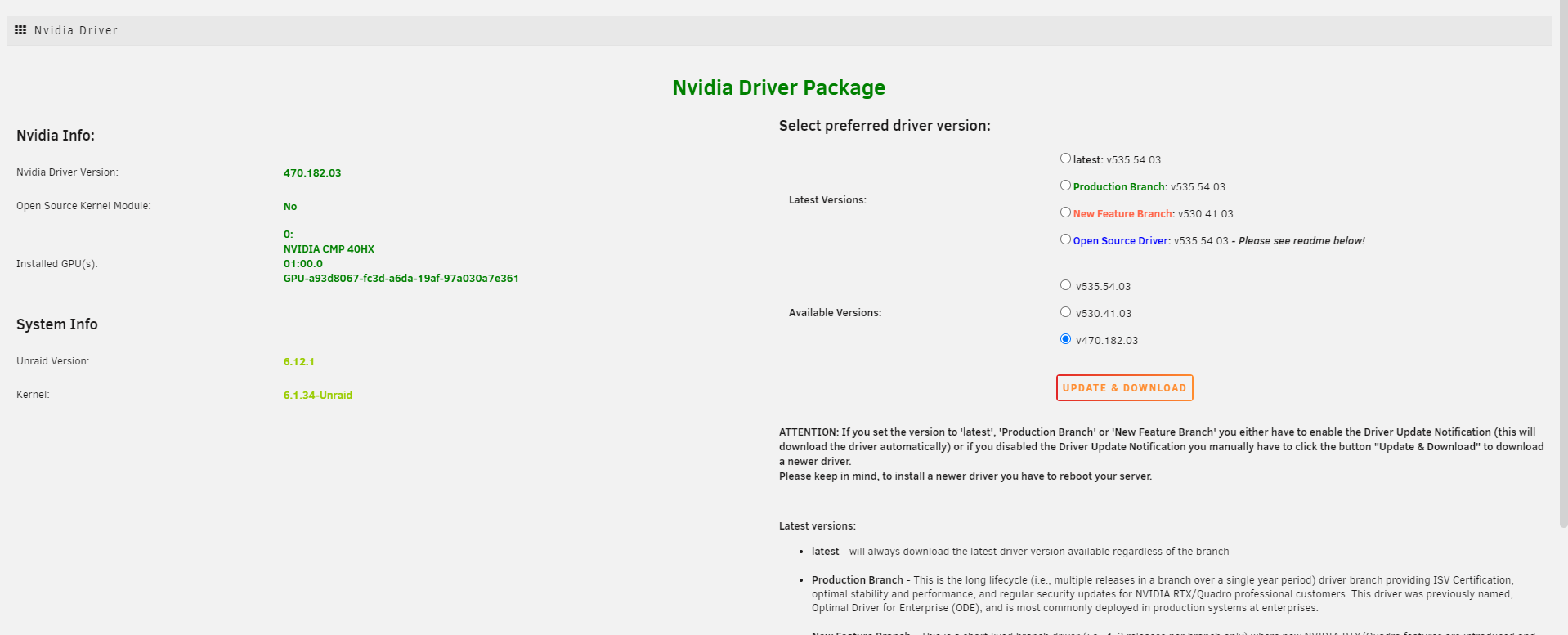

hello every, i'm a new guy from china for unraid.
Formly i got a nvidia CMP 40HX mining card, it composed by specially TU-106 chip with 8GB GDDR6, and modified to support PCIE1.1 x16 by the seller.
that's interesting to use it run games & beachmark at windows platform.
but now i wonder to install it to my unraid server for  AI / CUDA computing (like hashcat docker and etc), but didn't work.
all drivers of the plugin ''nvidia driver'' has didn't identifing this card. there's no any info of this card in plugin interface,
I'm trying to search this problem in google, the other Linux OP like Ubuntu、PVE can manual install correct driver by apt-get, but unraid can't do it like that.
so could you have any plan to add a correct driver? all i just known the 460~490 of offical version and some open source of third party is available.
all thx!
I don't know that card but I know such cards exist.
What is the correct driver? You can install the legacy driver 470.xx in the plugin and of course the latest ones.
If the driver is not publicly available from Nvidia I can't help here because this would violate their EULA.

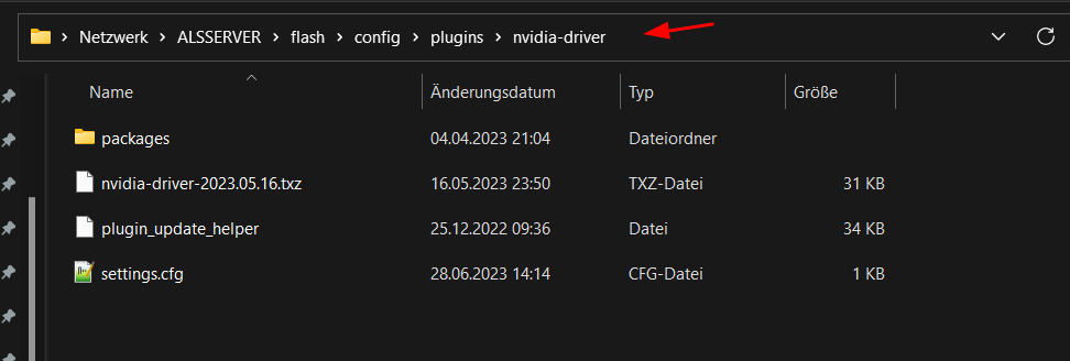

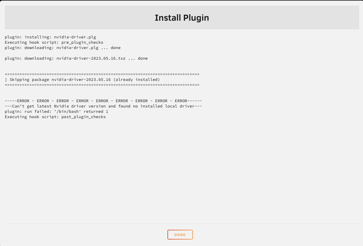

So, I am having trouble now with 6.12.1 and 6.12.2, where the NVIDIA driver / plugin is not showing up, or working at all. It was, but on a restart it vanished. Now it wont instal, and errors out. screen shots and diagnostics attached. Not sure how to force it, or how to uninstall whatever residuals are there. I am kinda at a loss, but willing to work the problem, if anyone has the time.
bonaserv-diagnostics-20230701-2023.zip
Remove the Plugin through the GUI, reboot your server and grab a fresh copy from the CA App.
This should do the trick.
If you tried it multiple times please wait for at least an hour before you try this.
The plugin is not showing in the GUI thats part of the problem
then may remove this folder from your flash drive and reboot and start from scratch
This is nothing to worry about, skip the part with uninstalling and simplay reboot and install a fresh copy from the CA App.
