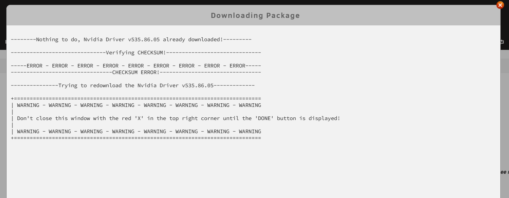

Update to unraid 6.12.3
When you upgrade you should get a Unraid notification which says you should wait until you get another notification that it says it is safe to reboot, in your case the download didn't finish, even the upgrade window should have told you that it found third party packages and you should wait until it says it is safe to reboot.
However, to solve this, please click Update & Download this should re download the driver and the plugin should then tell you to reboot if the download was successful.
3 minutes ago, namida said:
I click to re-download the driver now, but he will always be stuck in this interface. When I just updated unriad, I clicked the update card for more than an hour and there was no change, so I would like to ask if you have a manual installation method, such as the command OK, or I download the driver file on Windows and upload it to unraid
You have to wait until it says it is finished, like the message tells you...
Some users especially from China have really slow download speeds from GitHub (where the packages are located) and this can take some time.
From the Diagnostics that you've uploaded I see that you only have around 88MB from 210MB downloaded.

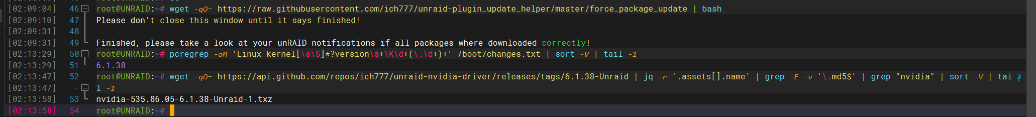

Please execute this command from a Unraid terminal:
wget -qO- https://raw.githubusercontent.com/ich777/unraid-plugin_update_helper/master/force_package_update | bash
This will force a download from all third party plugin packages which are supported by the Plugin Update Helper and you should also see the progress bar and at which speed it is downloading, please let this process finish, it will also show you when it's safe to reboot or better speaking should look like this:
root@Test:~# wget -qO- https://raw.githubusercontent.com/ich777/unraid-plugin_update_helper/master/force_package_update | bash
Please don't close this window until it says finished!
/boot/config/plugins/nvidia-driver/p 100%[====================================================================>] 206.36M  24.5MB/s    in 8.2s
Finished, please take a look at your unRAID notifications if all packages where downloaded correctly!
root@Test:~#
It will take some time after the download finished because it also pulls the md5 sum and compares the downloaded file, this is exactly the same what the Update & Download button does.

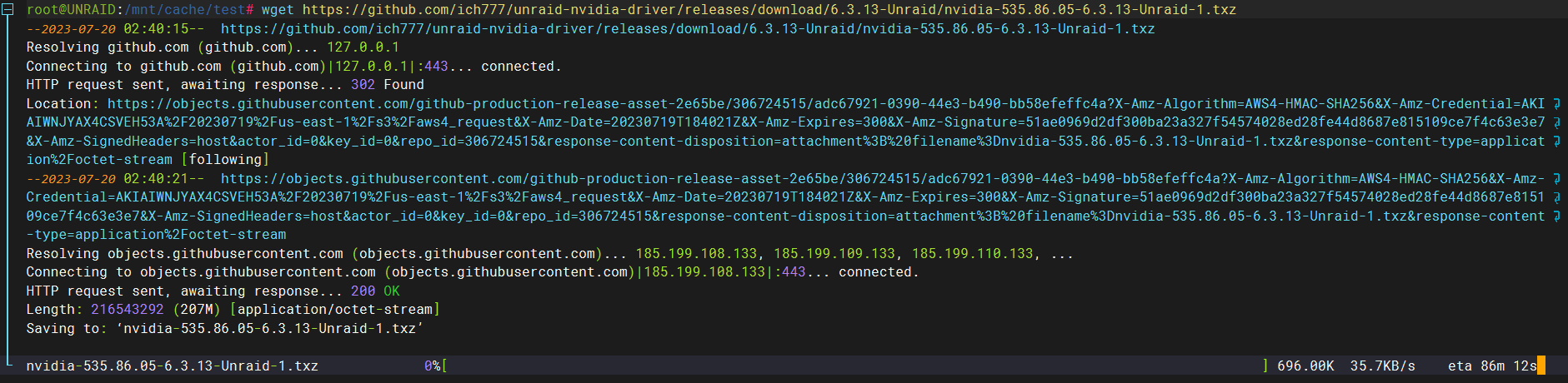

What download speeds do you get with the command that I've sent you?
13 minutes ago, namida said:
Running the command you gave did not give me the output download speed, then I ran the command you replied to the above post, the output is that the driver is downloaded, but the webui prompts that the download is not completed
I really can't tell what's going on over there on your side. Can you download this file?
https://github.com/ich777/unraid-nvidia-driver/releases/download/6.3.13-Unraid/nvidia-535.86.05-6.3.13-Unraid-1.txz
and also this:
https://github.com/ich777/unraid-nvidia-driver/releases/download/6.3.13-Unraid/nvidia-535.86.05-6.3.13-Unraid-1.txz.md5
Please don't delete those files since you will need it.
1 minute ago, namida said:
I can download these two files, but the download speed on the unraid side is very slow, can I use Windows to download these two files now, and then put them in the specified directory?
I gave you the wrong links, sorry, these are not for 6.12.3, here are the correct ones:
https://github.com/ich777/unraid-nvidia-driver/releases/download/6.1.38-Unraid/nvidia-535.86.05-6.1.38-Unraid-1.txz
https://github.com/ich777/unraid-nvidia-driver/releases/download/6.1.38-Unraid/nvidia-535.86.05-6.1.38-Unraid-1.txz.md5
Sorry, this was done by accident.
You have to put them in:
/boot/config/plugins/nvidia-driver/packages/6.1.38/
After that reboot.

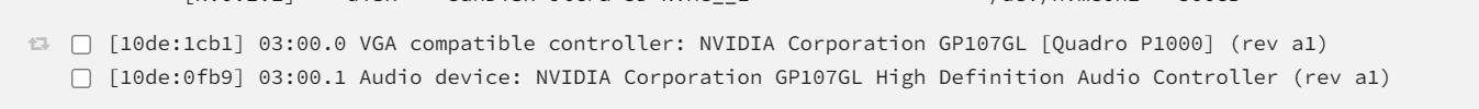

hello, i'm back again!
this time I planed to install a 2080ti 22G(modified) to my unraid sever as you see,it already works by your plugin, thx again!
I installed nvidia driver (version:535.54.03),included CUDA driver Version:12.2 as following:
but I want downgrade it to CUDA 11.8, it's best version for 2080ti when I use it to running at Stable Diffusion WebUI (in docker).
so the problem I wanna asking ,HOW TO downgrade CUDA version to 11.8 , it included in nvidia driver version 520.56.06 , but I can't find it from your plug-in.
Looking for you reply,thx!

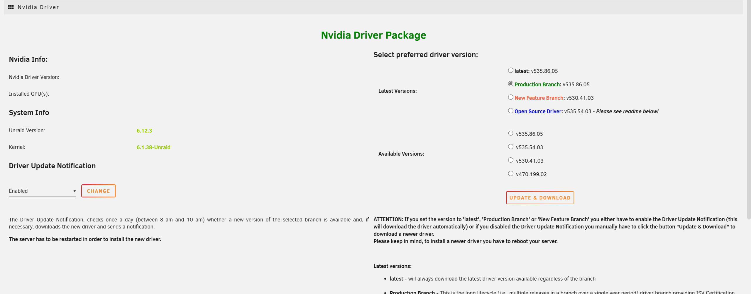

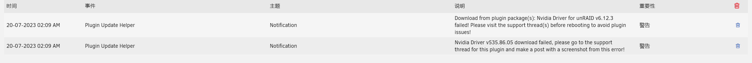

I've just downloaded the Unraid 6.12.3 update, which downloaded fine, but i'm getting an error from the Plugin Updater when it tries to update the Nvidia Plugin. Here's what I see in my Notifications:image.thumb.png.bf7771832a3ceeb1dace4b09de23fc5f.png
I've tried going into the Plugin manually and clicking "Update & Install" but even though I have the Production Branch v535.54.03 selected, it looks like it tries to install v470.182.03image.thumb.png.3eb8d42a3622cbf8f2cd75dffd2e5815.png
Do i just need to sit tight and wait for an update to the Plugin?
Edited by TheUseless
Typo's
No.
Please do the following:
  1. Reboot
  2. Go to the plugin page and install the v470.x driver version
  3. Reboot again
After that it is working again.

While trying to complete step 2 i still got the "Can't download Nvidia Driver Package v470.x" error, but during the reboots it has updated the Driver to v535.86.05.

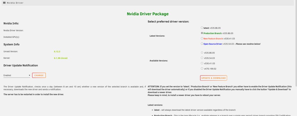

I'm not purposefully trying to use the v470.x driver, It seems like even if i select the Production or Latest release branch, when I click "Update & Download" the download window always shows it trying to download the v470.x driver?image.thumb.png.556ee3915a57c0829fe0c04ac8d5cba3.png
Even though that window shows it trying to download v470.x package, in the SystemLog it does look like it's calling the appropriate update commands:
cmd: /usr/local/emhttp/plugins/nvidia-driver/include/exec.sh update_version latest
cmd: /usr/local/emhttp/plugins/nvidia-driver/include/exec.sh update_version latest_prb
Please post your Diagnostics if you have any further issues. Do you have pialert installed? They have a bug in their software which eats up all your GitHub API (which I make heavily use in my Plugins/Containers) and prevent the download.
Do you have any AdBlocking on your network? Please make sure that you don't block github.com and api.github.com
Sorry newbie error, diagnostics slipped my mind completely - I don't have PiAlert installed and there shouldn't be any adblocking/github API usage that I can think of, but I'll have more of a look and see what other containers/plugins could be causing a blocker.
