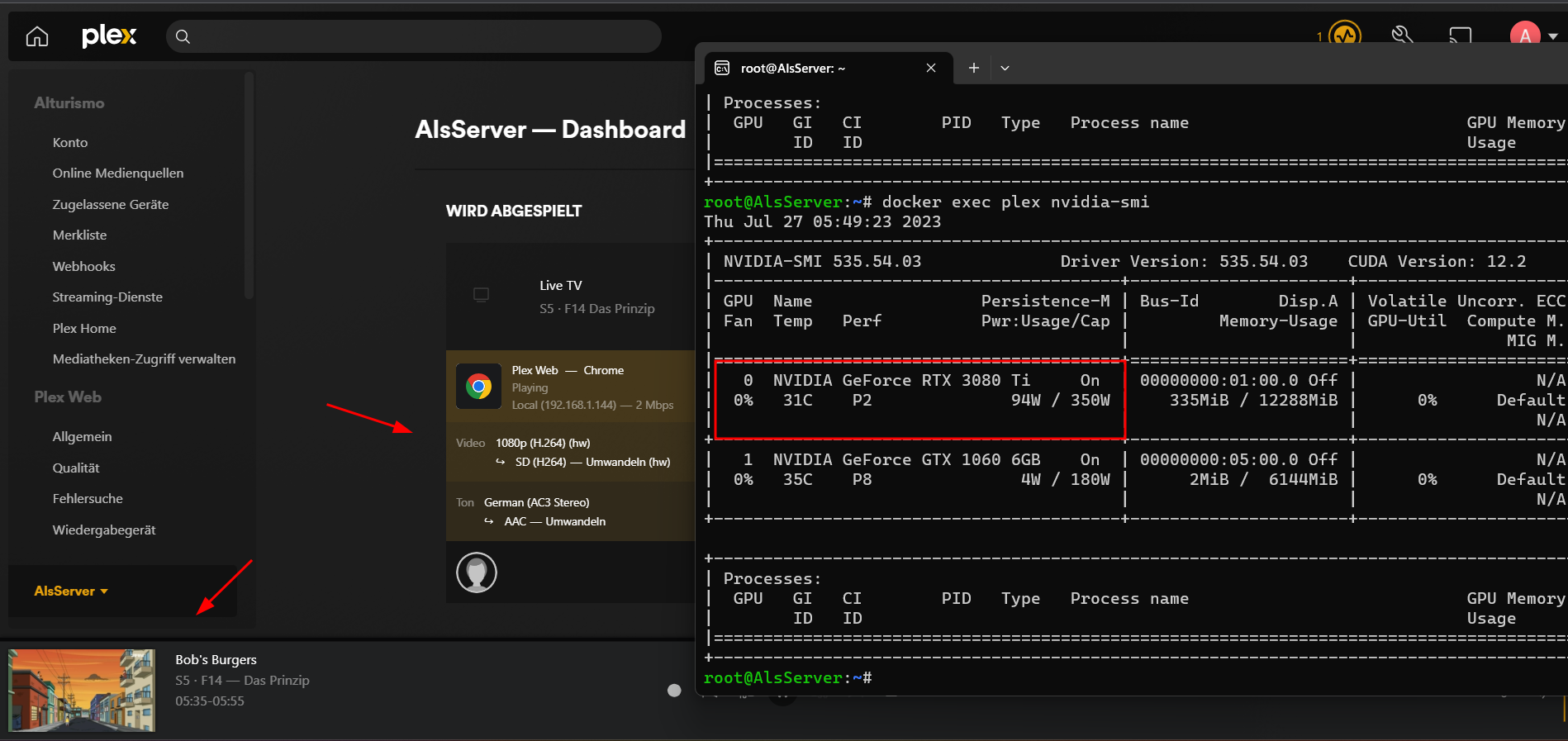

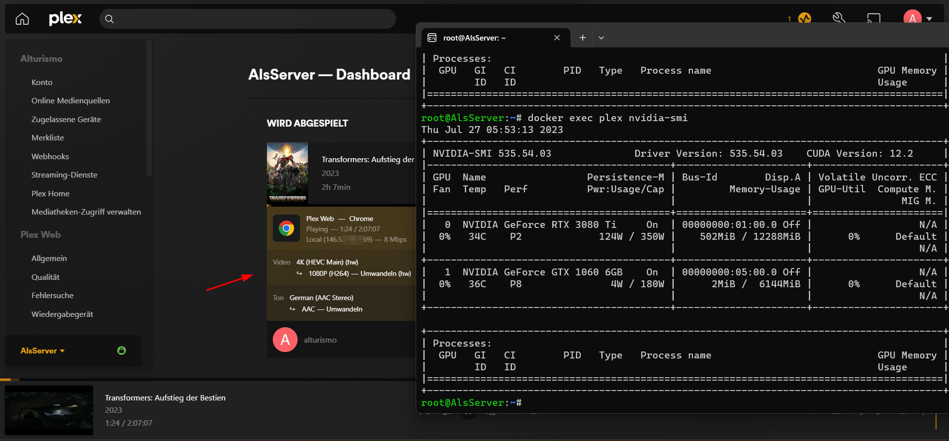

@Jase i still can confirm its working flawlessly here, tested now with both cards here
GTX1060 card 1
RTX3080ti card 0
h264 and hevc tested, also live tv ... so overall i wouldnt say its a plugin issue, even not a plex issue ...
running plexinc Docker and as you see upper latest nvidia driver package ...

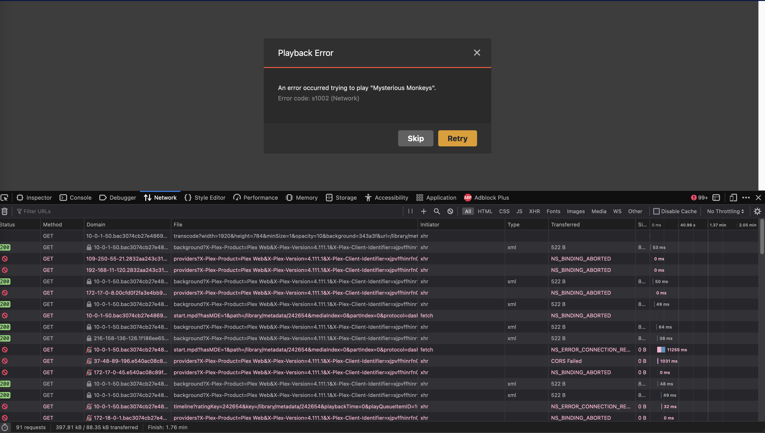

On 8/1/2023 at 11:31 AM, Jase said:
@raftriderwere you able to get any help on this over on the Plex forums?
Nope, but I didn't try tbh. Everything is working now except for the plex web transcoding.
