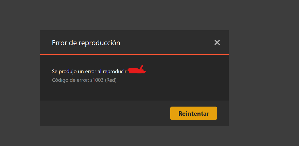

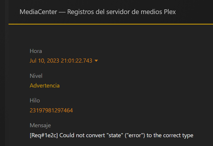

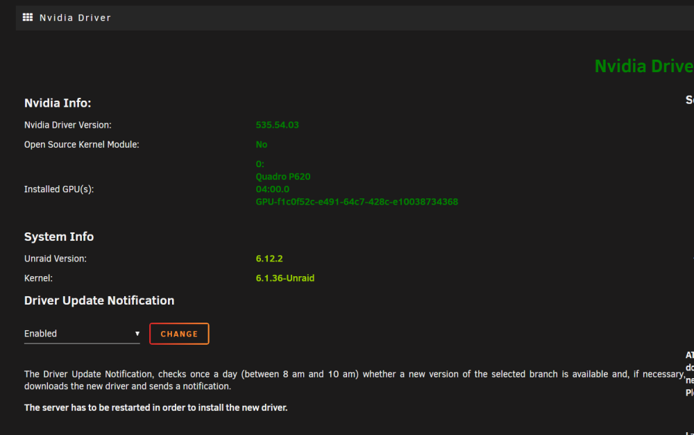

Since I installed 6.12.2 nvidia stoped working in my containers like plex or frigate, when I try to use it I get errors and crashes
plugin ver 2023.07.06
in frigate I get ffmpeg errors due to the H264 decoder using nvidia GPU
error in plex when transcoding
All this was working fine before. I haven't changed anything not in the docker run, not in the apps config. Any idea what the problem could be?

2 hours ago, L0rdRaiden said:
@SpencerJ could this be related with the issue you mention here?
This is already solved with Plugin version 2023.07.06

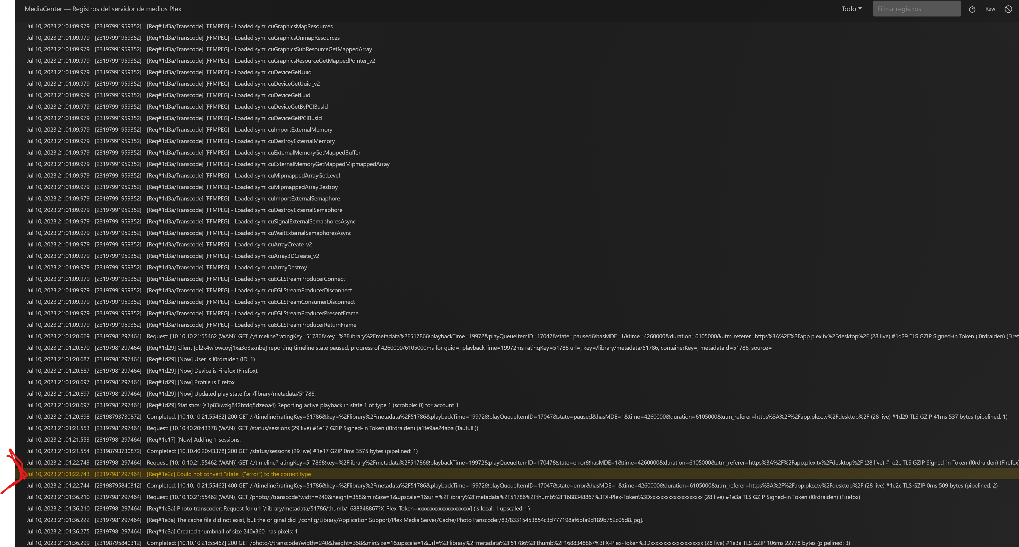

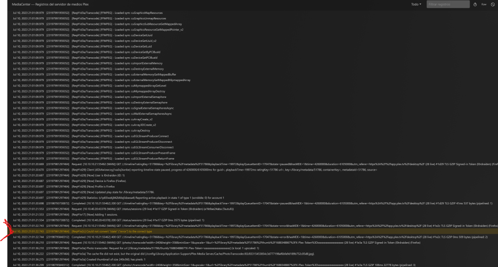

Can you please be a bit more specific? Where do you get errors and where do you get crashes? What does crash exactly?
Do you have a way to test the card other than in your server? I see nothing obvious in your syslogs why it shouldn't work.
Have you yet tried to reboot your system?
For plex there is nothing in the logs, just the error in the screenshot above when I try to use transcoding
From what I found from searching the error s1003 on Google it seems that this is either a issue with the database or the network?

This is plex app logs while reproducing the error, the error below is what i get every time I try to transcode I get the popup error.
imagen.png.e9c82dd66d370218c9f0abd9f9cc2f3b.pngimagen.thumb.png.0557c8fa8033fefdfbbd58a5e9b1da8b.png
Regarding your comments frigate, the network is fine because as soon as I disable gpu decoding everything works. While using gpu decoding I can access the cameras using other tools and works. ANyway I'm going to do the changes you proposed to see if something changes, considering that it affects to plex as well, and I have the same problem with plex even if frigate is stopped...
thanks for you help. Maybe is something with my config... but I don't even know where to start to troubleshoot it, and the logs don't tell a lot.
All I know is that it only happens when the container try to use the GPU for something
Can you post the transcoding logs too?

Then I clean the logs folder of plex, I started plex, I reproduced the issue, and here are the logs and also screenshots of nvidia-smi while trying to transcode.
Maybe the card died but apparently it's working...
Logs.zip
Wait, are you using the the WebClient from Plex to transcode a movie? Can you try to use a native app like for Android or iOS and see if it is working there if you force a transcode?

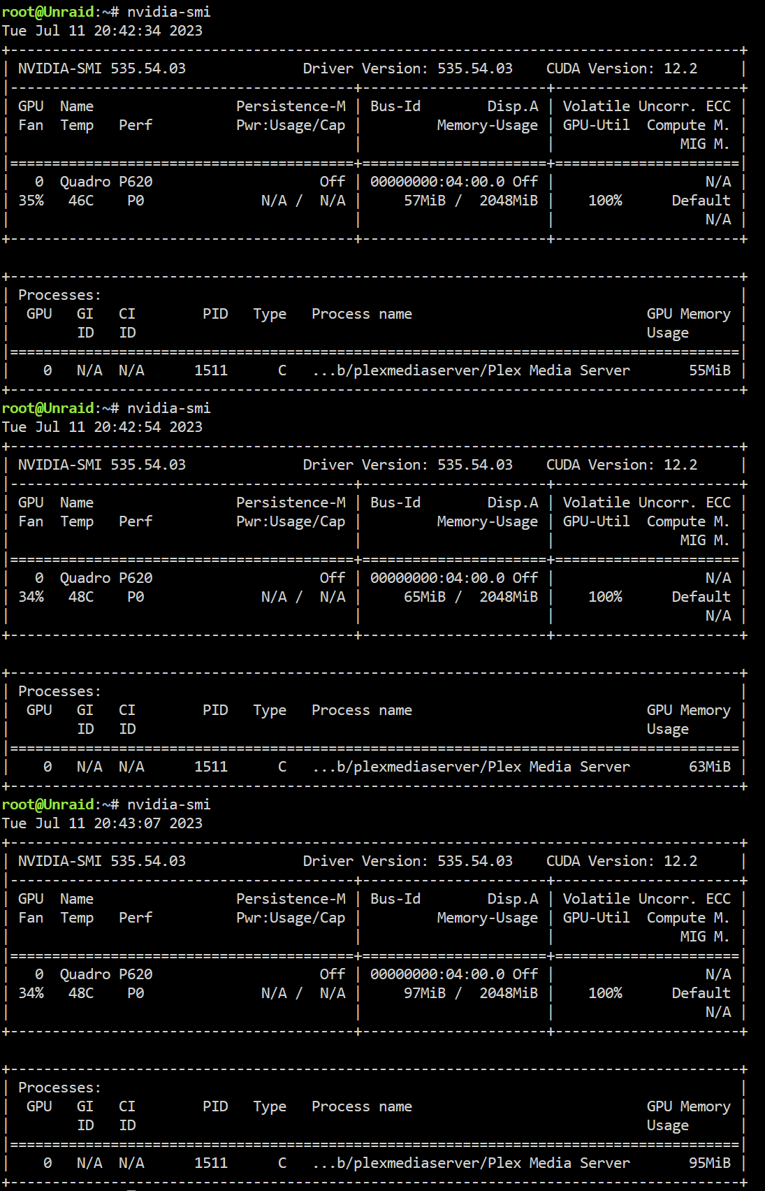

What happens when you stop the transcode? Can you post a screenshot from nvidia-smi if nothing is using the GPU please?

your logs looks a little weird while plex is trying to use vaapi (intel /amd) before nvenc ...
may try to delete the codecs dir from plex and restart the docker, also may try another browser to test playback (or a native client and force transcoding like mentioned from @ich777)
also may try without your ramdisk as transcoding path for testing, i know some DTS streams needs some insane high ramdisk free space (whyever)
