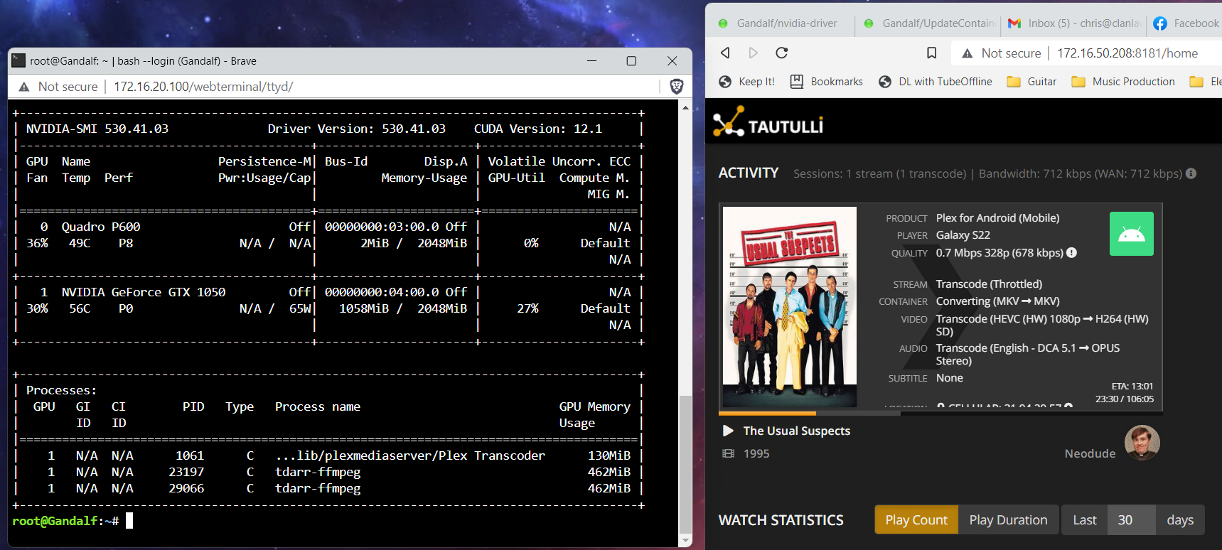

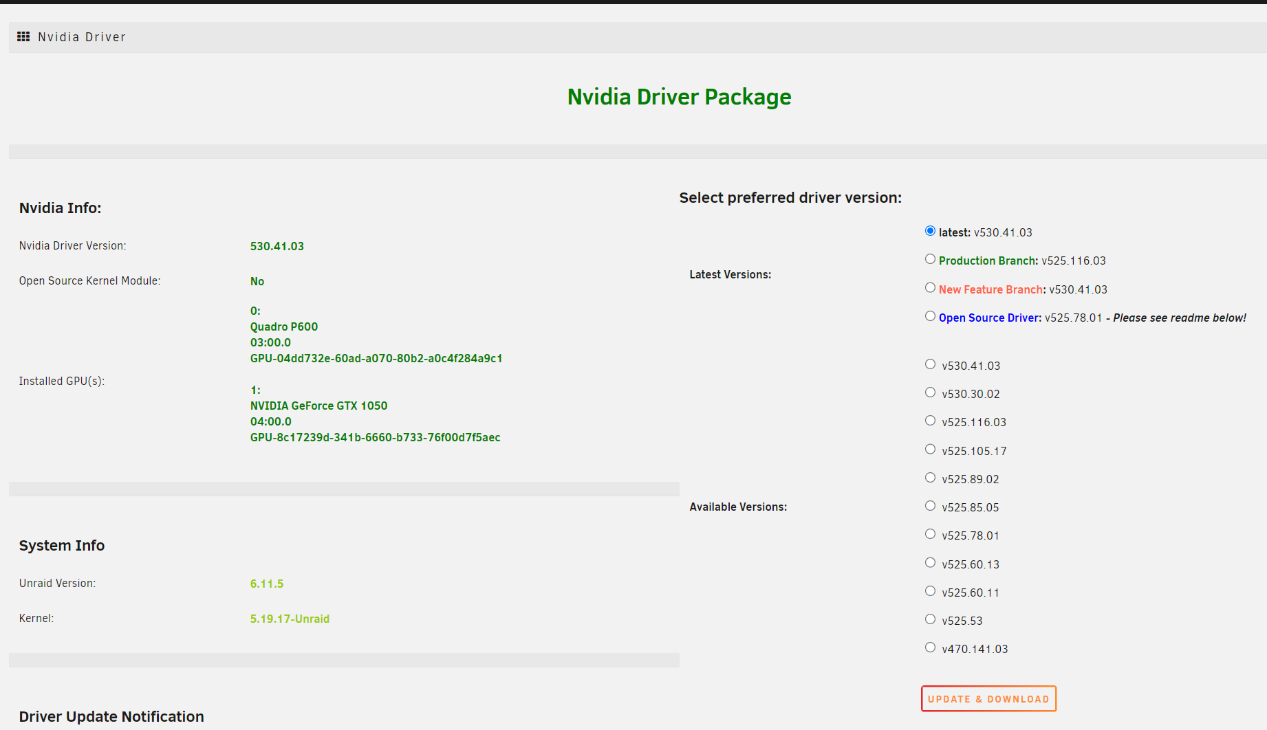

Hey folks,
I have a strange issue. I have 2 GPUs installed in my system, a Quadro P600, and a GTX 1050. These are both recognised by the Nvidia Driver plugin. I have the correct ID setup in both the TDARR and Plex docker containers for the P600, but they both still insist on using the 1050.
Any Ideas?

13 hours ago, NeoDude said:
Any Ideas?
Since when does this happen?
Have you yet tried to assign the other UUID, but this shouldn't make a difference since the UUIDs are correct from what I see from the Diagnostics).
I would also recommend that you check your VFIO bindings since it tries to bind 04:00 (which is your GTX1050 but it fails since the HW/VENDOR ID doesn't match - /boot/config/vfio-pci.cfg):
Processing 0000:04:00.0 1002:67df
Error: Vendor:Device 1002:67df not found at 0000:04:00.0, unable to bind device
Processing 0000:04:00.1 1002:aaf0
Error: Vendor:Device 1002:aaf0 not found at 0000:04:00.1, unable to bind device
Can you please also post the docker run command?
I would strongly recommend that you disable Privileged mode? Why did you even enable this? This is a huge security risk and can maybe cause this issue.
I've deleted the unrequired VFIO Bindings. These weren't checked in the GUI so I don't know why they were in there. I have also disabled Privileged mode. (This was a recent thing to see if it made a difference). After a reboot, Plex is now using the correct GPU, but TDARR is not. Here's the Docker Run for TDARR...

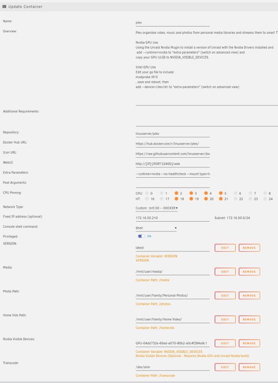

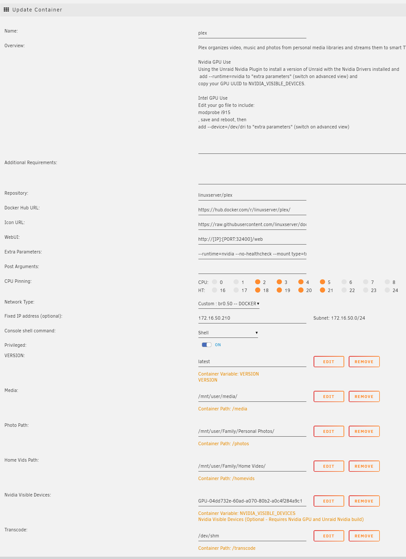

I‘m not entirely sure but if TDARR changes a environment variable on container start to use all GPUs that could be the reason why, but this is only a guess and I don‘t know if that‘s the case here but it would be possible that something like this is causing the issue here.
Think I found the issue. There was a missing underscore in the "NVIDIA_VISIBLE_DEVICES" key. Not sure if this is default on the container or if it's something I've accidently done, probably the latter :P

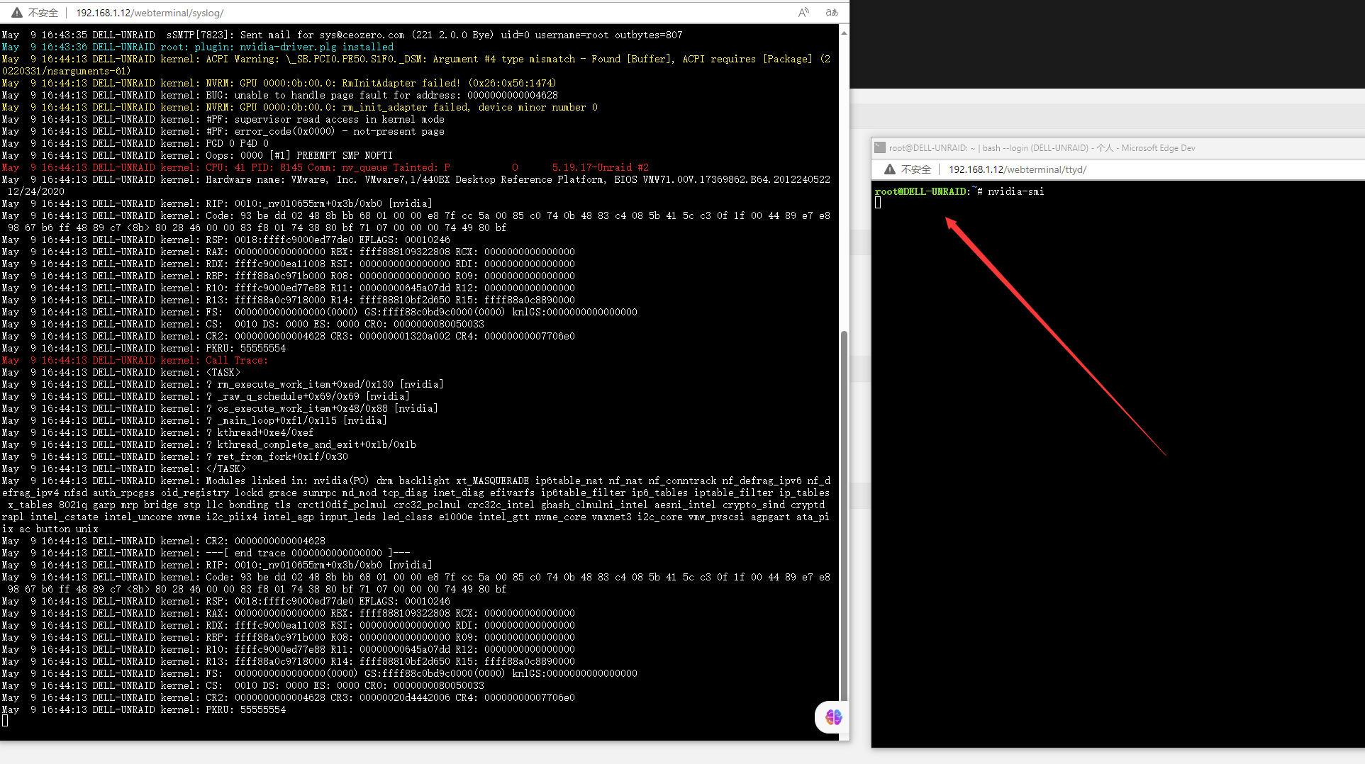

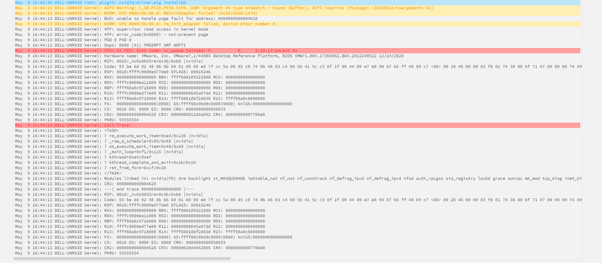

After updating from rtx750 to 1660s, it cannot be driven normally, and it cannot work after reinstalling or using a new system.
My unraid work has been under esxi for two years. I have always used rtx750 for emby, and now I can no longer drive it after updating to 1660s, nvidia-smi crashes directly, and the command freezes. It is also impossible to output the report, because nvidia-smi cannot output it.
May 9 16:43:36 DELL-UNRAID root: plugin: nvidia-driver.plg installed May 9 16:44:13 DELL-UNRAID kernel: ACPI Warning: \_SB.PCI0.PE50.S1F0._DSM: Argument #4 type mismatch - Found [Buffer], ACPI requires [Package] (20220331/nsarguments-61) May 9 16:44:13 DELL-UNRAID kernel: NVRM: GPU 0000:0b:00.0: RmInitAdapter failed! (0x26:0x56:1474) May 9 16:44:13 DELL-UNRAID kernel: BUG: unable to handle page fault for address: 0000000000004628 May 9 16:44:13 DELL-UNRAID kernel: NVRM: GPU 0000:0b:00.0: rm_init_adapter failed, device minor number 0 May 9 16:44:13 DELL-UNRAID kernel: #PF: supervisor read access in kernel mode May 9 16:44:13 DELL-UNRAID kernel: #PF: error_code(0x0000) - not-present page May 9 16:44:13 DELL-UNRAID kernel: PGD 0 P4D 0 May 9 16:44:13 DELL-UNRAID kernel: Oops: 0000 [#1] PREEMPT SMP NOPTI May 9 16:44:13 DELL-UNRAID kernel: CPU: 41 PID: 8145 Comm: nv_queue Tainted: P O 5.19.17-Unraid #2 May 9 16:44:13 DELL-UNRAID kernel: Hardware name: VMware, Inc. VMware7,1/440BX Desktop Reference Platform, BIOS VMW71.00V.17369862.B64.2012240522 12/24/2020 May 9 16:44:13 DELL-UNRAID kernel: RIP: 0010:_nv010655rm+0x3b/0xb0 [nvidia] May 9 16:44:13 DELL-UNRAID kernel: Code: 93 be dd 02 48 8b bb 68 01 00 00 e8 7f cc 5a 00 85 c0 74 0b 48 83 c4 08 5b 41 5c c3 0f 1f 00 44 89 e7 e8 98 67 b6 ff 48 89 c7 <8b> 80 28 46 00 00 83 f8 01 74 38 80 bf 71 07 00 00 00 74 49 80 bf May 9 16:44:13 DELL-UNRAID kernel: RSP: 0018:ffffc9000ed77de0 EFLAGS: 00010246 May 9 16:44:13 DELL-UNRAID kernel: RAX: 0000000000000000 RBX: ffff888109322808 RCX: 0000000000000000 May 9 16:44:13 DELL-UNRAID kernel: RDX: ffffc9000ea11008 RSI: 0000000000000000 RDI: 0000000000000000 May 9 16:44:13 DELL-UNRAID kernel: RBP: ffff88a0c971b000 R08: 0000000000000000 R09: 0000000000000000 May 9 16:44:13 DELL-UNRAID kernel: R10: ffffc9000ed77e88 R11: 00000000645a07dd R12: 0000000000000000 May 9 16:44:13 DELL-UNRAID kernel: R13: ffff88a0c9718000 R14: ffff88810bf2d650 R15: ffff88a0c8890000 May 9 16:44:13 DELL-UNRAID kernel: FS: 0000000000000000(0000) GS:ffff88c0bd9c0000(0000) knlGS:0000000000000000 May 9 16:44:13 DELL-UNRAID kernel: CS: 0010 DS: 0000 ES: 0000 CR0: 0000000080050033 May 9 16:44:13 DELL-UNRAID kernel: CR2: 0000000000004628 CR3: 000000001320a002 CR4: 00000000007706e0 May 9 16:44:13 DELL-UNRAID kernel: PKRU: 55555554 May 9 16:44:13 DELL-UNRAID kernel: Call Trace: May 9 16:44:13 DELL-UNRAID kernel: <TASK> May 9 16:44:13 DELL-UNRAID kernel: ? rm_execute_work_item+0xed/0x130 [nvidia] May 9 16:44:13 DELL-UNRAID kernel: ? _raw_q_schedule+0x69/0x69 [nvidia] May 9 16:44:13 DELL-UNRAID kernel: ? os_execute_work_item+0x48/0x88 [nvidia] May 9 16:44:13 DELL-UNRAID kernel: ? _main_loop+0xf1/0x115 [nvidia] May 9 16:44:13 DELL-UNRAID kernel: ? kthread+0xe4/0xef May 9 16:44:13 DELL-UNRAID kernel: ? kthread_complete_and_exit+0x1b/0x1b May 9 16:44:13 DELL-UNRAID kernel: ? ret_from_fork+0x1f/0x30 May 9 16:44:13 DELL-UNRAID kernel: </TASK> May 9 16:44:13 DELL-UNRAID kernel: Modules linked in: nvidia(PO) drm backlight xt_MASQUERADE ip6table_nat nf_nat nf_conntrack nf_defrag_ipv6 nf_defrag_ipv4 nfsd auth_rpcgss oid_registry lockd grace sunrpc md_mod tcp_diag inet_diag efivarfs ip6table_filter ip6_tables iptable_filter ip_tables x_tables 8021q garp mrp bridge stp llc bonding tls crct10dif_pclmul crc32_pclmul crc32c_intel ghash_clmulni_intel aesni_intel crypto_simd cryptd rapl intel_cstate intel_uncore nvme i2c_piix4 intel_agp input_leds led_class e1000e intel_gtt nvme_core vmxnet3 i2c_core vmw_pvscsi agpgart ata_piix ac button unix May 9 16:44:13 DELL-UNRAID kernel: CR2: 0000000000004628 May 9 16:44:13 DELL-UNRAID kernel: ---[ end trace 0000000000000000 ]--- May 9 16:44:13 DELL-UNRAID kernel: RIP: 0010:_nv010655rm+0x3b/0xb0 [nvidia] May 9 16:44:13 DELL-UNRAID kernel: Code: 93 be dd 02 48 8b bb 68 01 00 00 e8 7f cc 5a 00 85 c0 74 0b 48 83 c4 08 5b 41 5c c3 0f 1f 00 44 89 e7 e8 98 67 b6 ff 48 89 c7 <8b> 80 28 46 00 00 83 f8 01 74 38 80 bf 71 07 00 00 00 74 49 80 bf May 9 16:44:13 DELL-UNRAID kernel: RSP: 0018:ffffc9000ed77de0 EFLAGS: 00010246 May 9 16:44:13 DELL-UNRAID kernel: RAX: 0000000000000000 RBX: ffff888109322808 RCX: 0000000000000000 May 9 16:44:13 DELL-UNRAID kernel: RDX: ffffc9000ea11008 RSI: 0000000000000000 RDI: 0000000000000000 May 9 16:44:13 DELL-UNRAID kernel: RBP: ffff88a0c971b000 R08: 0000000000000000 R09: 0000000000000000 May 9 16:44:13 DELL-UNRAID kernel: R10: ffffc9000ed77e88 R11: 00000000645a07dd R12: 0000000000000000 May 9 16:44:13 DELL-UNRAID kernel: R13: ffff88a0c9718000 R14: ffff88810bf2d650 R15: ffff88a0c8890000 May 9 16:44:13 DELL-UNRAID kernel: FS: 0000000000000000(0000) GS:ffff88c0bd9c0000(0000) knlGS:0000000000000000 May 9 16:44:13 DELL-UNRAID kernel: CS: 0010 DS: 0000 ES: 0000 CR0: 0000000080050033 May 9 16:44:13 DELL-UNRAID kernel: CR2: 0000000000004628 CR3: 00000020d4442006 CR4: 00000000007706e0 May 9 16:44:13 DELL-UNRAID kernel: PKRU: 55555554
Have you yet tried to install the legacy driver version 470.xx, reboot and see if that version is working for you?
Can you please post the full Diagnostics?
When virtualizing via ESXi I think you have to add a parameter if I'm not mistaken so that newer cards will work.

Sorry, I can't output diagnostics with plugins installed. Because the nvidia-smi output is used for diagnostics. As long as nvidia-smi is used, it will be stuck. Cannot output diagnostics.
dell-unraid-diagnostics-20230509-2128.zip
As said above I think you have to add some parameters in ESXi so that newer cards are working, this is not the first time I see that.
Also please remove these two files from your modprobe.d folder: blacklist-nouveau.conf and nvidia.conf (why did you even do that?)
This is the part why it doesn't work:
0b:00.0 VGA compatible controller [0300]: NVIDIA Corporation TU116 [GeForce GTX 1660 SUPER] [10de:21c4] (rev a1)
    DeviceName: pciPassthru0
    Subsystem: Shenzhen Colorful Yugong Technology and Development Co. TU116 [GeForce GTX 1660 SUPER] [7377:0000]
    Kernel driver in use: nvidia
    Kernel modules: nvidia_drm, nvidia
ESXi does something to the device names and I think that was the issue the last time too.
The last user who reported that switched from ESXi to a native installation and it worked after that. Please also keep in mind that some hardware combinations and the 1660s series are complicated... at least on Linux.
Please look into the Visualizing Unraid subforums, there you should find the answer what you have to add to the ESXi host that the card will work without a Kernel Panic.
EDIT: I found that:
But there is nothing I can do about that since you are visualizing Unraid and this could cause issues, I also really can't help since I'm not familiar with ESXi (just search for ESXi in this thread and you will find a few posts, some even stating that drivers >=460 not working with ESXi).

Hi @ich777 - switching the PCIe port and it's now working with the latest driver. Plex transcoding is also working. Thanks for the kick in the rear :D I've attached diagnostics in case you needed to review.
EDIT: I found that:
grateful!
blacklist-nouveau.conf is a shielded driver that comes with esxi.
nvidia.conf is to set the PCI passthrough as the first choice.
After a few days of testing, I found out that this is not an esxi problem. It is not a question of whether to add parameters. I guess this should be some kind of limitation made by the nvidia driver,
I don't know how to use unraid to compile and install the driver, so I used esxi to virtualize a debian11, kernel 5.10.0-22-amd64, I downloaded countless nvidia drivers to compile and install for the kernel, and found the minimum version that can be used normally It's 470.82.01.
Excuse me, is it possible to compile a 470.82.01 driver for our group of esxi users?
If not, is my only solution to fallback to unraid_6.9.2?
