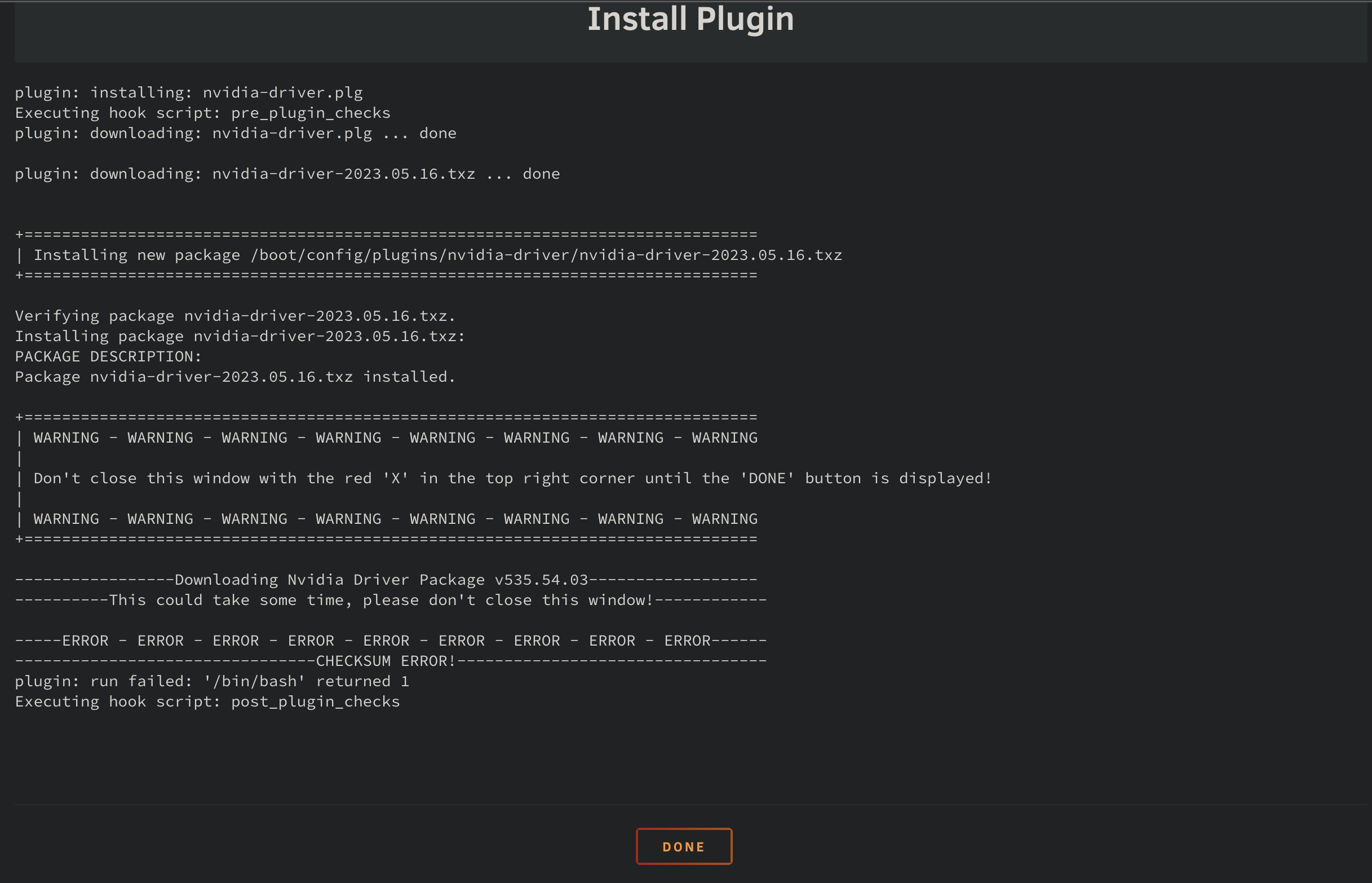

When I try to install the latest from the plugin, I get this error:
The Nvidia drivers page points me to this driver for Linux 64bit which is fairly recent (March 2023)
However, when I use the plugin, the only 470.xxx one that it provides is the one at the bottom: v470.141.03
I want to be able to use this card with Docker for apps that use the "--runtime=nvidia" parameter like stable-diffusion etc. that detect the NVIDIA GPU and ask for its GPUID e.g. GPU-xxxxxxx-xxxx-xxxx-xxxx-xxxxxxx.
Is this something that can be supported?
Edited by frakman1
Without the Diagnostics I can't say anything. It is most likely the case that there is something else preventing the card from showing up.

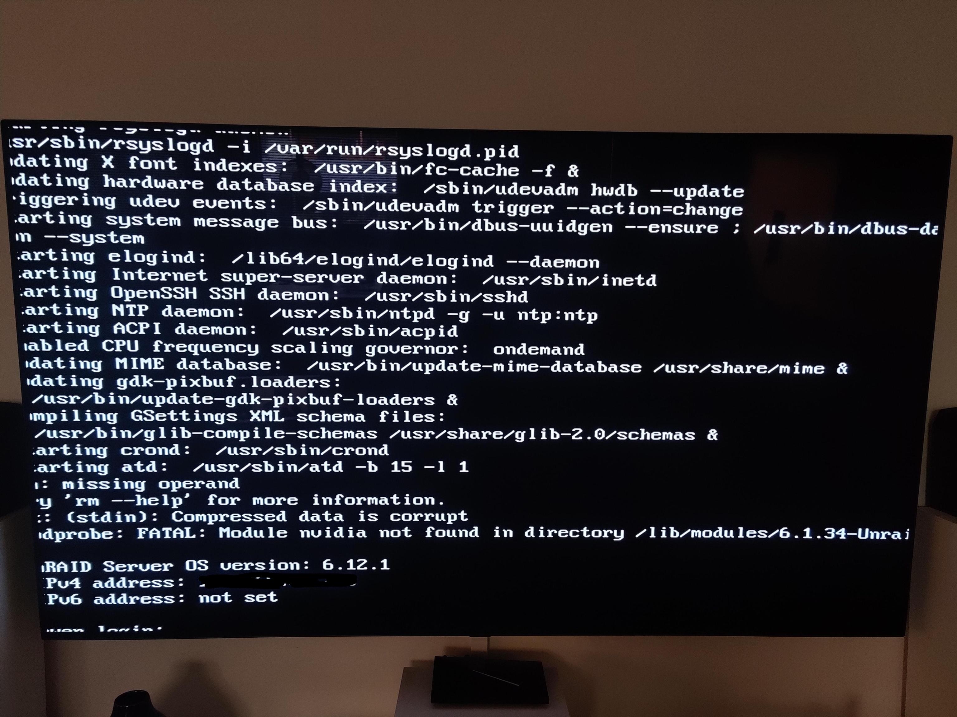

Hi there!
After the latest update of the plugin including an update of Unraid to 6.12.1 and the latest nvidia driver, it seems my graphics card no longer shows up.
Keeps displaying the driver as being corrupt on the boot screen, even after multiple re-installs, re-downloads of various driver versions and reboots - without any success.
I don't have any Adguard or the like on my home network.
Worth noting I have also reinstalled Unraid on my USB flash drive, only keeping the config folder.
Hope someone can help me narrow down my problem :)
tower-diagnostics-20230621-1834.zip
Where does it say this, do you have a screenshot please?
The driver size seems correct to me and I don't think the checksum is wrong.
Have you yet tried just to reboot after verifying the checksums? From what I can tell from your syslog it wasn't downloaded and installed later on in the boot process.
This is the response I get:
FATAL: Module nvidia not found in directory /lib/modules.....
I deleted the plugin. Went to download it again and now it won't let me download it.
Just rebooted the system as well and same response :-((

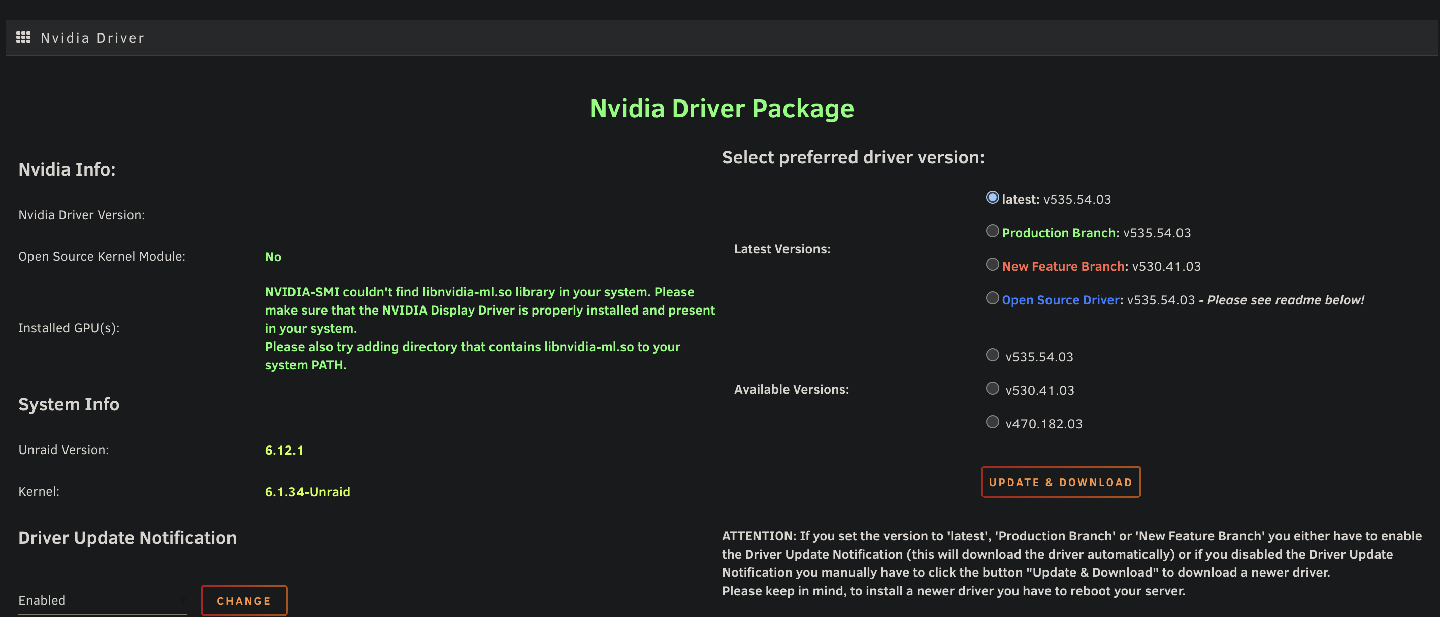

Okay. So through the power of rebooting again again I managed to download the plugin and get confirmation that the driver had been installed. I pressed the "done" button and went for another reboot to finalize the install.
This is what the plugin displays once booted into Unraid.
The usual way is that you remove the plugin, then reboot and then reinstall the plugin again and reboot again.
Please post your Diagnostics, this is completely different from before.

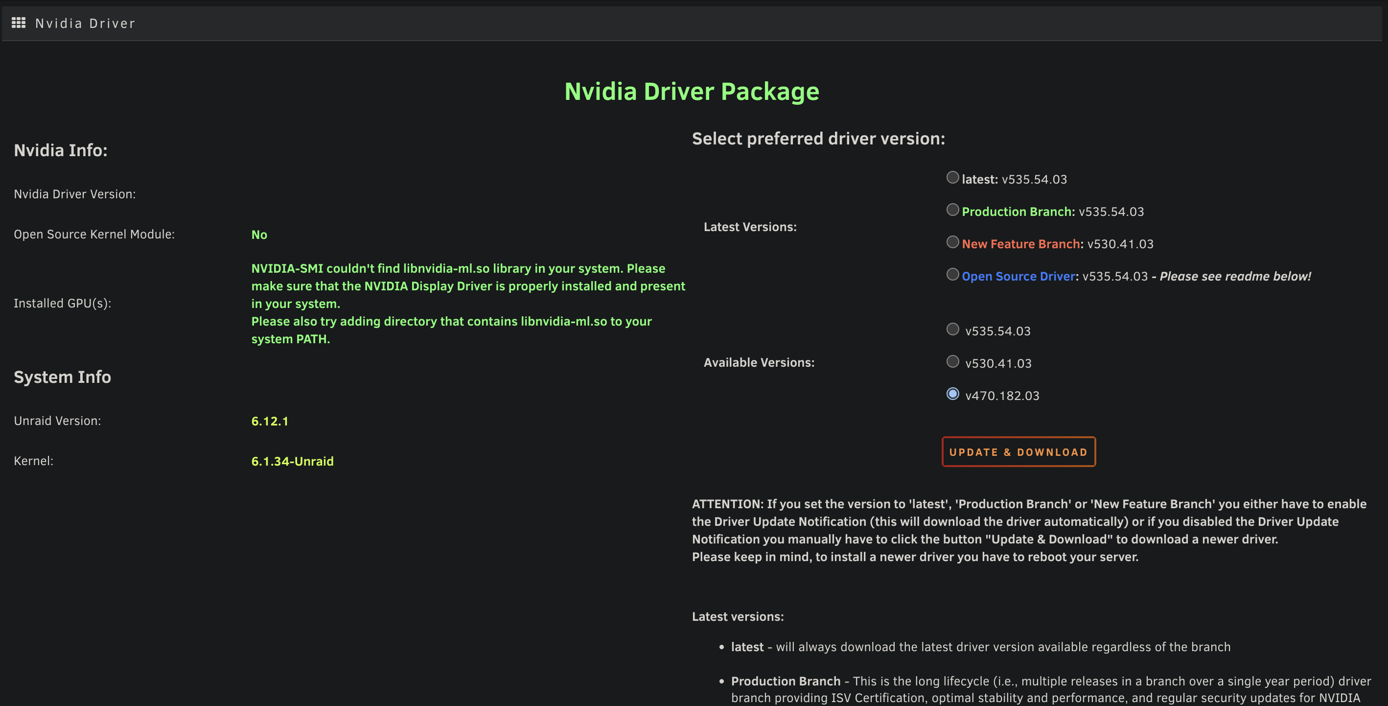

So the Unraid UI froze and crashed before I was able to download the diagnostics and I was forced to reboot once again.
I managed to take a picture of the boot which might point us in the direction of the problem.
The "NVIDIA-SMI..." no longer shows up in the plugin after having logged back in.
Again, really appreciate the help here:)
tower-diagnostics-20230621-2056.zip
These Diagnostics are the same as before, the driver did not install for whatever reason on your system even if it tells it in the syslog.
The message on boot just tells you that the driver package did not install
I need the Diagnostics when the plugin reports that "nvidia-smi is not able..."
Do the following:
  1. Uninstall the plugin
  2. Reboot
  3. Pull a fresh copy from the plugin from the CA App
  4. Reboot
  5. The plugin should report that nvidia-smi failed -> pull the Diagnostics imitatively and post them here
Did you change anything in the BIOS, did you maybe do a BIOS update or anything similar, was it always the case that you've booted into UEFI instead of Legacy mode?
Please check also if you have C-States in the BIOS disabled -> this causes mostly issues with Nvidia cards.

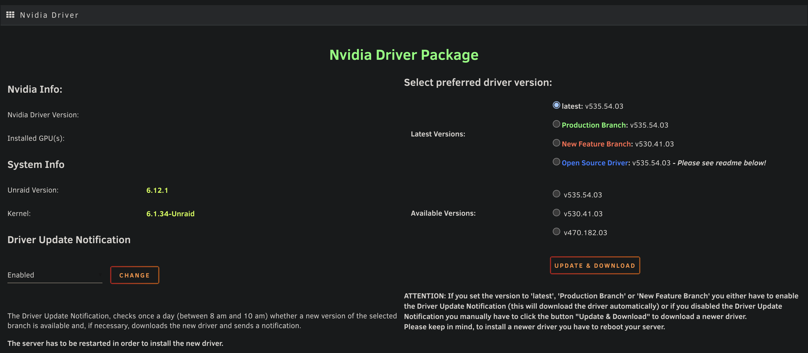

Okay! So I replicated the nvidia-smi fail scenario and attached the diagnostics below.
No I haven't changed any BIOS settings recently and have always booted into UEFI. Would you recommend booting in Legacy mode instead?
Will check C-states in BIOS when I get home but haven't touched or had any problems with it before :-/
I have to look into that issue when I got home from work.

BTW just because I noticed it, don't switch between various driver version since this won't magically solve your issue, stick to the latest one by switching it makes diagnosing the issue much harder for me.
