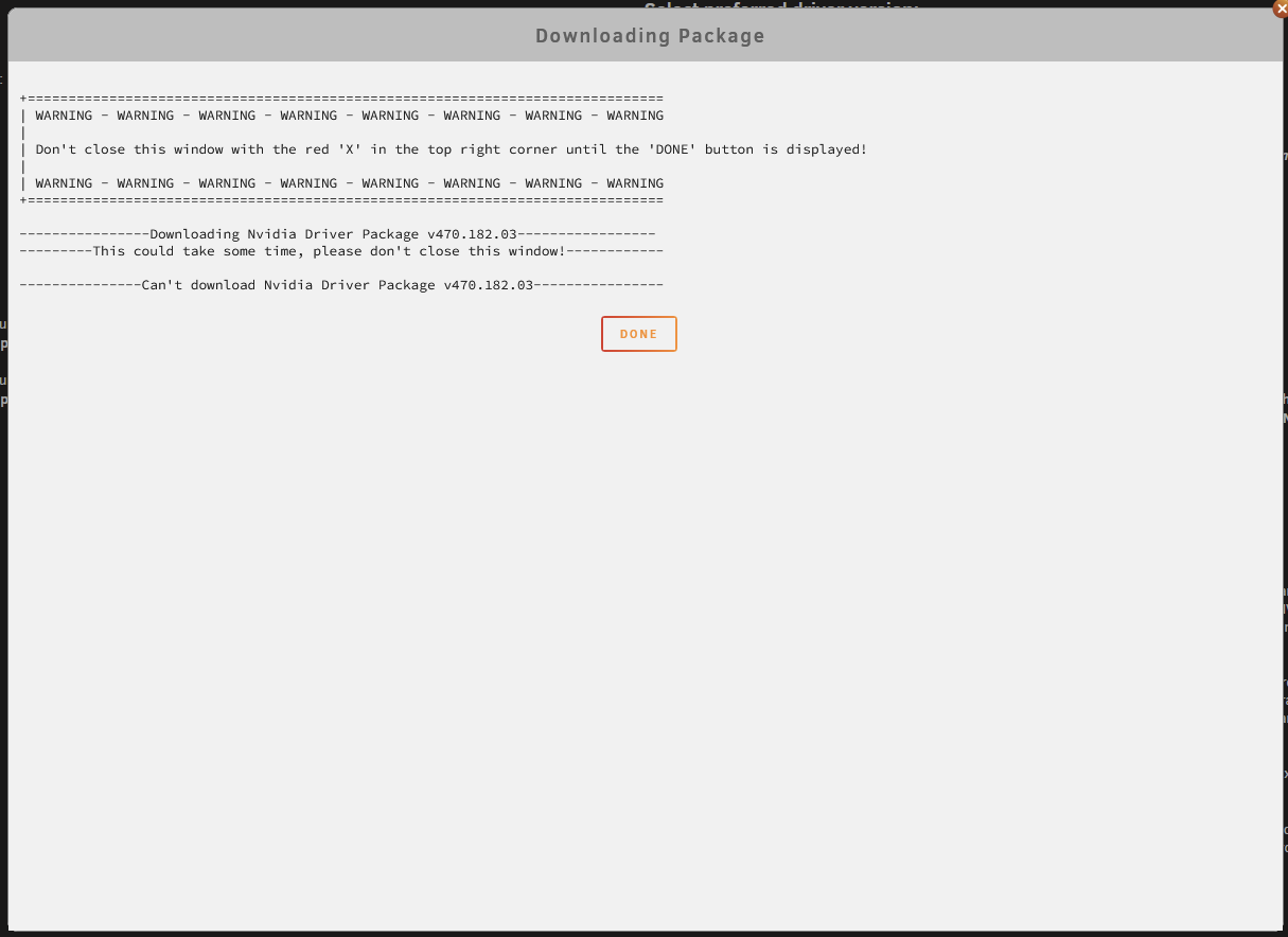

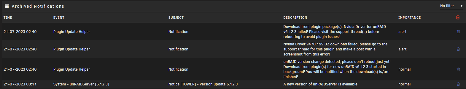

I've just downloaded the Unraid 6.12.3 update, which downloaded fine, but i'm getting an error from the Plugin Updater when it tries to update the Nvidia Plugin. Here's what I see in my Notifications:image.thumb.png.bf7771832a3ceeb1dace4b09de23fc5f.png
I've tried going into the Plugin manually and clicking "Update & Install" but even though I have the Production Branch v535.54.03 selected, it looks like it tries to install v470.182.03image.thumb.png.3eb8d42a3622cbf8f2cd75dffd2e5815.png
Do i just need to sit tight and wait for an update to the Plugin?
No.
Please do the following:
  1. Reboot
  2. Go to the plugin page and install the v470.x driver version
  3. Reboot again
After that it is working again.
What card are you using?
23 minutes ago, ich777 said:
No.
  1. Reboot
  3. Reboot again
Thanks for this!
While trying to complete step 2 i still got the "Can't download Nvidia Driver Package v470.x" error, but during the reboots it has updated the Driver to v535.86.05.
Just tried transcoding some videos in Plex and it seems to be working fine!
I'm using a GTX 1070.
Thanks for that thread, I'll have a read through that now! Thanks for your help :)

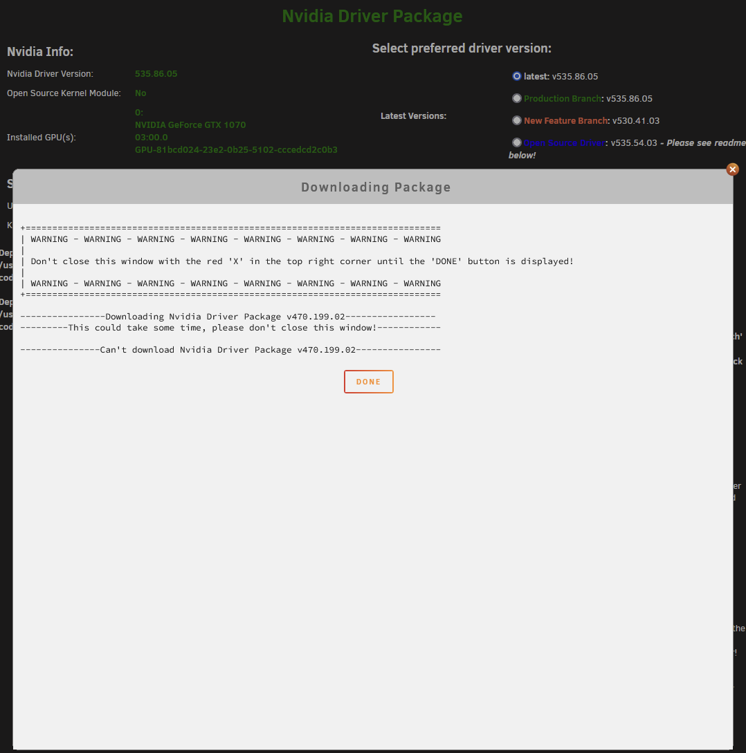

Why are you using the v470.x driver? You will be fine with the latest version anyways, you won't have this issue next time if you stay on any of the main branches from the "latest" section.
Please post your Diagnostics if you have any further issues.
Do you have pialert installed? They have a bug in their software which eats up all your GitHub API (which I make heavily use in my Plugins/Containers) and prevent the download.
Do you have any AdBlocking on your network? Please make sure that you don't block github.com and api.github.com

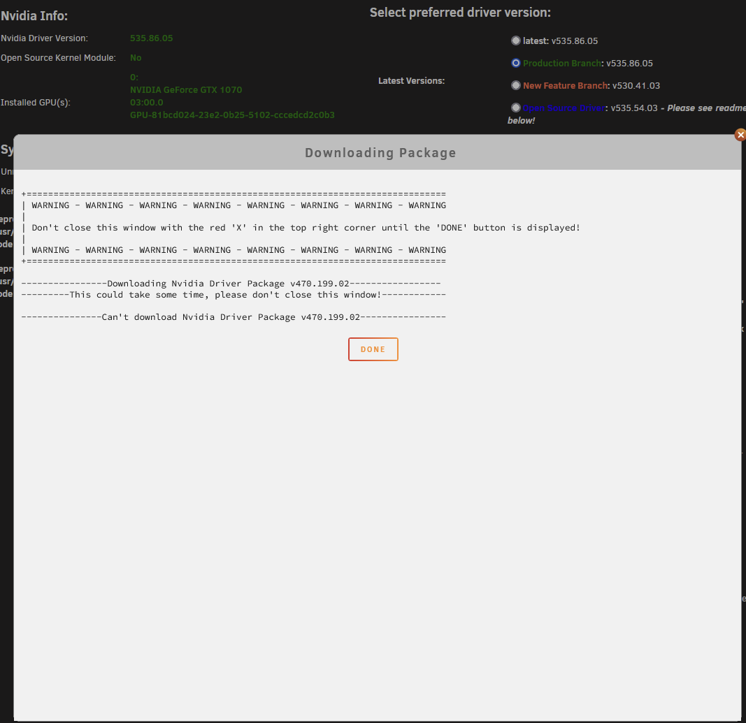

5 minutes ago, ich777 said:
Why are you using the v470.x driver? You will be fine with the latest version anyways, you won't have this issue on any of the main branches.
I'm not purposefully trying to use the v470.x driver, It seems like even if i select the Production or Latest release branch, when I click "Update & Download" the download window always shows it trying to download the v470.x driver?image.thumb.png.556ee3915a57c0829fe0c04ac8d5cba3.png
Even though that window shows it trying to download v470.x package, in the SystemLog it does look like it's calling the appropriate update commands:
cmd: /usr/local/emhttp/plugins/nvidia-driver/include/exec.sh update_version latest
cmd: /usr/local/emhttp/plugins/nvidia-driver/include/exec.sh update_version latest_prb
Please post your Diagnostics if you have any further issues. Do you have pialert installed? They have a bug in their software which eats up all your GitHub API (which I make heavily use in my Plugins/Containers) and prevent the download.
Sorry newbie error, diagnostics slipped my mind completely - I don't have PiAlert installed and there shouldn't be any adblocking/github API usage that I can think of, but I'll have more of a look and see what other containers/plugins could be causing a blocker.
Please uninstall the plugin and then reinstall it and see if that helps.
Thanks so much ich!
Re-installing the plugin fixed the issue!

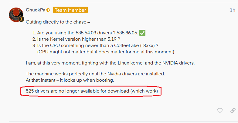

@ich777Hello! Long time no speak. I hope you are well and thank you so much for all your wonderful efforts for the Unraid community.
I'm chiming into this thread to see if there is a way to downgrade to Nvidia driver 525.60.13 as this is the only version that works with the current version of Plex on Linux/Unraid. Please have a look at this thread over here. My comments start at the bottom '2 months later' (Jase) with some logs.
https://forums.plex.tv/t/nvidia-hardware-acceleration-inconsistently-working-with-web-streaming/828463/149
The issue is that transcoding does not work with browsers when playing content from Plex. There are no problems however with Hardware client devices like the Apple TV, iOS etc. Any ideas on how to downgrade would be greatly appreciated.
Thank you!
Edited by Jase
Thank you!
That and the infoyou reported sound similar with what I posted
Please tell me this is a joke...
A few users lately reported this issue to me and I also think this was a common issue a few years ago right?
Will Plex fix this issue or not? My issue with that is that I currently have to compile 4 or some times even 5 drivers for each new Unraid version and I think you can see that this is time consuming, even if it's an automated process:
Sure thing, I have to recompile the old driver but I even don't know up to which Kernel version the 525 driver is supported but I also don't think that even that is true that only the v525.x drivers are working since the legacy driver v470.x also doesn't work (reported by a user).
Also, I read one of the comments from a Plex Team Member in the linked post:
Here are the drivers: https://www.nvidia.com/download/driverResults.aspx/204837/en-us/ :D
Did the Plex Team ever say why it is not working with the newer drivers? I really don't understand why it is a driver thing when it is working on native clients but not on the web client, this has to be an issue with their web client from my perspective and not with the driver, hope that also makes sense to you.
@alturismo have you heard of that yet?
I'm afraid not. Sorry ;(
I'm not aware of this as I have never seen this issue before.
It makes total sense for me. I totally agree that the issue is with the Plex Web client that needs to be fixed. It's really not that great that this issue has popped up. I think it will be a slow gradual process of other users complaining when they upgrade to the latest NVIDIA drivers.
I hope that the Plex Dev's will prioritize a fix rather than me and other users asking you to re-compile special drivers for their lack of bug fixes for Plex Server and their web clients on this issue....You should see the state of the Live TV DVR, now that's another conversation. ;)
