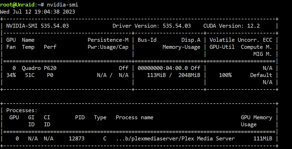

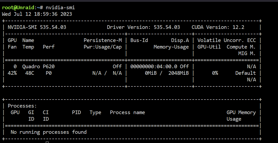

What happens when you stop the transcode? Can you post a screenshot from nvidia-smi if nothing is using the GPU please?
This is nvidia-smi without transcoding

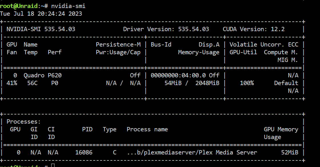

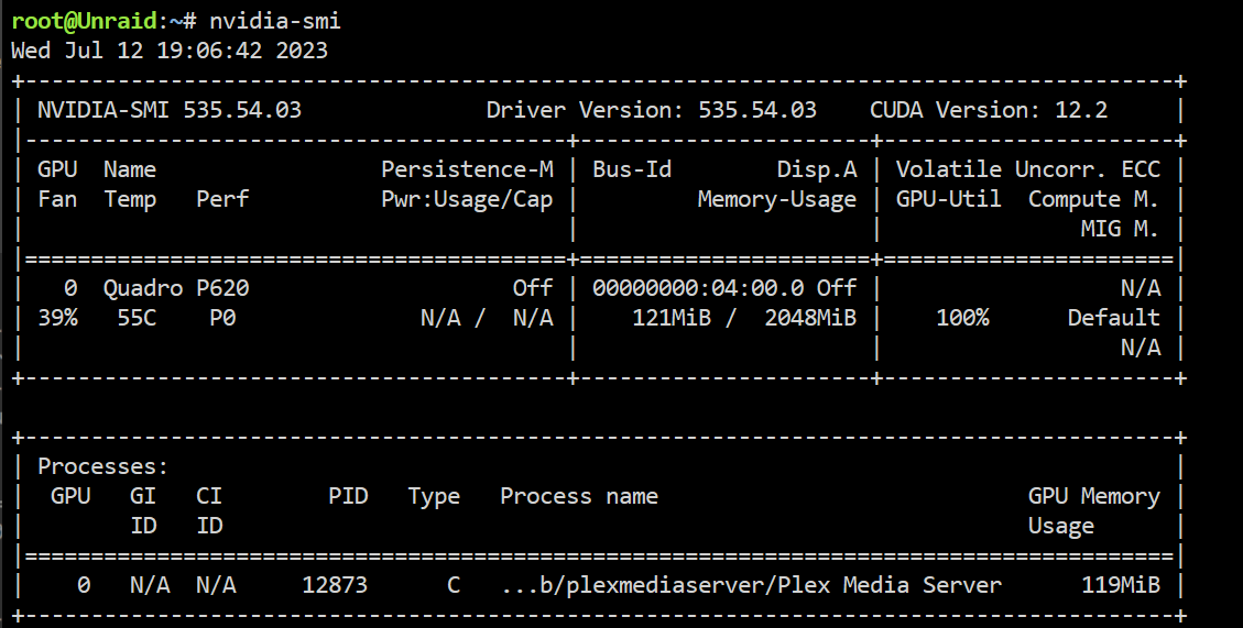

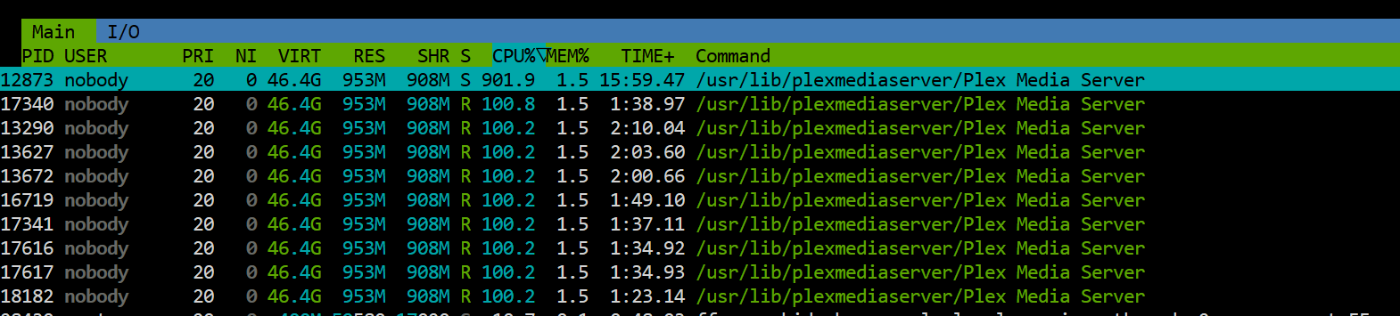

This is with plex trying to transcode.
Nvidia smi while transcoding
after I get the error plex becomes unstable"

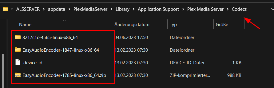

may try to delete the codecs dir from plex and restart the docker, also may try another browser to test playback (or a native client and force transcoding like mentioned from @ich777)

I have stopped plex delete the codec folder, started plex and still the same issue

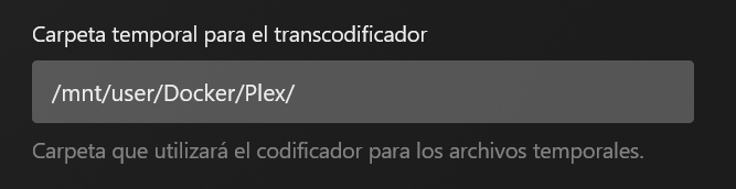

On 7/10/2023 at 8:43 PM, L0rdRaiden said:
  --mount type=tmpfs,destination=/tmp,tmpfs-size=4000000000 'lscr.io/linuxserver/plex'
1 hour ago, alturismo said:
is not relevant while you use a tempfs ramdisk, which i assume you are using as transcoding path
I remove the path and used as well this patch which is an ssd but the same error appears
Anyway if I do CPU transcoding it works with the /tmp and ramdisk

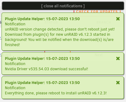

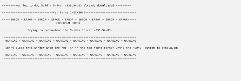

I just updated to 6.12.3 and got an error, attached, that the plugin failed to download.
Not sure what to do next but the notifications said to post a screenshot here!

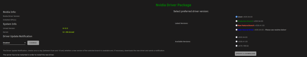

Current version is 535.54.03.
The plugin screen doesn't actually show a newer version. Perhaps I have got confused and there isn't one to upgrade to!

Unraid is v6.11.5. Unraid is now prompting me to reboot to finish the update but the notifications above are saying don't do it because of plugin download error.
Please give ma about 5 minutes, I'll post a command shortly that you have to execute from a Unraid Terminal that will ensure that the packages are download properly for the new Unraid version.

Oh no, I just got notified it failed again.
There is something really strange going on on your system, do you use any AdBlocking on your network, does the server have full access to the Internet and are you sure that you don't block access to the GitHub API?

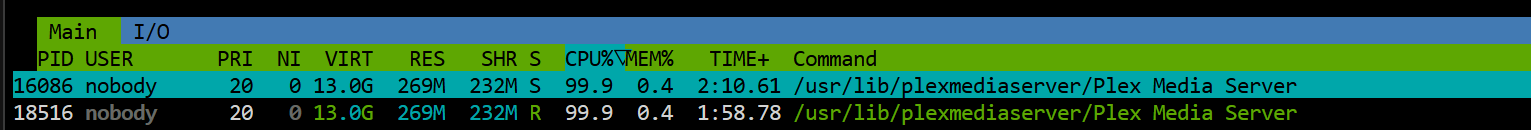

The "good" news is that I can transcode full hd content with GPU and it works, although plex might become a little bit unresposive
Even 5 or 7 minutes after I stop the trancoding GPO and or CPU are with a high consuption for no reason
With 4k content I get the error reported before... it's very strange. I'm using now 6.12.3
