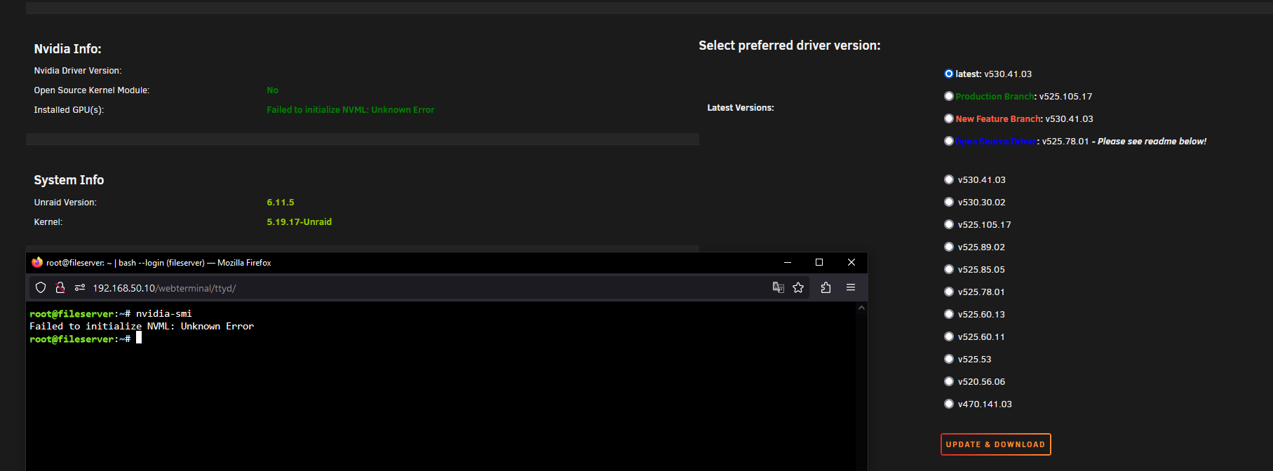

Having an issue where the plugin (and console) reports "Failed to initialize NVML: Unknown Error" after the plugin is initialized. If I run "nvidia-smi" prior to opening the plugin page, I do get an output. After opening the plugin page, I only receive that error.
I've attached an image of the console/plugin page as well as my diagnostics file. This is a ProLiant ML150 Gen9 with a GTX 1080 inside of it.
Thanks!
fileserver-diagnostics-20230423-1350.zip
Can you try to boot with Legacy Mode (CSM) and see if that makes a difference? I see nothing obvious.

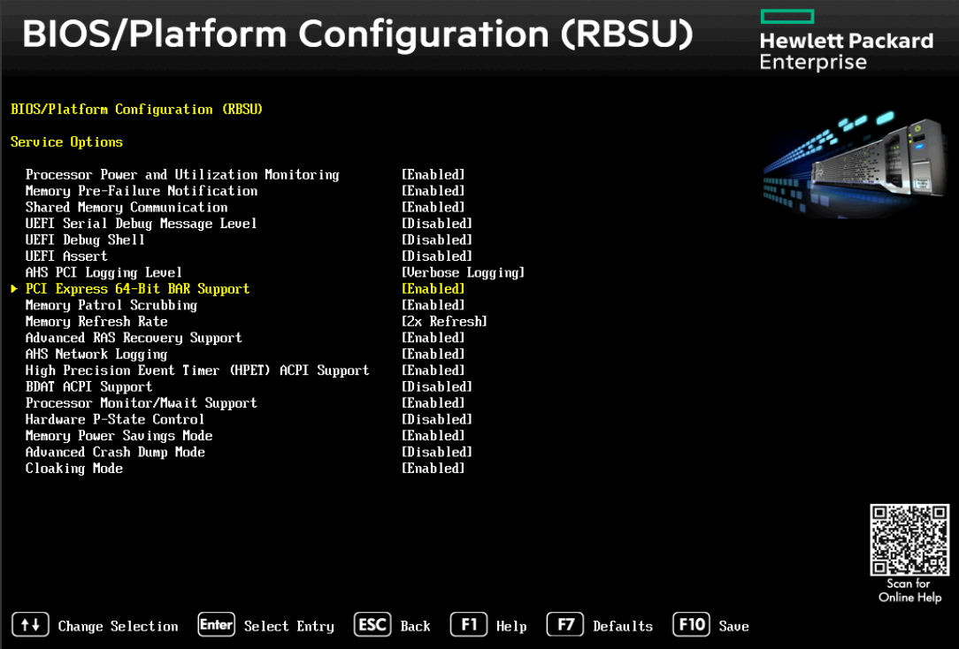

So I enabled legacy mode and PCI Express 64-bit BAR support was already enabled. If anyone else reads this and wants to know where to find it, you have to hit CTRL+A while in the RSBU to open a secret "Service Options" menu. Still had the same problem, unfortunately. I know this server/GPU configuration works though as I've previously used it on a baremetal Ubuntu Server install on the same machine.

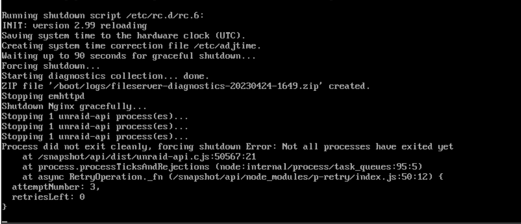

Booting into GUI mode produced no video output from the GPU, however I was able to monitor progress via iLO. After loading SMB, it get stuck on a flashing cursor. The webpage does still work via a browser. I logged in, checked the plugin, and saw that it was displaying a GPU ID and that nvidia-smi was working still. However, seconds following this, the web UI became completely non-functional and refused to load pages. I tried to perform a graceful reboot via iLO but it errored out (attached a screenshot of it). It hung here for several minutes before I had to forcibly reboot the system.

6 hours ago, ocean_breeze said:
Two things to note: This is a fresh unRAID install (less than a week old) and switching to legacy 470.XX drivers resulted in the same issue.
Wait, I completely missed that you've bound the card to VFIO or at least it seems that it's bound to VFIO but I didn't see any indication in the logs that the system itself bound it to VFIO, did you maybe do that manually? :

Taking a deeper look into it from what I can see you bind the card in your OPNSense VM (why?) :
-device '{"driver":"vfio-pci","host":"0000:09:00.0","id":"hostdev0","bus":"pci.4","addr":"0x0"}'
It shouldn't be bound there at all. But you're right, it was. I've removed that and nvidia-smi as well as the plugin page are both working now. No clue how it got bound.
Thank you so much!
Edited by ocean_breeze
Please be sure to never use one card for a VM and also in docker containers (your server will hard lock if it's used in a VM and then something want's to use it in a Container).

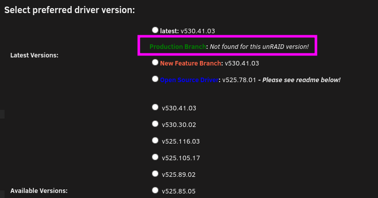

Seeing this notification lately:
Production Branch: Not found for this unRAID version!
Can you please share a bit more information?
If possible please post your Diagnostics.
59 minutes ago, ich777 said:
Latest Production Branch version is 525.116.03
I will take a look into that but please give me a few days.
No stress, take your time.
I am currently on:
525.105.17
