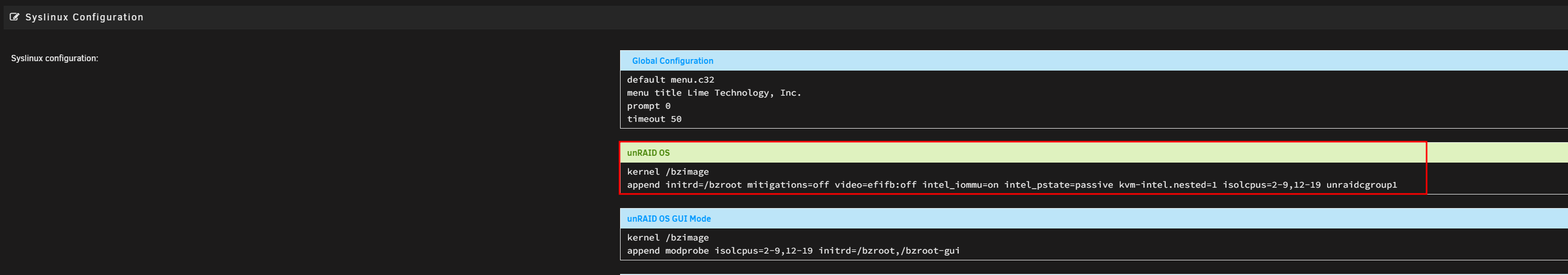

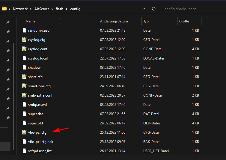

How would i delete the bind?
remove the entry in here (open the file and clean it)
and may take another look here if you have a manual syslinux entry ...
if there is something here ...
Okay, did that, but would that really be the reason for the 500 internal server error?
Also, just to clarify, I have uninstalled the app, rebooted, reinstalled the app, and rebooted again and i haven't had the error since, so maybe it was just a weird thing. but i was just curious if there was anything in the diagnostic that was alarming.
