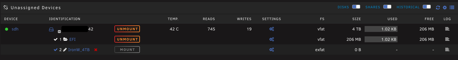

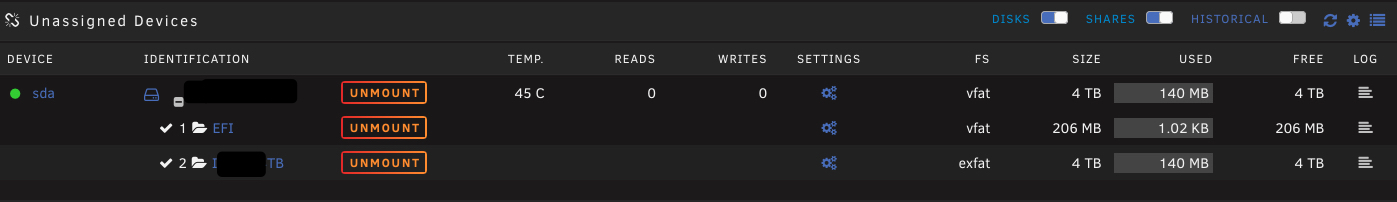

I recently unplugged USB cable from external HDD being mounted to UNRAID server via "Unassigned Devices". After I reattached the drive, the drive won't mount correctly. Attached pics show how this looks along with logs. Specific error message states: "Tower unassigned.devices: Mount of '/dev/sdh2' failed. Error message: FUSE exfat 1.3.0 WARN: volume was not unmounted cleanly. fuse: mountpoint is not empty fuse: if you are sure this is safe, use the 'nonempty' mount option" I note recommendation to run "fsck" command. https://wiki.unraid.net/Check_Disk_Filesystems does not show how this command is used for exFAT formatted systems. Assuming that I'm using UNRAID terminal, what is the syntax for "fsck" command. I'd like to make sure that fsck is only run against that specific drive (and not my array drives), and I'd also appreciate to know where in directory structure within UNRAID terminal window do I need to be positioned when executing fsck cmmand. Namely, in UNRAID terminal this drive has following directory aisgnments: /dev/sdh and /mnt/disks/ Do I need to unmount the drive, then navigate to /dev/ and execute fsck against sdh? Suggestions?

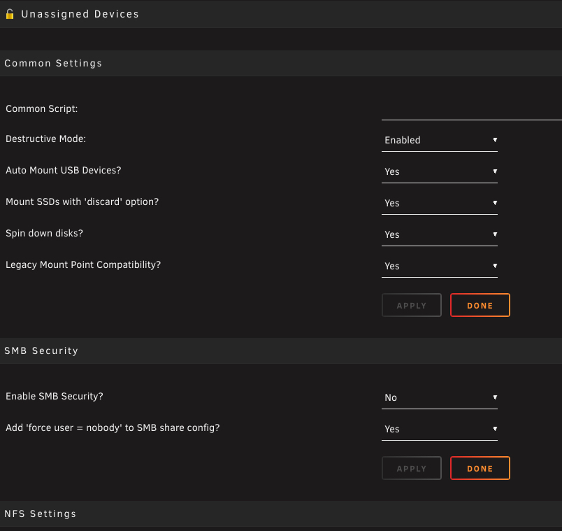

That's fine, but Ext HDD/USB sticks will still be mounted as mnt/disks (Read Only option disabled) with exFAT formatted (yes, UA AND UA plus are installed). Is this on purpose? When USB-attached devices (USB stick, ext HDD) are mounted, then no files can be written to such external stores, eventhough permissions are set to rwx . Also, cannot format disk any longer. Switching to legacy support does not solve the problem. Previous plugins did not have this issue. What is solution for that issue? Btw, the SMB mounted shares work just fine, and yes they are mounted as mnt/remotes.

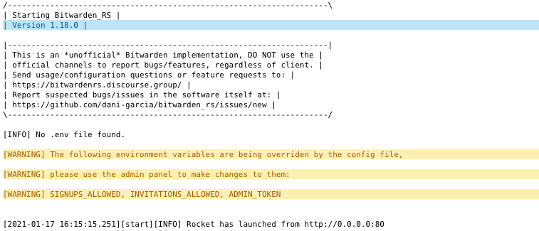

[support] Vaultwarden (formerly Bitwarden_rs)
Hi. Letsencrypt (the docker) is used as a reverse proxy. Thus, when Bitwarden is invoked from outside of local network and via my subdomain bitwarden.mydomain.com, the request is routed to my letsencrypt (reverse proxy), which then routes rwuest to Bitwarden docker app. I am able to upload any attachment to Bitwarden (regardless whether I am local or on the go). I can see encrypted attachments in UNRAID->appdata->bitwarden->attachments (folder). However, whenever I use client on iOS/iPad or a browser plugin (any browser), or standalone OSX app, I simply cannot download/view that attachment. I reviewed the log from Docker->Bitwarden...It doesn't show any error messages, not even a request to access the attachment. Does that help?
