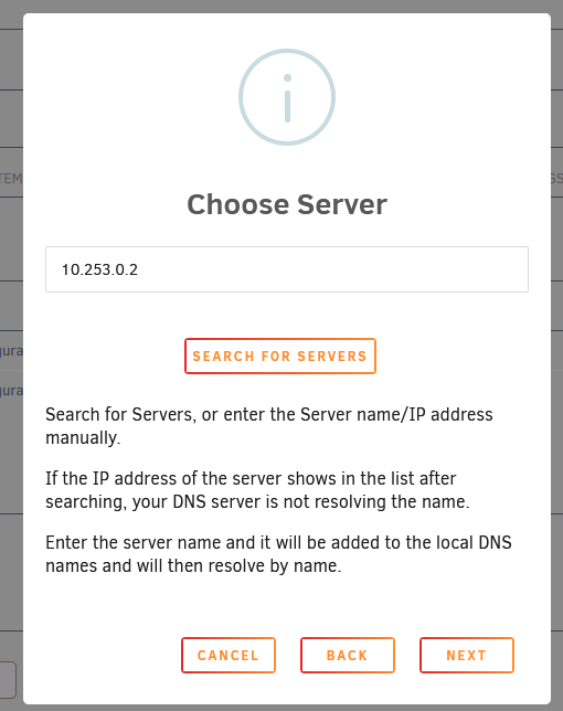

  13. Probably related to (new MiscUD)->is_ip($server)) determining what is an IP and what is a hostname?
  14. Call me curious, I don't follow what you mean with local host confusing UD? If I enter in 10.253.0.2 and it outputs into samba_mount.cfg without periods what portion of my system would cause the lack of periods in an IP?
  15. You can't because the dialog for adding a host is removing / not passing periods from the entered IP. old vs new
  16. The new update isn't processing periods in a host? and all existing configurations are invalid?
