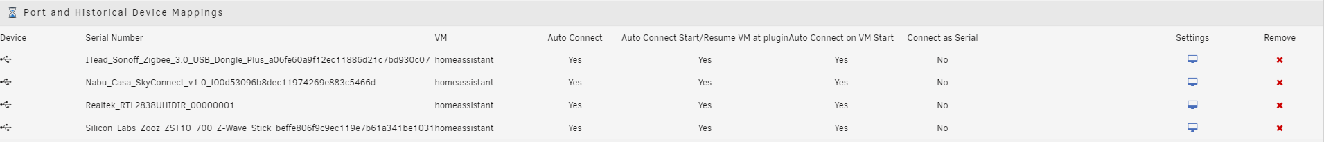

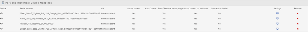

  14. Assuming I did this right, this is what I get: root@DataServer:~# /usr/local/emhttp/plugins/usb_manager/scripts/rc.usb_manager vm_action "homeassistant" prepare no pools available root@DataServer:~# I also tried this: root@DataServer:~# /usr/local/emhttp/plugins/usb_manager/scripts/rc.usb_manager vm_action homeassistant prepare no pools available root@DataServer:~#
  15. I am able to attach to the usb.ini file and see it's content. I may just delete the connections in USB Manager and recreate them and see if this works next time the VM Backup runs. That will be this Saturday May, 8th. I will let you know if that works then........ Thanks so much for all your help!
