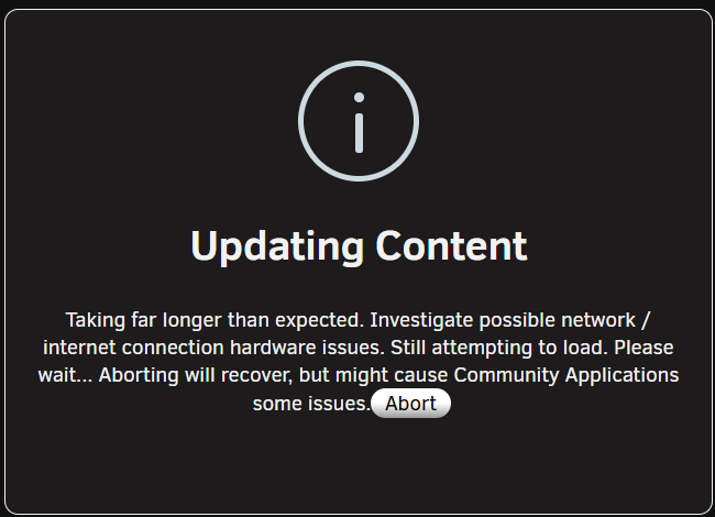

Unraid Connect plugin dramatically slowing webgui performance
I too am having it when accessing from Chrome on Windows 11. I have Unraid Connect 2025.09.18.1707
Looks like its back up and working now!
Me too! I was going crazy thinking I messed something up on my end lmao.

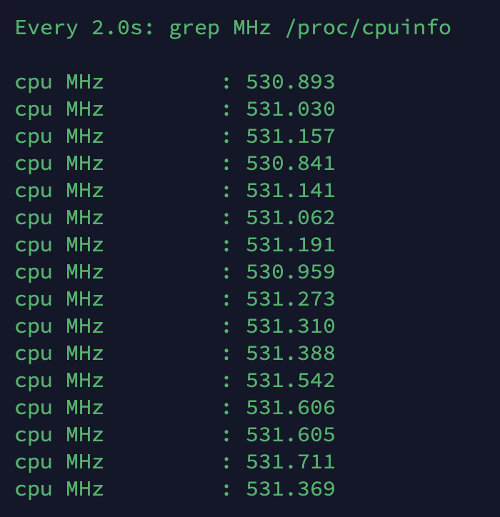

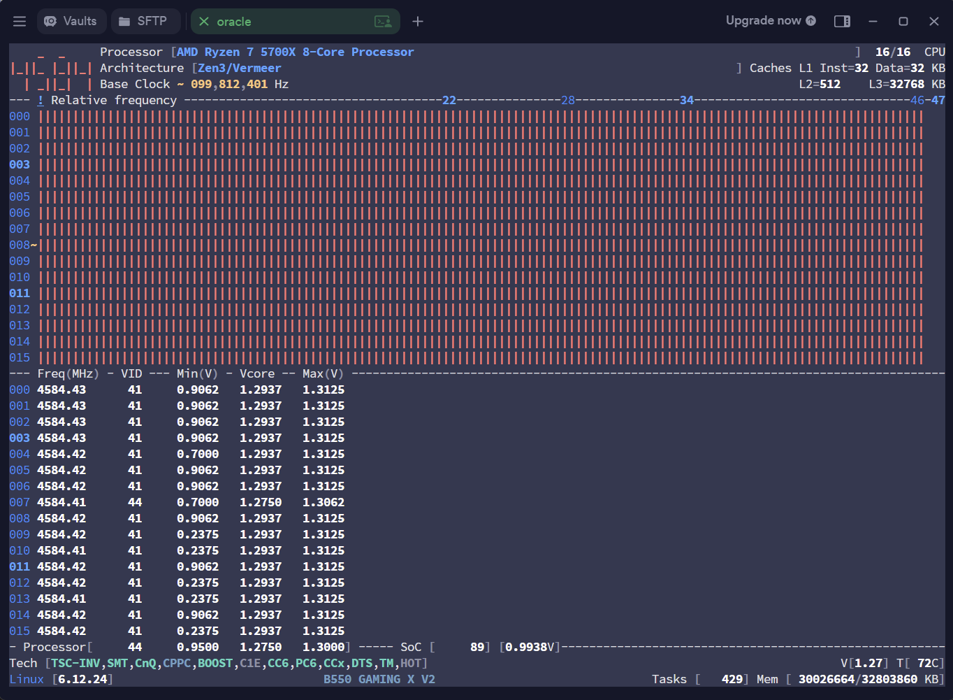

SOLVED! After swapping my PSU first, then my CPU, and then finally my Motherboard, I found out the issue was a faulty motherboard with poor VRMs not able to deliver enough voltage to the CPU. My CPU would not boost past 550Mhz. I went from a B450 MSI motherboard to a B550 Gigabyte one. I was only able to find this out thanks to @JorgeB 's suggestion. I also greatly appreciate @bagican for inspiring some of the ideas that led to the solution. I truly greatly appreciate both of your help and you are the reason why I already feel so welcome in the Unraid community. This was my first ever non Windows build ever (I have no professional experience in IT, I'm in the medical field) so a lot of this was completely brand new to me. My new system feels incredibly snappy now and I am so very grateful. Here is my system fully stress tested. I used the command corefreq-cli (must download the plugin from the store first) to output this. As you can see my AMD 5700X now properly boosts up to 4600MHz with the proper voltage applied (1.30V instead of the measly 0.91V I used to get).

The values ranged from 530 to 550 at the highest when I stopped the docker service and then started it

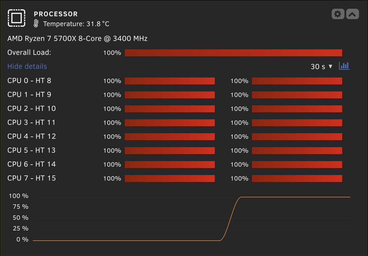

Bumping this up. I can see a stark performance contrast between my docker containers running on Unraid vs Docker Desktop on Windows 11. That should not be happening haha. I'm gonna look in the BIOS later tonight and will post here if I find anything that may be related.
