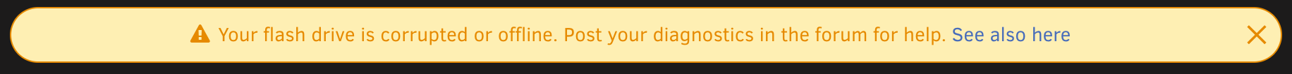

  8. Rebooted after removing network.cfg. Server now responds to both IP and .local addresses. Shortly after logging in (hadn't even started the array), I got this warning: Oh bother. Flash drive is actually a Micro SD card on Kingston card reader (USB3.0) Did manage to get a diagsnostic download, though. I think I'm gonna try and migrate to a USB2.0 flash drive (actual thumb drive, Kingston DataTraveler) Edit: Removed card reader and MicroSD and ran a disk check which found no errors. Moved the card reader to another USB port (USB2.0 this time) and seems to be well now. hesiod-diagnostics-20240921-2321.zip

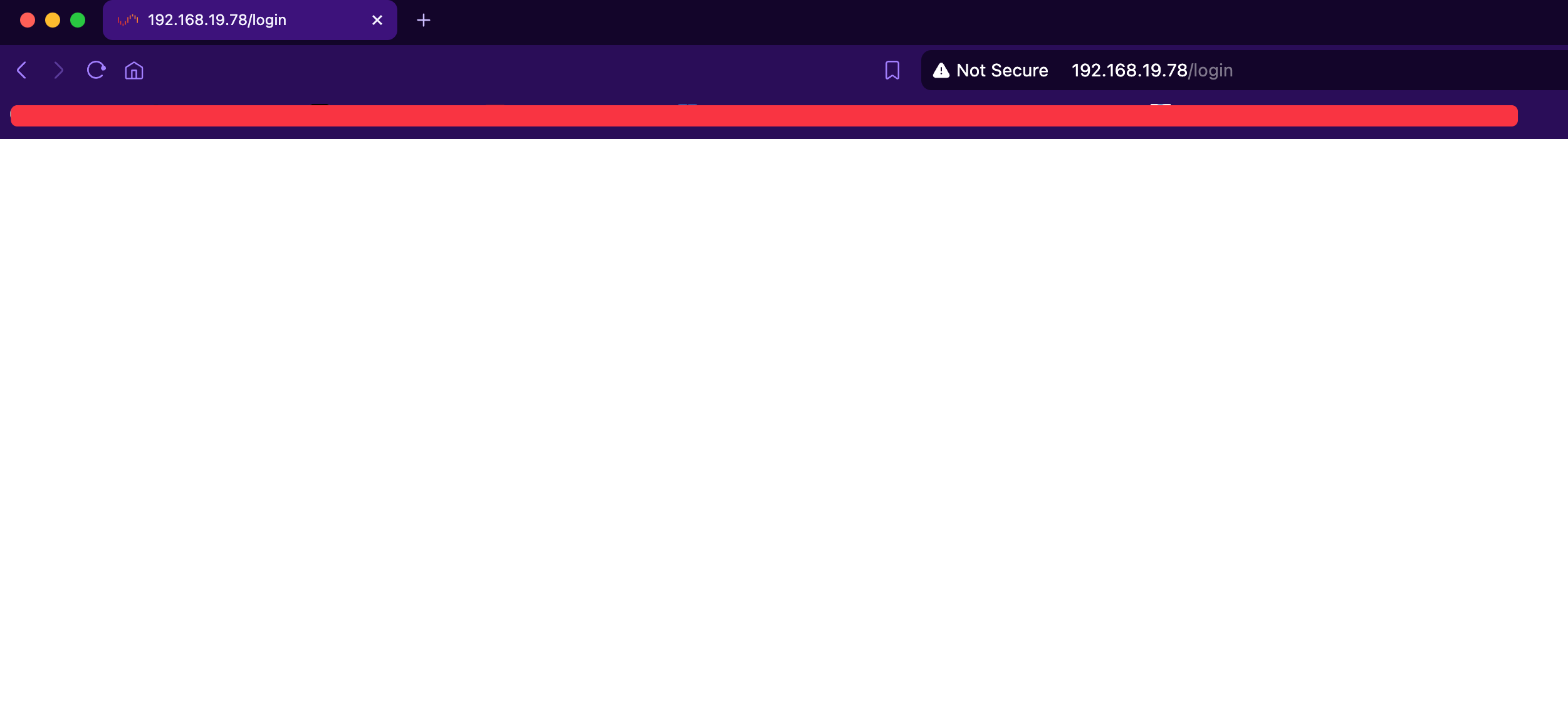

  9. Didn't even get around to this :-/ I did run Parity build last night, so that's done. Installed Dynamix File Plugin earlier today (before reading your answer) and set it to move some files around. Came back and the WebUI was not responding on .local either. Weirdly enough, it now responds on IP but no useable GUI: Server responds to ping, but is not serving shares. Since I haven't enabled SSH, I'm just gonna have to power down and restart :-( Will remove network.cfg before restarting

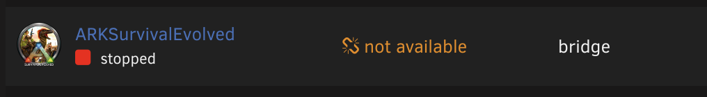

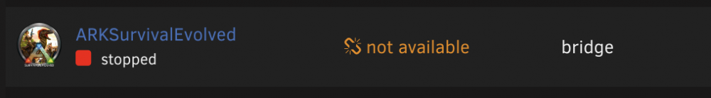

  13. Went into the advanced settings and tweaked a password setting to trigger an update. It re-did the container, but still shows up with no version number. Strange.
  14. Umm... huh? Version not available?

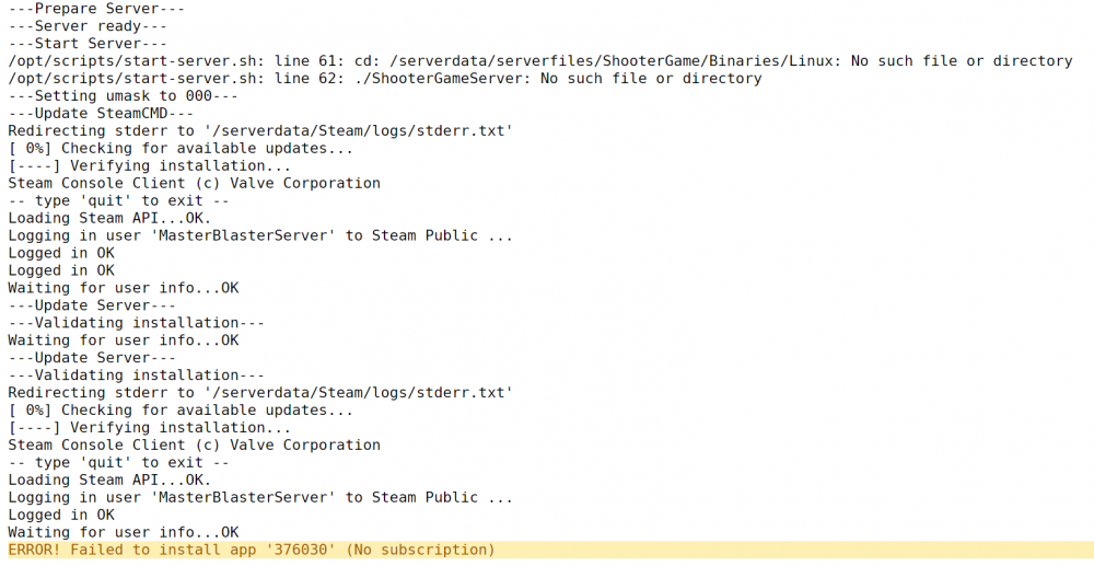

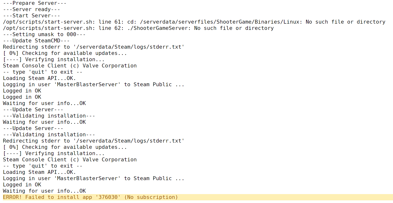

  21. Thanks! That progressed thing a little further 🙂 Everything seems to start up fine but I get this error message in the end: [S_API FAIL] SteamAPI_Init() failed; SteamAPI_IsSteamRunning() failed. EDIT: Looking back in the thread, I can see that this is apparently only a warning because SteamCMD is not running. I'll try to muck about with it and see if I can find the server in the browser in-game.
  22. I'm trying to get an Ark:SE server running. However, seems to not work as expected. I have went with the settings in the Docker template (standard ports etc, no custom configs). SteamCMD folder seems populated but ark-se folder is not, as per the log indication. Not really sure what to change? Might I just be experiencing connection trouble with Steam?
