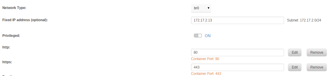

I am in my first steps trying to setup reverse proxy. I have a domainname, static IP and I want to use this container. I am having trouble with port forwarding it seems. As I get the error ERROR: Cert does not exist! Please see the validation error above. The issue may be due to incorrect dns or port forwarding settings. Please fix your settings and recreate the container First question I want out of the way: In the domain config (I use https://controlpanel.tech/), should the destination url be http://[public-ip] or https://[public-ip]? In my setup, unRaid uses port 80 on 172.17.2.3. so I have the letsencrypt docker specified to ip 172.17.2.13 in the docker: Thus, on my router I have forwarded ports 80 and 443 to 172.17.2.13. I am trying to get started with a minimal nginx.conf file, so it looks like this right now (with my domain redacted): #upstream backend { # server 172.17.2.13:19999; # keepalive 64; #} server { listen 443 ssl; listen 80; return 301 https://$host$request_uri; server_name domain.tech; ssl_certificate /config/keys/letsencrypt/fullchain.pem; ssl_certificate_key /config/keys/letsencrypt/privkey.pem; #ssl_trusted_certificate /config/keys/letsencrypt/chain.pem;# #ssl_session_timeout 1d;# #ssl_session_cache shared:SSL:50m;# #ssl_session_tickets off;# #add_header Strict-Transport-Security max-age=15768000;# #ssl_stapling on;# #ssl_stapling_verify on;# ssl_dhparam /config/nginx/dhparams.pem; ssl_ciphers 'ECDHE-RSA-AES128-GCM-SHA256:ECDHE-ECDSA-AES128-GCM-SHA256:ECDHE-RSA-AES256-GCM-SHA384:ECDHE-ECDSA-AES256-GCM-SHA384:DHE-RSA-AES128-GCM-SHA256:DHE-DSS-AES128-GCM-SHA256:kEDH+AESGCM:ECDHE-RSA-AES128-SHA256:ECDHE-ECDSA-AES128-SHA256:ECDHE-RSA-AES128-SHA:ECDHE-ECDSA-AES128-SHA:ECDHE-RSA-AES256-SHA384:ECDHE-ECDSA-AES256-SHA384:ECDHE-RSA-AES256-SHA:ECDHE-ECDSA-AES256-SHA:DHE-RSA-AES128-SHA256:DHE-RSA-AES128-SHA:DHE-DSS-AES128-SHA256:DHE-RSA-AES256-SHA256:DHE-DSS-AES256-SHA:DHE-RSA-AES256-SHA:AES128-GCM-SHA256:AES256-GCM-SHA384:AES128-SHA256:AES256-SHA256:AES128-SHA:AES256-SHA:AES:CAMELLIA:DES-CBC3-SHA:!aNULL:!eNULL:!EXPORT:!DES:!RC4:!MD5:!PSK:!aECDH:!EDH-DSS-DES-CBC3-SHA:!EDH-RSA-DES-CBC3-SHA:!KRB5-DES-CBC3-SHA'; ssl_prefer_server_ciphers on; client_max_body_size 0; location / { root /config/www; index index.html index.htm index.php; } #location /glances { # include /config/nginx/proxy.conf; # proxy_pass http://172.17.2.3:61208/; #} } Help to get this working would be greatly appreciated!
