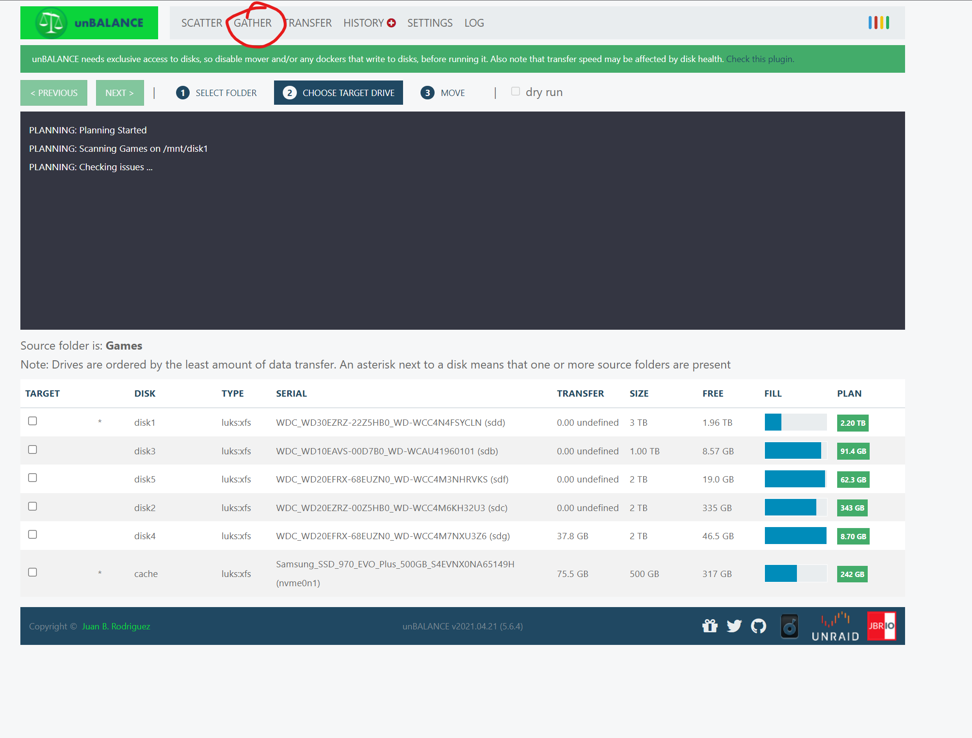

Use the unBALANCE plugin. Once you have consolidated the games, you will also want to ensure that your games share is limited to a single disk on your array. As I said, I personally have not seen this issue on my games library. So my library is scattered across a number of disks and my cache drive and it works fine. So this should only be required for people who do run into issues. You could look at specifying a separate library for those games that is a volume mounted directly from one of the disks.
@ich777 was just telling me that apparently some games do not like some of the magic that exists in our Linux file systems and one possibly solution is to use a direct path to the disk rather than the array. Eg: Instead of `/mnt/user/games/` use `/mnt/diskX/games/` I see that a few people have run into that XFS error. I have been unable to reproduce it on my Steam library. But if someone here is seeing that, perhaps you could give this suggestion by ich777 a shot and report back??

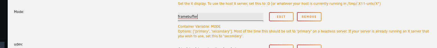

The latest build has the ability to be run in a simple framebuffer. To enable this, update the Mode to say "framebuffer". Obviously this mode will be useless for playing games, but it will work fine for downloading and updating games. Make sure you pull the latest docker image.
